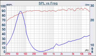

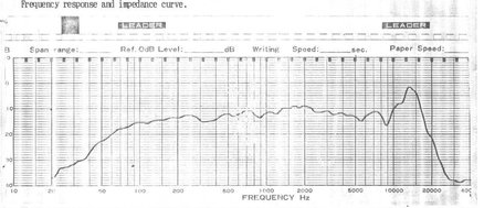

Is this as good as it gets in 4 " Full range ?
Is this as good as it gets in 4" Full range ?
I am looking for the best for closed box
Has an EBP of 94 only 4 points from being suited for both closed box or bass reflex although the Xmax seems high for a sealed box at 4.3mm one way.
an Fs of 65.40 and Qes of 0.69 and Vas of 5.17 ltrs
The curve on this looks honest and incredible and it is only 36.00
If you or someone you know has used this driver in a closed box setup sure would like to hear a quick review
Is it just me or does that cone color look Ugly ?

Your images are kind of small to see but I can barely make out that you are referring to the MA CHR-70, certainly a very well liked driver around here and appears to be a great value. It has a more expensive brother called the Alpair 7 that many people like too. If you are going to use it sealed, you won't get to experience the low bass extension it is capable of, but that is fine for use with a helper woofer. When you say is this as good as it gets, just make sure you are aware that some folks object to the peak at 12 kHz which can vary by 20 dB over the different angles of off axis listening. The data is presented from -10dB to +110dB a rather large scale that visually flattens a response. Most people agree that this is a great sounding driver and is very versatile for use in BR or TL alignments. If you are looking for a flat response from a driver for a sealed box with circa 85 dB efficiency, take a look at the Vifa TC9FD. It costs a lot less but the smoothness and low harmonic distortion are among the best of a driver at any price in the 3 to 4 inch range. Here is the response of the TC9FD in a sealed spiral TL cabinet:

Depends what you mean by 'good as it gets' since that varies with opinion, requirements and personal taste. All drive units are different. The Mark Audio units are however, very good examples of what they are.
The CHR linked to is their entry-level metal-cone model in the 4in size bracket (Alpair 7 is the range-topper) -you can get it in an off-gold colour if you don't like the grey.
The graphs are honest for what they are; there's no software smoothing applied, but the vertical / dynamic scale is larger than you'd usually get with a midbass or tweeter (providing a similar effect) -this is normal practice for wideband driver unit manufacturers.
Re EBP, don't pay much attention to it. It's at best a very simplistic 1st pass approximation. The CHR does fine in both sealed and vented boxes however.
TB do make some very nice drive units, but their published data is generally 'optimistic.' 😉
As for deviations from a flat response: right. All widebanders do. No exceptions. Theoretically, the smaller ones should (should) have the least, assuming a flat response was targeted in the first place & the design & manufacturing are competent. As you go larger, it becomes progressively more difficult to do it. Wideband drive units rely on controlled resonance to produce the high frequencies. That's not easy (classic understatement there), especially with a large cone. And you get variations even in the same size bracket.
Take, for e.g., the Vifa TC9 referred to above by X. This is about the flattest in terms of FR that you can get from a widebander (and very impressive it is too). The Mark Audio Alpair 6P is in the same size bracket, and is also good, albeit not quite as linear in response terms. They have exactly the same Sd (36.3cm^2). Vifa doing a better job? Depends. Because they're not the same. Compare Mms and Xmax for a moment:
TC9 is a featherweight 2.6g and has 2.55mm Xmax.
A6P is even lighter at 2.32g, but has a much longer coil & suspension travel: Xmax is 10mm. It's also a little more efficient, translating into an extra 1.5dB sensitivity or so in practice, along with the greater LF extension &c.
So something has to give. The TC9 is a more highly damped design, & less micro-resonant sensitive than the 6P. This provides that very linear FR & impressive distortion performance, but 'detail' (I don't like the term, but you get the idea) is somewhat less. Horses for courses and no reflection on either unit -they are what they are and the options are there for people to select what suits their needs best. Amongst many others -I used these as a quick example because I had the data to hand & they share the same Sd.

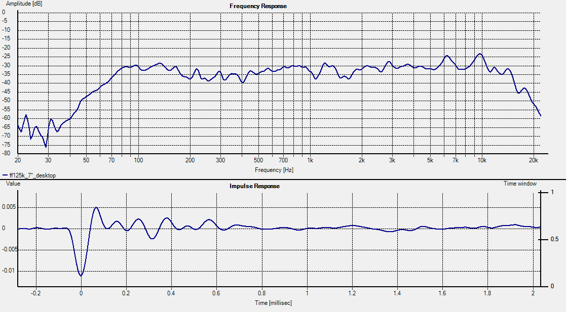

I was quite surprised yesterday to do a T/S run on a single FF85WK, well broken-in by now. It's about the closest I ever came to factory spec. Measured at ~2V:

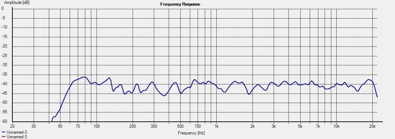

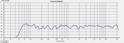

Ok, not quite a 4" driver. Here's TB W4-1320SIF, near-field on-axis:
I'd call that flat. It does lose the topmost HF to beaming pretty fast, if you move off-axis.
Frequency response is not everything, but it's always nice if it turns out pretty, all else being the same - which it rarely is, but that's another story. 🙂

with a curve like that did you have an idea just how good it was while listening to it, because you seemed surprised at the test result , that is why I ask.
I was surprised at the T/S parameters of FF85WK, but this SPL trace is TB W4-1320SIF.
As for the initial "listening to that curve", it certainly was very different from the previous speaker's (FF125K in small mis-tuned reflex) midrange-forward presentation, but I could feel greater balance for sure.
I've ameliorated the FF125K since and have been listening to that one lately (my current avatar):
Not as even as the TB, but as said, frequency-domain response is far from everything. I like the Fostex better overall, with more detail and significantly more sensitivity.

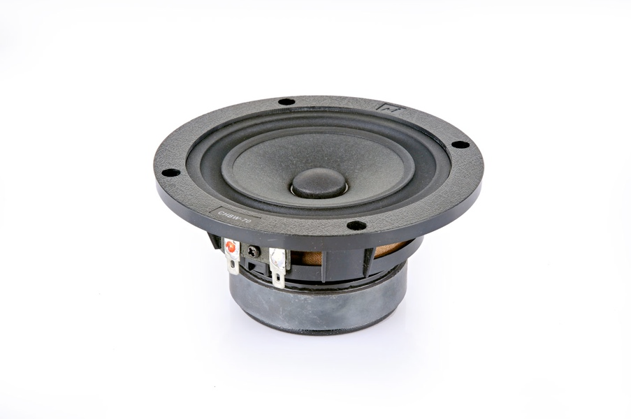

Yet another real possibility and it is a normal color
CHBW-70 1st Generation Wide Range Audio Driver, 4", Black paper cone.
Imp - 8 Ohm
Fs - 66Hz
Qts - .49
Vas - 4.6L
SPL - 84.8dB
Xmax - 2mm
Qes - 0.69
This one looks like a real good one EBP of 96 so could use as sealed box unit.
