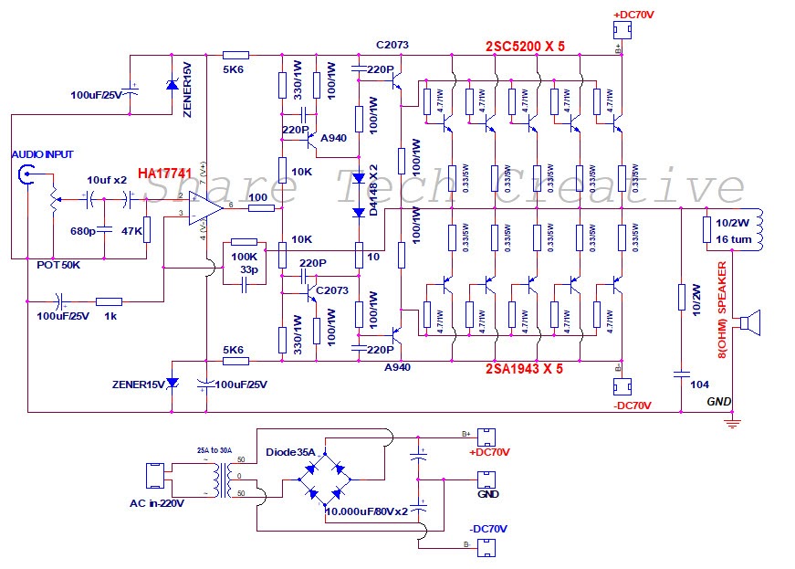

hi guys
this indian chap on youtube posted a video and schematic of this amp, claiming 1000W. i noticed a lack of large power capacitors.
what do you think ???

Also the HA17741 is a laughable 2nd generation Hitachi op amp. 1 v/usec slew rate, likely to miss all the highs. No noise spec, likely to hiss like a boiler. For living examples, consider the first generation Peavey CS800 from 1980?. SC5278 op amp was really a LM355 or 741. Hissy, suitable for low frequency guitar source only very loud. Repair shops used these as door stops. By contrast a CS800x with NJM4560 or 4580 op amps is quite good sounding in hi-fi service.

Yeah, this seems inspired by a rather old design... nobody uses a 741 any more these days. Expect 40-ish nV/√(Hz). More recent designs have employed the likes of LM318, NE5534, µPC4570 or NJM4580.
The 50k pot and 680p input capacitance is perhaps not the most advantageous combination ... lacking some series R as well.
Even for a 250-300 Wpc amplifier, a gain of 40 dB seems like rather a lot. I don't think an input sensitivity of <500 mV is required for a power amp, even the pro audio guys will generally be shooting for 0 dBu (0.775 mV) only.
