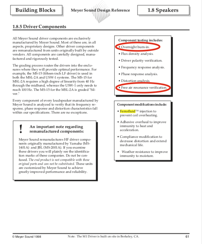

Usually the manufacturer lists the use of ferrofluid in their drivers, though in the 291 page Meyer Sound Design Reference manual there was only one mention.I don't have any experience with ferrofuild in a driver. Pretty sure the ST-815 doesn't have it, but how do you tell?
Everything seems to be falling in place as the driver is breaking in...
Burn-in and resonance verification were on the same page 😉 :
Long term, kerosene based ferrofluid thickens up as the volatile hydrocarbons evaporate. Thicker ferrofluid has more damping, which could affect the impedance.
I mentioned it because of my recollection when early Meyer MSL3 systems using ferrofluid were brought in from the cold in Minnesota, engineers would run them near full tilt for a long time before tuning them, as the response changed quite a bit as the oil heated up.

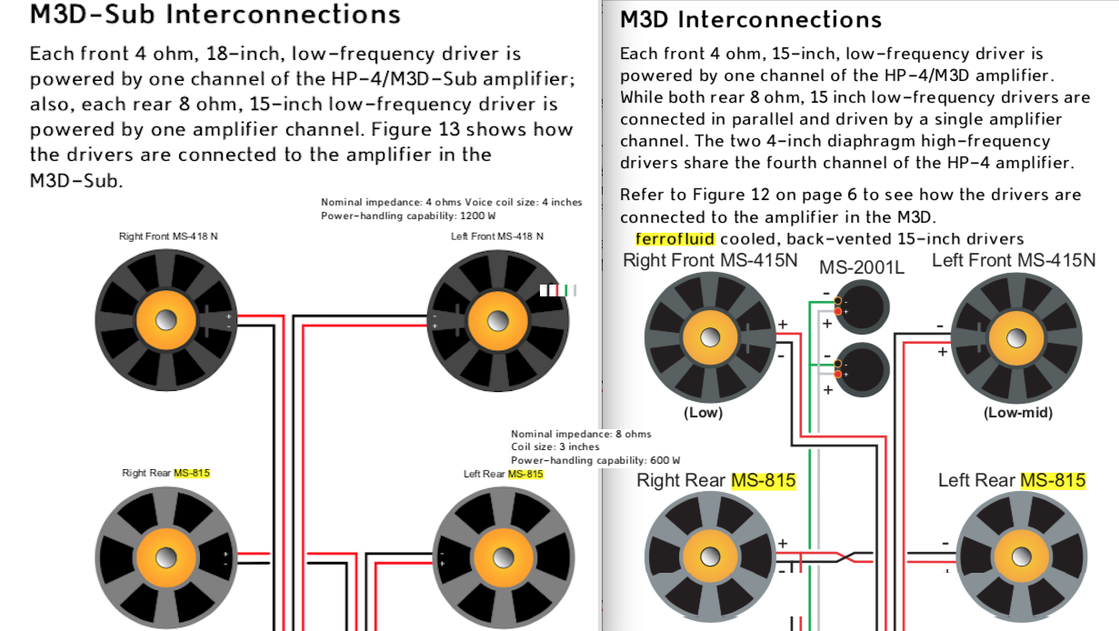

My thinking comes from a description in the Meyer M3D sub brochure, that contrasts its use of two rear firing ST-815s, with two other front firing 15"s that the brochure specifically touts as having ferrofluid with rated for 2X the power of the ST-815.

Both the Meyer M3D Line Array Loudspeaker and M3D-Sub Directional Subwoofer use MS-815, not ST-815) 15" drivers.
The M3D-Sub uses the 4 ohm 1200 watt 4" voice coil MS-418N(neodymium) 18" on the front side, the
8 ohm 3" voice coil 600 watt MS-815 on it's rear side.
The M3D uses the 4 ohm 1200 watt MS-415N(neodymium)15" on the front side, the 8 ohm 3" voice coil 600 watt MS-815 15" on it's rear side.

looks like you pulled connection drawings from the Operating Instructions. The first page of them was the "brochure" i was pulling my info from.....Couldn't find that brochure 😉
Yes, the MS-815 was original equipment.
It was discontinued , and the ST-815 is the replacement for all products previously using the MS-815.
(That info is on a sheet that came with the ST-815)
Yep, I may have mixed up whether i was talking about the M3D, or the M3D-Sub. But in either case, the way i read things (which may be wrong) , only the neo drivers have ferrofluid.The M3D-Sub uses the 4 ohm 1200 watt 4" voice coil MS-418N(neodymium) 18" on the front side, the

Your 15" 3" voice coil ST-815 has no pole piece back vent, seems about as likely as not it may use ferrofluid cooling.
That said, unlikely a 10 year old driver from Meyer Sound would use the hydrocarbon (kerosene) based ferrofluid materials more commonly used 40 years ago.
It does have a back vent. It's a very fine mesh that the pict posted doesn't show well, if at all.
Yep, although unless the driver goes back to misbehaving, i probably won't bother...Anyway, a call to Meyer's service department probably could end the speculation.

kerosene based ferrofluids are not specified for audio use. They are completely unusable for this application and meant for other applications.Usually the manufacturer lists the use of ferrofluid in their drivers, though in the 291 page Meyer Sound Design Reference manual there was only one mention.
Some ferrofluids are kerosene based, kerosene has similar viscosity to diesel fuel, which in winter could gel to the point where it would not flow without pre-heating.
