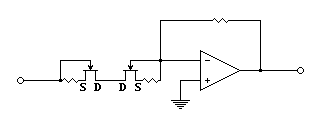

Add a bit of bias
hugobross, you might llike to try a little bit of bias to the diodes on your cct. You would have to separate them and feed the signal to them via caps. Maybe only a microamp or so each, just enough to get them up and barely conducting rather than the signal swinging freely and then slamming into the clipping point suddenly.
Some analog ccts use a "curve shaper" where the signal pulls up against a resistor, and as it goes past a certain threshold a diode becomes forward biased and effectively adds another resistor in parallel, then higher and another diode starts to conduct etc. Something along these lines might be worth playing with. Somewhere I think I saw an oscillator cct that turned a triangular waveform into a reasonable approximation of a sinewave using this method. Here's something http://www.uni-bonn.de/~uzs159/diode_tutorial/
Do a search on "diode" and "breakpoint" for more.

Somebody mentioned the Elektor magazine where they published an article about generating "tube distortion" using opamps and diodes. Elektor even published a circuit using a tube (ECC81 or 83 but I can't remember) running on very low anode voltage and OP - AMPs to achieve the typical soft clipping of tube amps. I didn't buy it but maybe somebody ot there did (it was in a German Eektor issue in spring 2002).
I once did some PSPICE simulations with diodes in the feedback part of a non-inverting OP-AMP. As already mentioned by someone else it is possible to make several soft "bends" in the transfer function to achieve something like the soft onsef of clipping. My simulations showed mainly third order THD with a little 5th order as would be expected by any soft and symmetrically clipping amplifier.
If you are interested I can supply details.

hi gromanswe
I don't like to listen to distorted sound either (specially not when listening to recorded music) !
But this is of course different to live sound, particularly with electric guitars and basses.
The first reason to actually (and intentionally !) USE distortion is as a sound effect (seldom for bass). This can be either real harsh kind of distortion generated by an effect called "fuzz-box" (using a heavily nonlinear transfer function). The less harsh distortion is generated mainly by driving a tube amplifier into clipping. Since tube push-pull output stages tend to clip soft with mainly (but of course not only!) 3rd order harmonics this sound is less harsh (the spectrum of many natural instrument contains 3rd order harmonics as well). The typical "screaming" sound of blues guitar players is typical for this.
I think the Elektor circuit could be used for that purpose as well with some tweaking (I have actually seen it but can't remember all the details).
The second reason for using soft clipping is a question of economy: The output signal of guitars and basses is quite peaky. I.e. the attack is asking for a lot of power. If you have an amp that clips soft then this might save as much as 6 to 10dBs of headroom (and when playing live you'll NEVER have enough power, and then it's usually better to clip soft than hard) !! The screaming sound mentioned above is actually generated by the soft distortion AND this compression effect (longer sustain, more gain to achieve feedback ....).
I once had a glimpse at the schematic diagram of a Trace Elliott bass combo that was using two zeners in the feedback part to achieve some sort of soft clipping. Because you don't usually let the whole band play through such an instrument amplifier you don't get that much IMD as you would get when running your CDs or whatever through such any amp driven into clipping.
I personally (I'm playing the bass guitar) like the sound as natural and uncompressed as possible and use a tube/SS preamp followed by a P.A. poweramp with enough headroom. Even the limiter (I.e. a device using a VCA, which is the other usual tool used for economy of power) is seldom used. On recorded music I prefer the sound of directly fed basses as well. But this is simply a matter of taste of course. If anybody likes to know how clean a directly fed bass guitar can sound shall listen to "A show of hands" by Victor Wooten.

- Is this a good way to simulate the sound of tubes??
