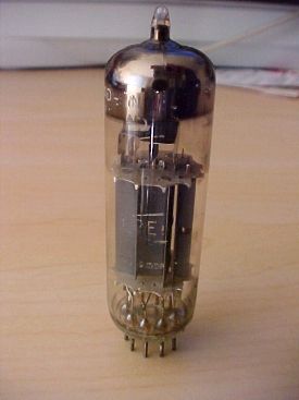

Sorry for all the posts. I noticed that the Wave 8 uses ECL82 or 6BM8 tubes and the S5 monoblock uses 11MS8 tubes. Furthermore, the S5 integrated stereo amp uses 11BM8 tubes. Then, there is the Bottlehead Foreplay that I ordered which has the following tubes: "The circuit uses one 12AU7 tube per channel, or one of the 12AU7 variants, 5814, 5963, 6189, etc."
Is one tube any better than the other. I know these are cheap amps and I'm building two monoblocks and a preamp for under $400, so I shouldn't have any buyer's remorse.

11BM8 should be a 6BM8 just a different filament voltage. The 11MS8 is a similar triode/pentode. The 6BM8 is/was widely used in audio so their is more experience with it. All 3 are also used in TVs, and the 11V heater versions were primamrily aimed at that ap. But with the unual filament voltage there are probably stashes of these that sold VERY cheap allowing the kits to come out at such low prices. It wouldn't take much to convery one amp to another -- you would need an additional filament trafo to switch an 11v to 6BM8s (unless there is enuff available juice for the filaments to throw away some by regulating the filament supply -- maybe on the monoblocs, probably not on the others). The plate resistance on the 11MS8s is a bit lower than the BM8s thou.
