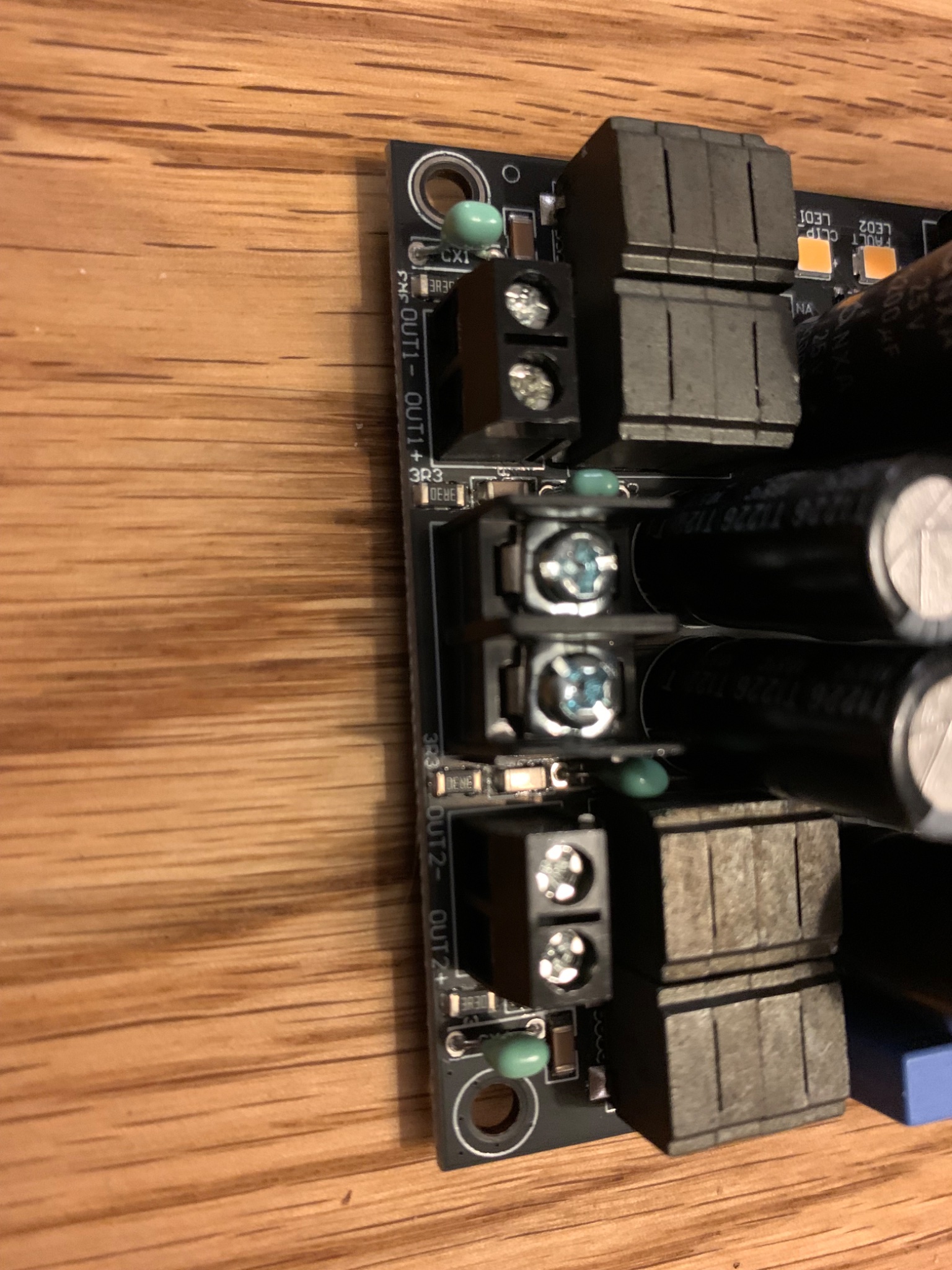

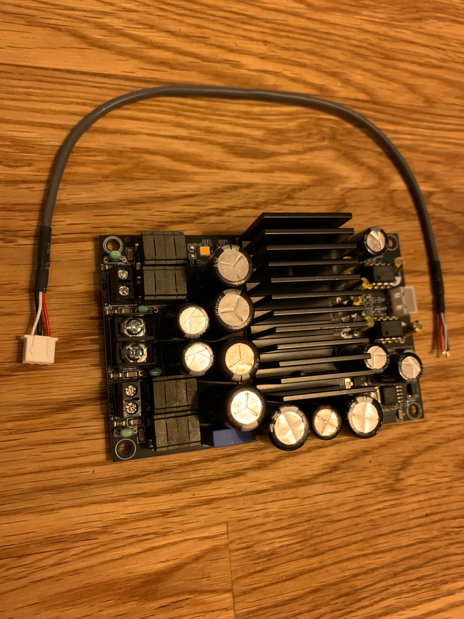

Is this a good sounding TPA3255 board?

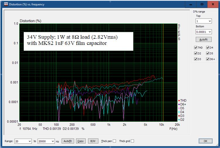

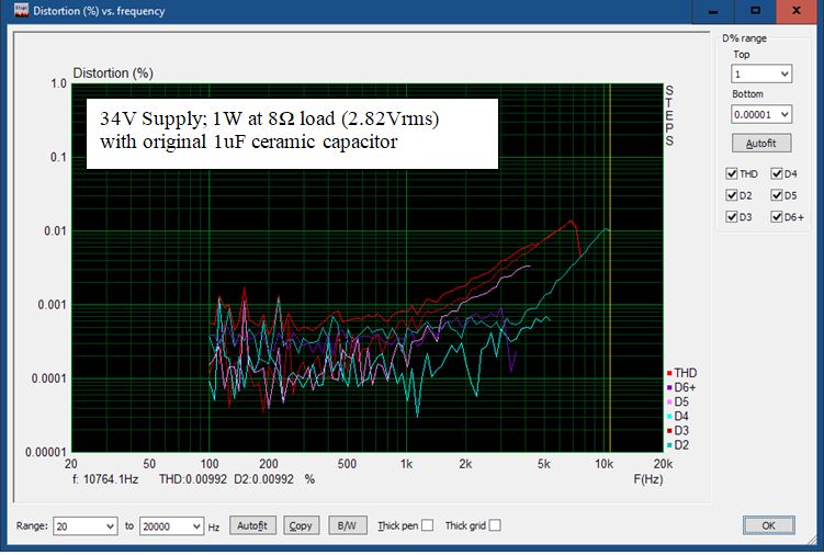

Audiogue:s measurements with the 1 uF WIMA modifikation in the output filter shows significantly reduced distortion. This way , this card measures much better than an Aiyima a07 .
Lowest distortion seems to be ( according to Audiogue ) at 34V .
I had a similar one and already threw it away. All low-cost TPA3255 boards on the market use a single supply with low-quality coupling capacitors. If you want to replace them with high-quality capacitors, there is no space because they are very bulky. Additionally, the voltage regulators on these boards are of poor quality. I do believe that all the components on the board are also low quality.

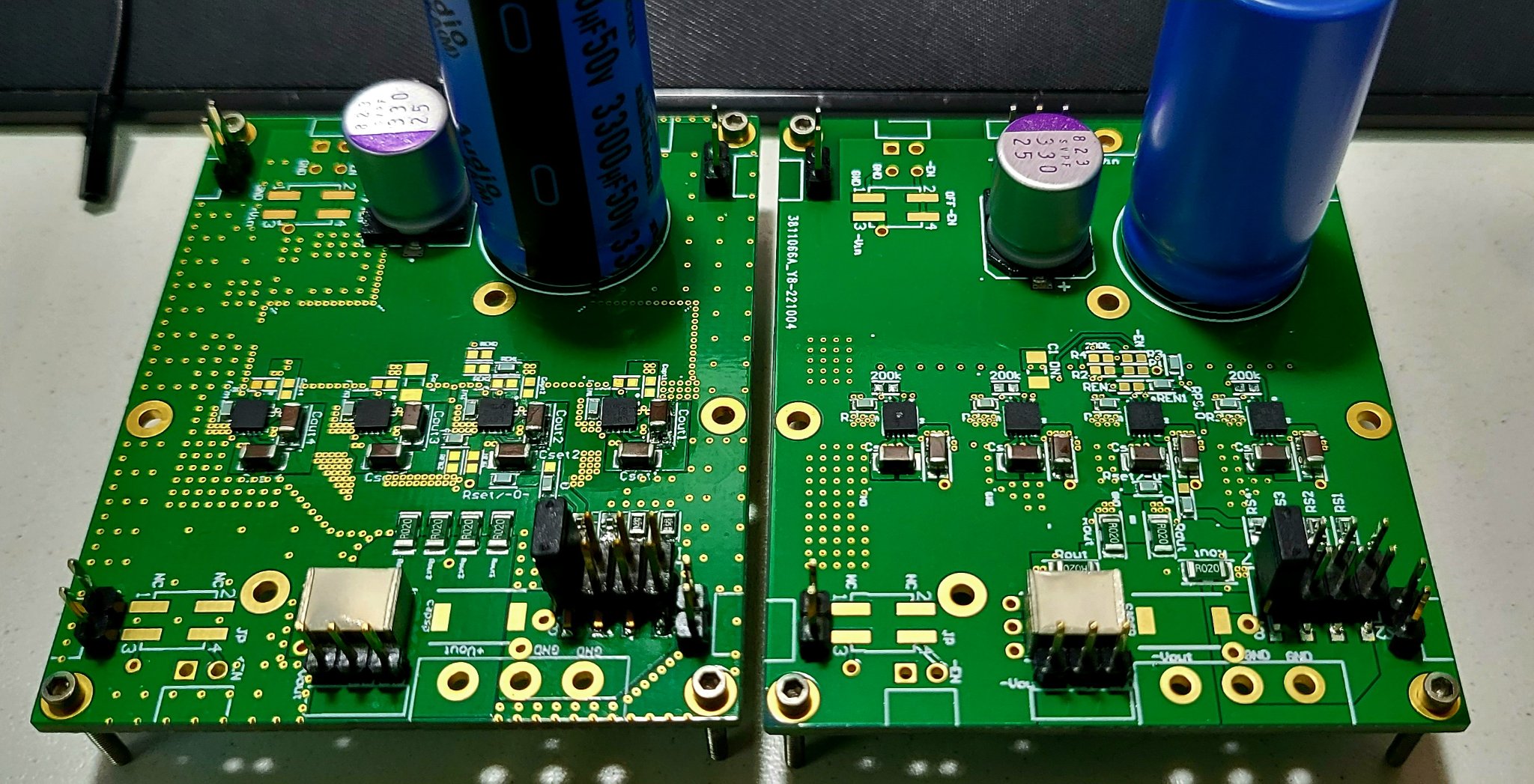

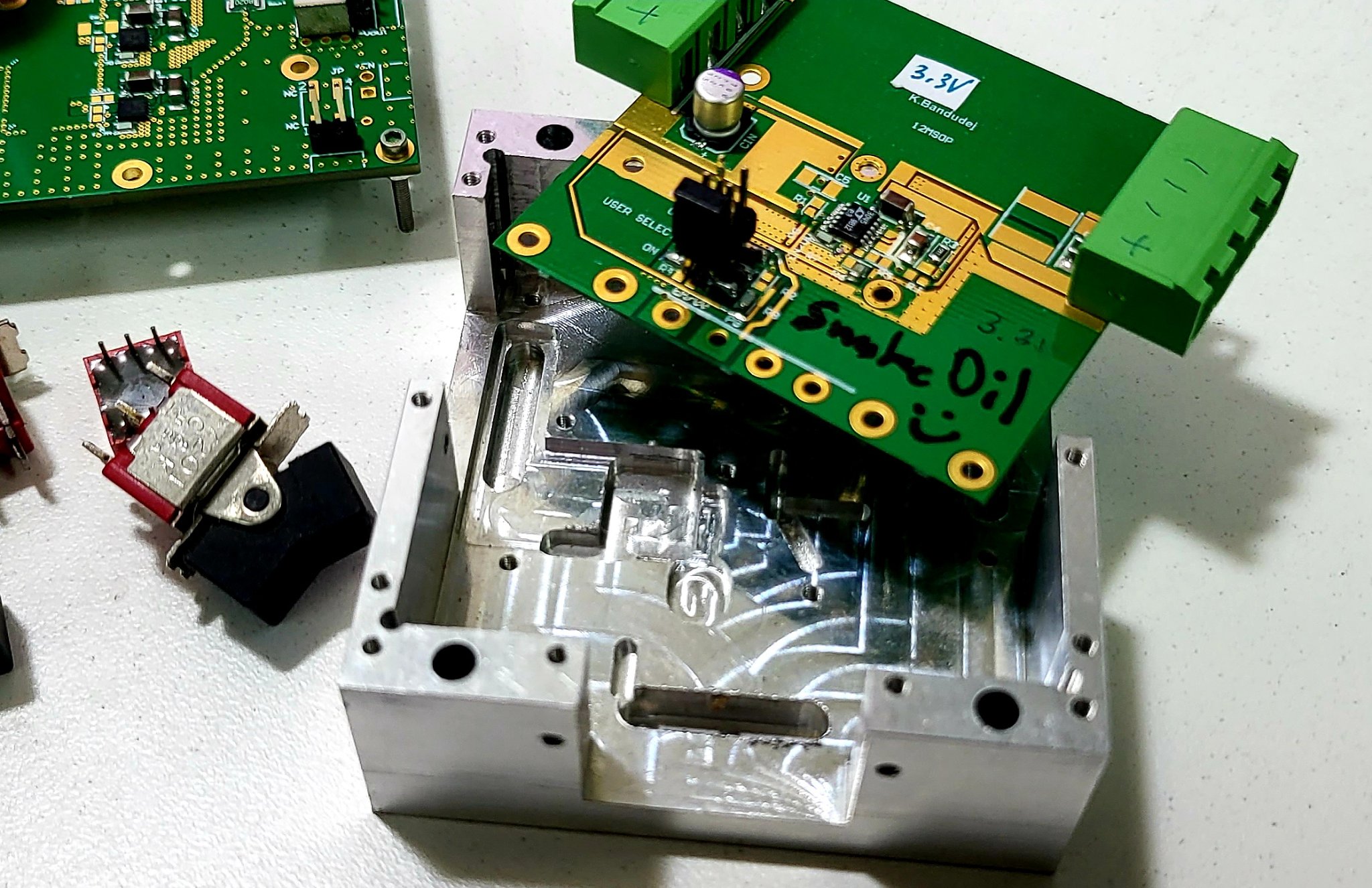

I developed the second revision of the TPA3255 PCB, incorporating PFFB. The design includes a TPS7A470x powering an LT3045 for the positive rail (POS) and a TPS7A3301 powering an LT3094 for the negative rail (NEG), both embedded in the PCB.
You should look for a board that uses a dual supply for the opamp to eliminate the need for coupling capacitors. Key components such as the LC output filter, low-noise high-PSRR linear regulators, resistor and capacitor size/type, and PCB layout play a crucial role. I designed it with a high-cost approach, but it feels great. For this version I do not finish yet. All the opamps on the board are single opamps, allowing me to use OPA1611, OPA627, AD797, LT1028, and my custom discrete opamp as well.

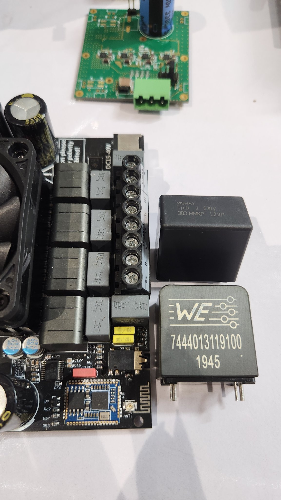

The picture below shows a comparison between the LC filter components on a Chinese board and the LC filter that I use.
In summary, it is not great, but it is okay depending on your satisfaction. If budget is not a concern, Orchard Audio Starkrimson, Hypex, and other high-end options are better choices. The $245 TPA3255 evaluation board from Texas Instruments might be the answer in term of low price and good quality.
