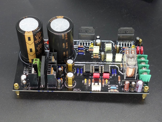

Have you managed to get (or fabricate) a schematic of this amp? Love to see how they are implementing the servo.

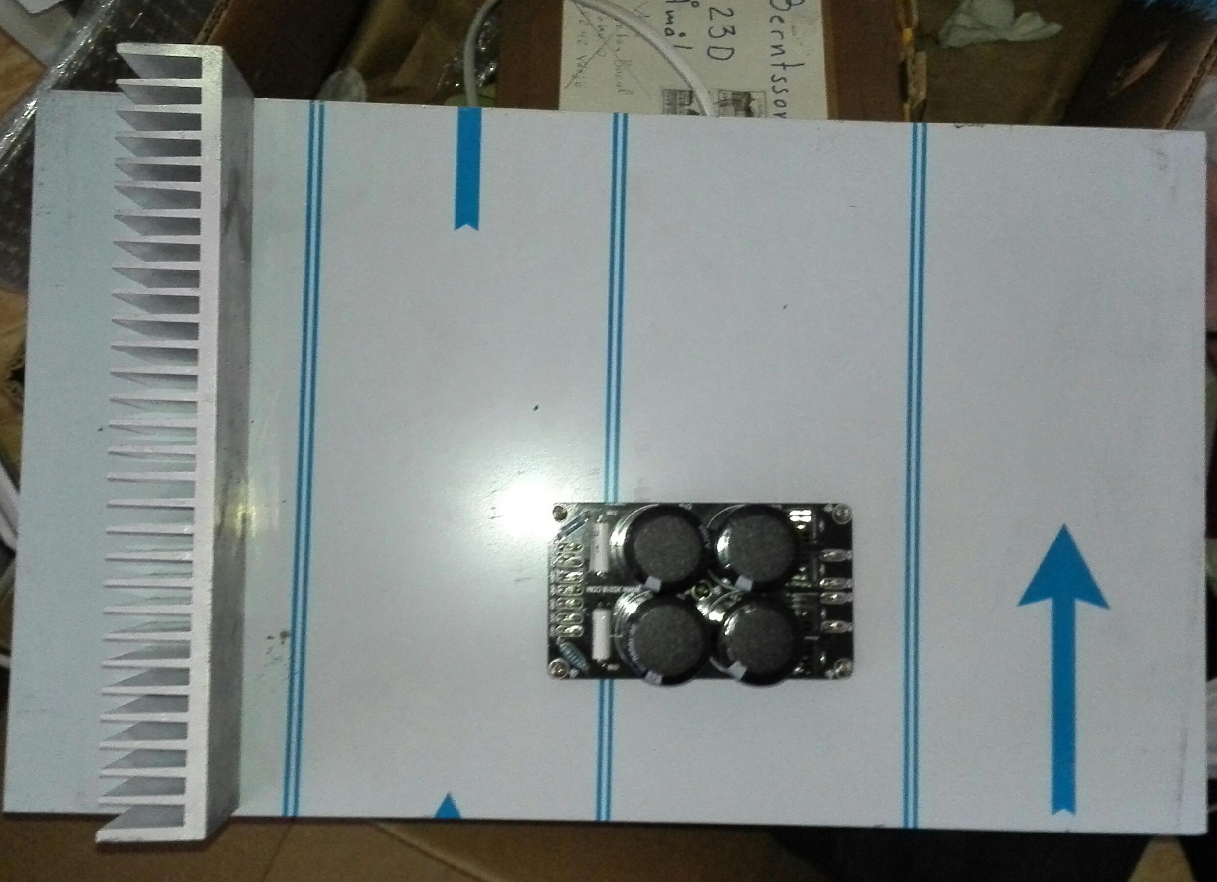

Recieved the two alu-sheets I'll use as bottom/top-plates on this amp... I wanted space to do a nice layout, and I got it lol.
The sheets are 500*300*3mm, and that's a bit larger having them in front of me than just looking at the measurements.
The idea is to use the 300*70*40mm heatsink as one of the side-panels, have something like dark oak for front-plate and the other side-panel.

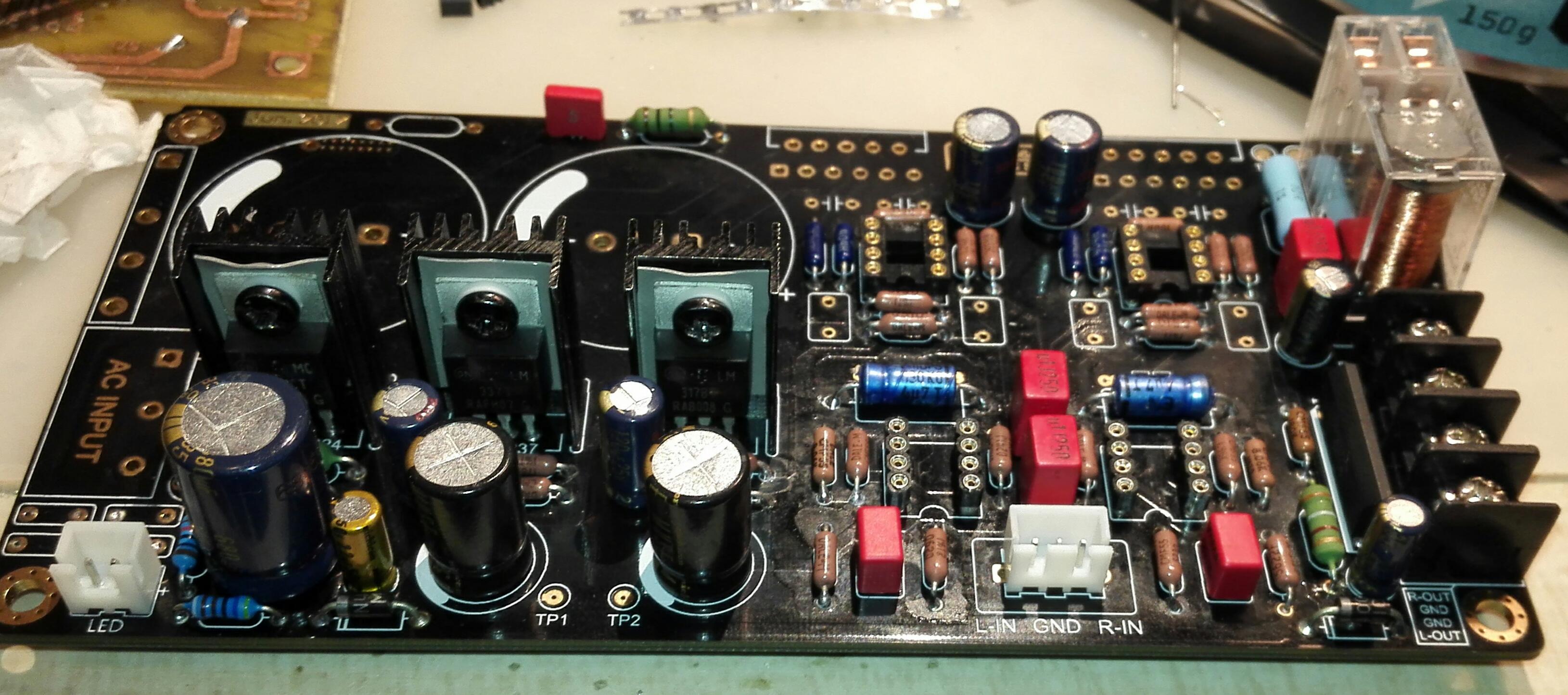

As NE5534 is not unity gain stable and needs at least 3x gain then is this kit implementing such a gain? Maybe if I calculate well it is on 5x ?

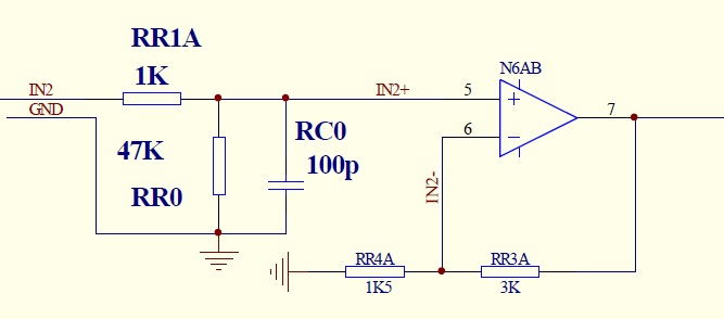

Is the 523 Ohm an input NE5534 resistor and if so should be matching the value of the gain setting resistors? I mean in the older one there are three resistors, RR1A, RR3A and RR4A where RR1A should be 1K based on the values of the other two, you can see the attached schematic of the old one. I don`t recall where I had read about it neither the calculation formula but back then I was looking at it I was convinced it must be 1K or there will be a DC offset. Am I right on this? Am I missing something?

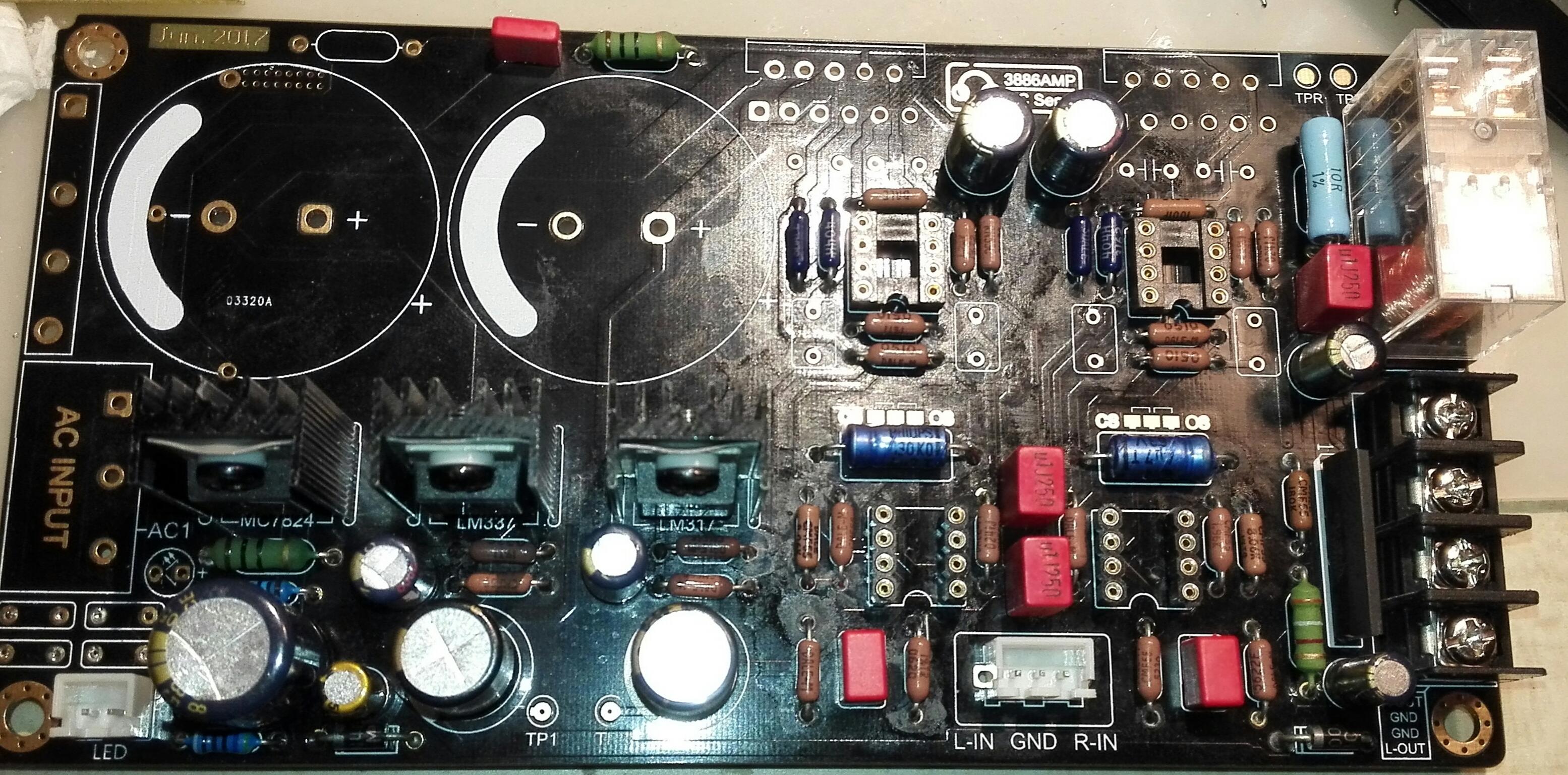

Is the supplied regulator for the uPC1237 a 7824 and not a 7812 one or the stuffing drawing is false?
What is the lead spacing required for the 4.7uF input capacitors? Can you measure?
Is the 10R supposed to be 10R or 10K? (as there is no schematic)

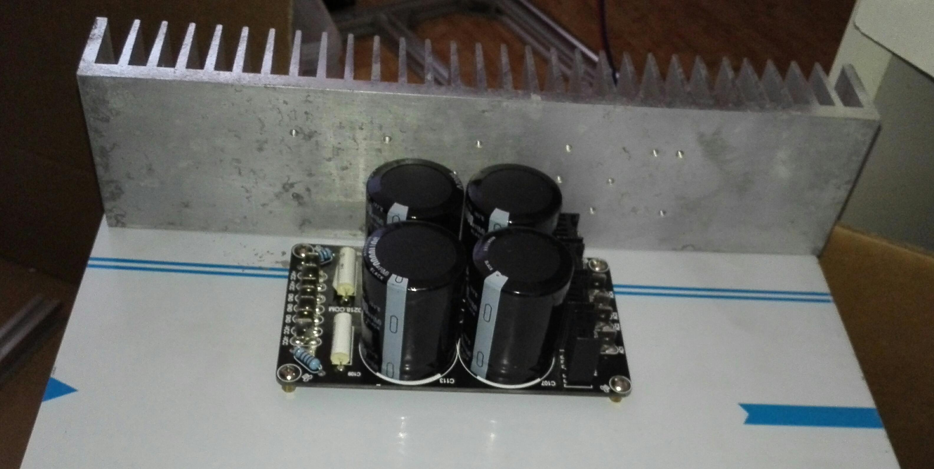

The heatsink arrived today.
Some pics attached The 3mm thick alu-sheet looks very big lol
