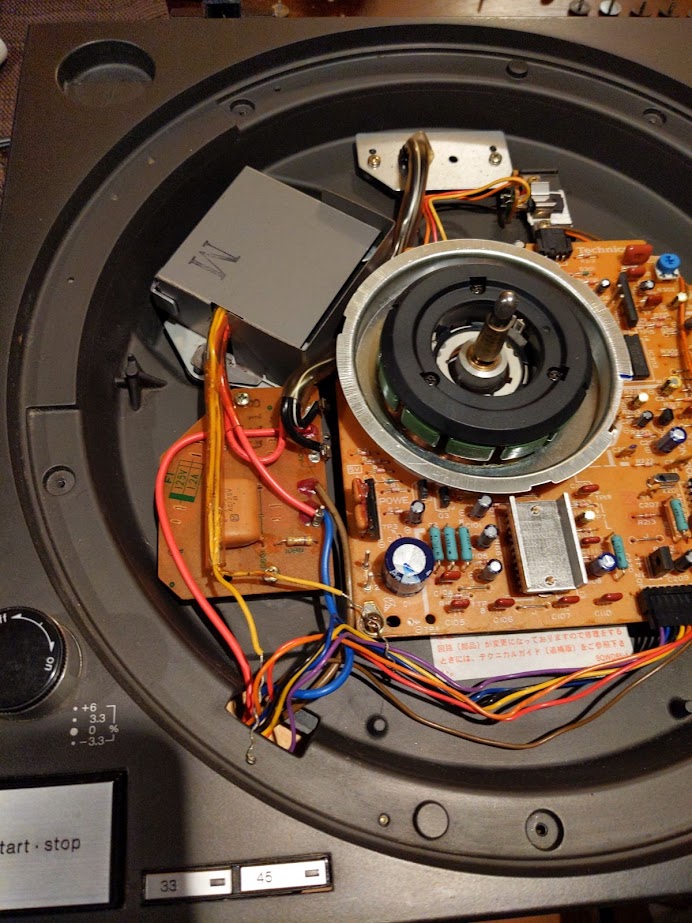

Acquired a Technics 1200 MK2 that won't turn on. I took the platter and plastic cover off to take a look. Right away noticed there was what I assume to be magic juice residue in the well that that the power transformer sits in. No external evidence of liquid spill or anything of the like.
I plugged in to see if I could do some basic testing as far as I might understand. I measured where the power cable leads plug in and got 120V AC, then again the two red wires that run into the transformer case. Again got 120V AC. Then measured the two yellow wires that plug into the mainboard, got 0V AC. Would this indicate a dead transformer?

I would try measuring the 2 yellow leads after disconnecting them from the pcb as there could be a shorted capacitor on the pcb.
Just tried this. No change, still getting 0V AC across the two yellow wires disconnected from PCB. Verified 120V across the red wire terminals going into transformer. Verified that flipping the power switch on makes that live, switch off and those go to 0 as well. So don't think it's a bad switch.

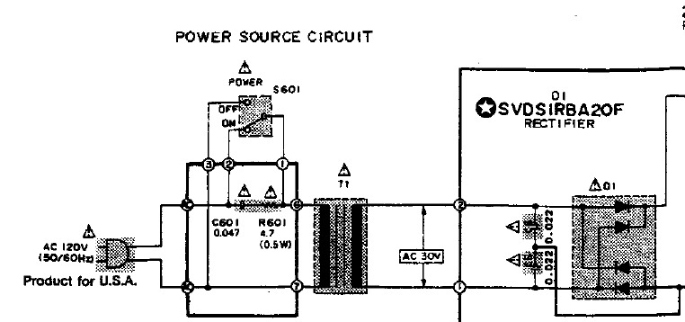

There is no fuse in the USA 120V version. Connect 30VAC to the output of the transformer to see if no other parts of the circuit are damaged.

Disconnect the yellow wires and check the secondary with Ohmmeter. If measures open circuit then its gone.
Tried this. Getting a reading of 4ohms across the two yellow wires.

Try to measure the primary with Ohmmeter (across red wires). If theres no mains fuse there might be thermal fuse inside transformer that burned out, giving open circuit.

Multimeter shows OL reading across the two wires. I had unwound them from the power input pcb.Try to measure the primary with Ohmmeter (across red wires). If theres no mains fuse there might be thermal fuse inside transformer that burned out, giving open circuit.
Very small voltage across yellow wires might be stray-capacitance coupling between windings. Or just some AC hum picked by multimeter leads.
Ok, thanks for confirming. Doesn't seem terribly complicated to swap.You have the classic symptoms of an opencircuit primary winding in the mains transformer.

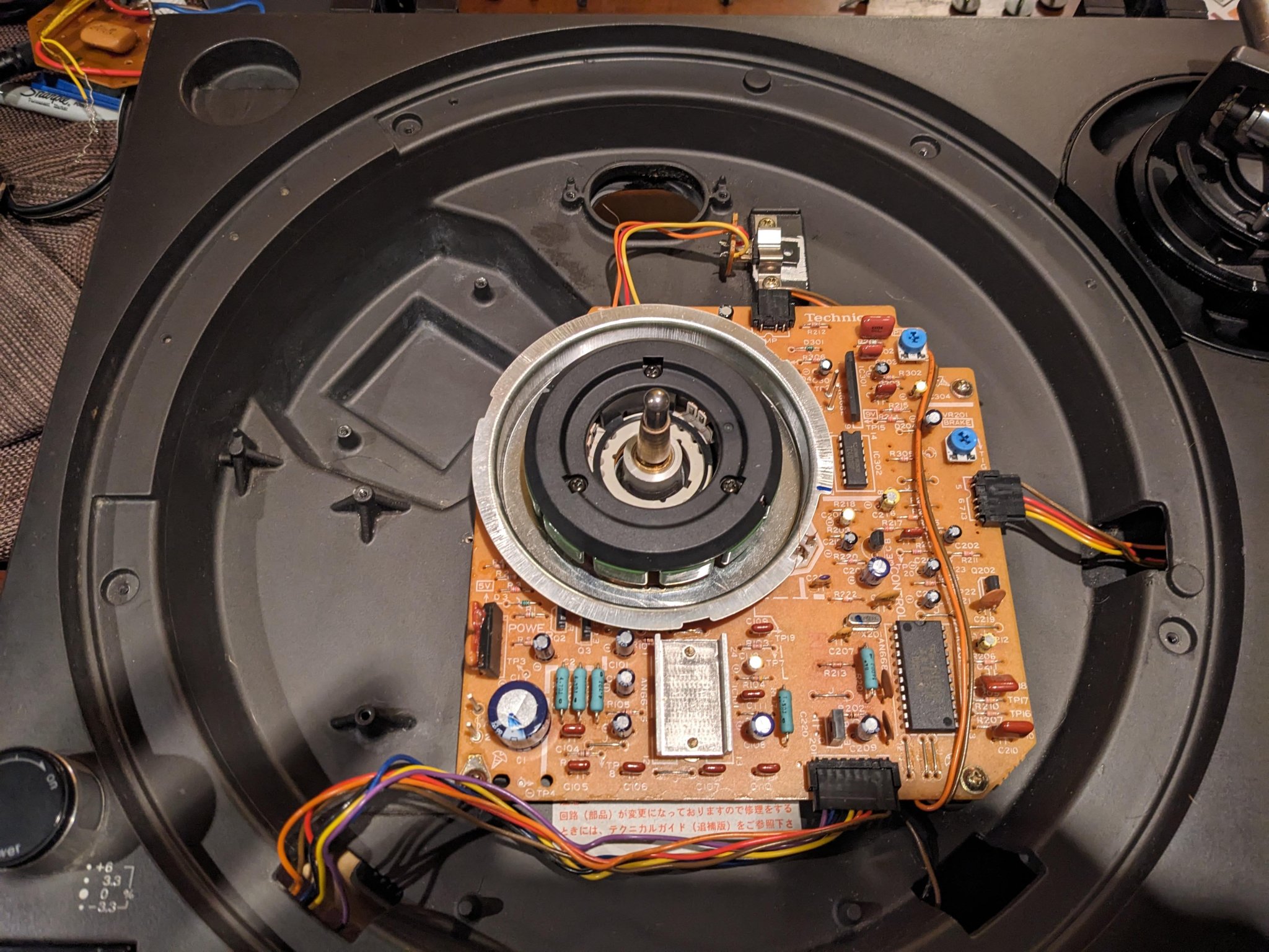

Got a used matching transformer/ac cord/power-switch assembly. Would like to say it was for the sake of "keeping it stock", was some of that, and some anxiety with wiring another transformer. As is, this was a fairly straightforward drop in. Got 30V AC coming out of it. Hums a small bit, will take it. Turntable turned on fine. Put it all back together, put in my system. Got sound out of the left channel, nothing out of the right. It had aftermarket phono wires installed when I picked it up. They are a bit thick for this purpose, connectors not very good. Will test continuity soon to isolate where signal is breaking down, but thinking to swap the wires in any case.

pic above shows secondaries not yet wound up around posts, I didn't forget that bit before putting it back together .
