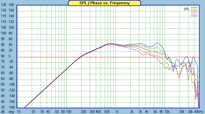

The 75-1558SE is a very nice driver, but hard to find now and/or very expensive. I would not cross any higher than 3.5kHz because of the size of the driver - the center to center distance with the tweeter limits how high you can cross otherwise your will get a rough power response - a big droop at the crossover point as you move off axis.
I would definitely not cross an 8" driver at 8kHz unless you are crossing to a horn/waveguide tweeter with an 8" mouth. Even if you had a tweeter with a similar off axis response, the speaker would only have top end extension through a very narrow listening angle and at least a few meters away. If you mate it with a tweeter with a wider beam width then your power response will droop hard up to 8kHz and then spike up again as the tweeter takes over. In my opinion if your tweeter can't handle lower than 8k it would be better in that case just to run the 8" all the way up to 20kHz and not have a tweeter.
A 3" cone midrange might be a better solution. You'll be able to get the CTC distance down enough to cross at maybe 4.5-5kHz without major issues. Some of the better Fountek (FR88EX) and Tang Band 3" (W3-2141) can comfortably do 400Hz LR4
If you want to stick with a dome mid then the RS52AN-8 can do 600Hz LR4. Up top I would not go higher than 3.5kHz due to CTC and distortion products exciting the 13kHz dome breakup node. The flange is smaller than most 2" dome mids which allows a good CTC with a full size tweeter.
There's also the DC50FA-8. The bottom end is clean - 500Hz LR4 no problem. It's not as clean in non-linear distortion or frequency response through 1-3kHz compared to the RS52 or the better 3" cones but does not have any serious distortion problems that would limit the upper crossover point. What does limit the crossover point is that the flange is quite large, so that in my opinion sets a limit of no higher than 3.5kHz.
The problem is the distance with the tweeter. If you have a driver that has a really large flange/frame then you physically can't place your tweeter as close to the dome as you can with a driver that has a smaller frame.
The 75-1558SE has a 140mm flange. Therefore if you pair it with a standard 104mm flange tweeter the closest you can place the domes together is half of 140mm plus half of 104mm = 122mm (CTC distance). As you move off axis vertically, one speaker becomes closer to the listener than the other. At some point the difference will cause cancellation between the speakers due to being 1/2 wavelength or 180 degrees out of phase. At 3.5kHz, cancellation for drivers with a 122mm CTC occurs at 24°
This is because
speed of sound = 345m/s
wavelength = 345m/3500Hz = 9.9cm -> half wavelength = 4.95cm
sin(24°)*122mm = 4.96cm
If you increase the crossover point to 5kHz:
wavelength = 345m/5000Hz = 6.9cm -> half wavelength = 3.45cm
sin(16.4°)*122mm = 3.45cm
So cancellation occurs at an even smaller angle off axis. Of course if you run a 3.5kHz crossover then it doesn't matter so much that the drivers are out of phase at 5kHz when you are 16.4 degrees off axis because onen driver is already heavily rolled off by the crossover. The worst case is when the cancellation occurs at the crossover frequency.
The smaller the CTC distance then the frequency response is free of cancellation at a given frequency through a wider listening angle.
If you use a 3" cone midrange then the frame is only about 90mm, allowing you to place the tweeter 25mm closer which means you can use a higher crossover point, or have a better power response.

I just read as advised Zaph input I copy here for other readers :
Comments: This is a 3" textile dome midrange with very good performance on all fronts. Smooth response with only mild breakup peaking at 7kHz. With the clean distortion profile, how low you cross is limited only by how loud you need them to play. My initial estimate is 400 Hz LR4 or 700 Hz LR2. A well damped resonance will likely not need a conjugate circuit to flatten impedance. The flange is fairly large and in some cases a small cone mid may be a better choice. The high pass crossover point will be limited by center to center distance and off axis rolloff, I recommend no higher than 3kHz. Off axis response curves available. Tested June 2009
this is the off axis linked in the coment above !
