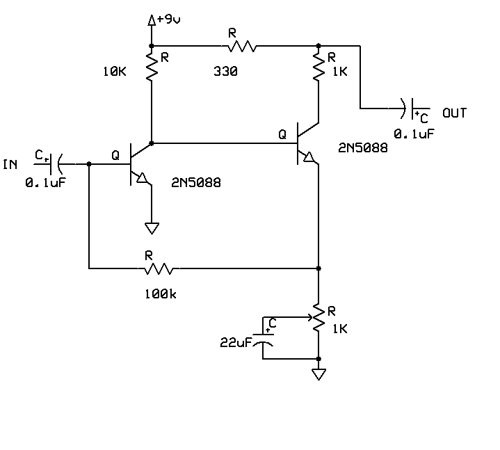

is thier away get ride of the hum and hiss in this fuzz schematic?????
it just a simple fuzz stomp box schematic
when you turn up 3/4 way gets realy bad

Emitter-to-ground for a 2N5088 is baaaaad. Their beta is way too high (I've measured them up to 600!). You need an emitter resistor (bypassed) to control it. That'll drop your hiss by a good 20dB+.
Also, you want your output cap on the other side of that 1K resistor and reverse the polarity of both the input and output cap.
