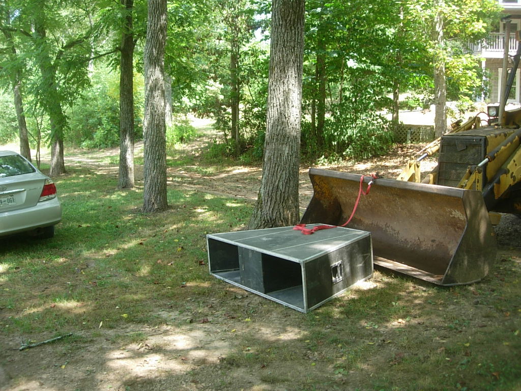

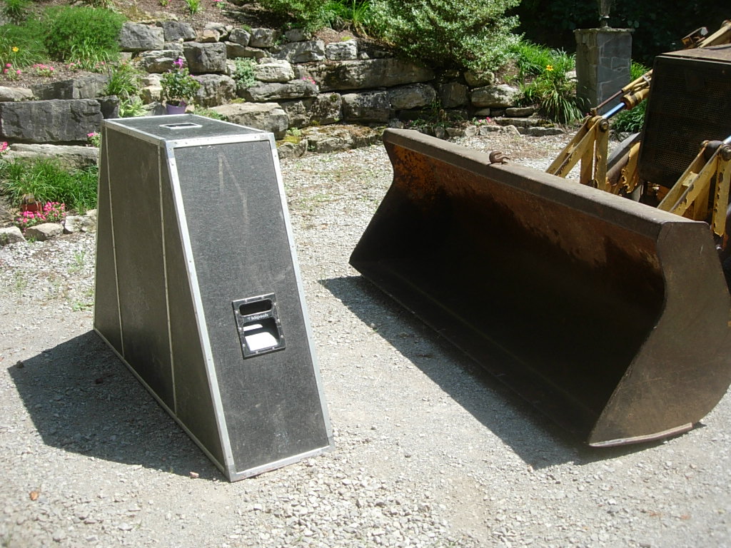

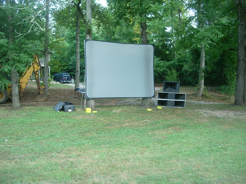

I know the MWM are designed for huge spaces / outdoors. Does anyone see any fundamental issue with my plan based on the space described? Thanks.
I have MWM clones in a similar sized space. No problem.
Your HF horn could be a bit too high, for seated, but could work well for a general purpose room.
