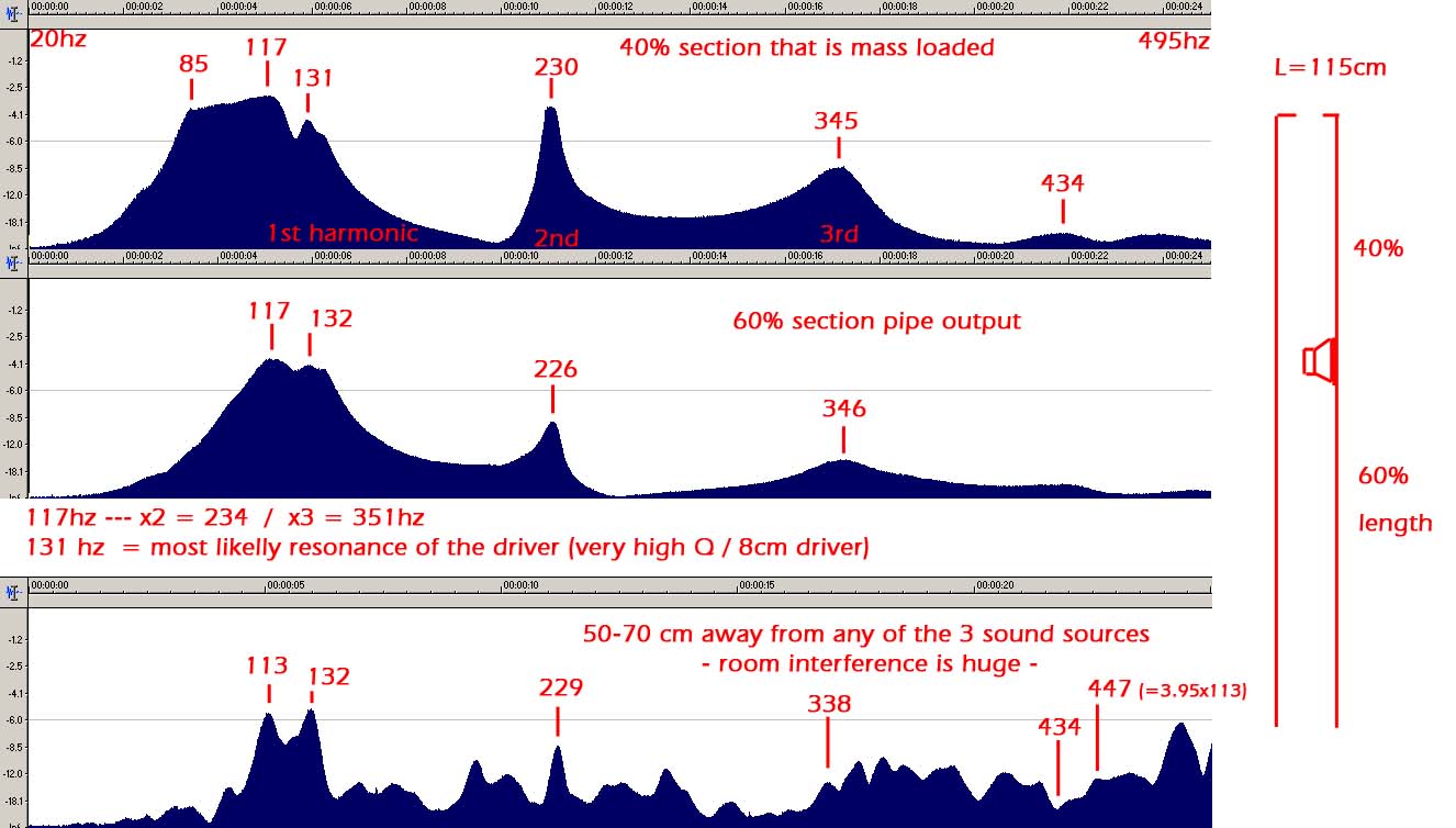

Main problem I have is how to “pull” the second harmonic out of the box and make it contribute to the output of the enclosure; the 2nd harmonic seams to be always out of phase between the pipe ends; I would like to point out that the enclosure must have driver offsetted from the 50% position because that one kills the second harmonic and all even ones therefore making it acoustically identical to a QW pipe (closed/TL). But there was a problem with offsetting the driver – the time necessary for the sound to travel from the driver to one end vs the other was different and that’s a recipe for out of phase problems.
So I came up with what I consider to be a solution – just make a “bridge” between the left and right sides of the “U” shaped folded pipe, resulting in a wave guide in the shape of the “A” letter – just look at the attachment. This is a frankensteinian TL for sure because it displays a weird thing – the 2.5 harmonic… I don’t know if it exists outside of this observation (subjective) but it’s weird and it even has a harmonic of it’s own (actually the 5th is normal); the driver sits at 20% folded pipe length; I still can’t make it sing the 2nd harmonic because outside it still plays only odd harmonics and maybe something of a larger SPL between 1st and 3rd but with this improvised method of “measuring” I can’t tell for sure; the only significant difference between this enclosure and a regular no offset TL (1/4) was that after adding stuffing the 3rd harmonic immediately disappeared leaving only a good solid platform above 1st harmonic, while the ¼ TL was almost unchanged from the same amount of stuffing.
As far as SPL is concerned they are very close, the “A” enclosure with stuffing definitely sound more hi fi in reality filling some of the empty spaces above 1st harmonic; the reason for which the ¼ TL sounded more aggressive it appears that it was related to that 3rd harmonic that added something all the time (a resonance) and made it louder.
I have other ideas of more frankensteinian open pipe TL but so far nothing seems to really work, no major improvements over the ¼ design. If anybody knows why the second harmonic does not poke it’s head out of the box please share.

Second harmonic demystified
Second harmonic of an open pipe is different kind of a resonance because I have just confirmed that it is capable of "hiding" in the enclosure if the enclosure is folded; got the confirmation by placing the driver at 60% line length in the quarter wave control I have built (that had one end naturally opened and the other one had the circle hole for the driver as it was used in QW mode) - this enclosure is just one simple straight line with rectangular section. This time the second harmonic was very much present everywhere! There is something that doesn't add up to the theory - the fact that the enclosure is tuned to 117 hz it appears... when it suppose to be at 149 hz... don't ask why coz' I don't know (that mass loading?). Another observation is that the driver could not be left in the middle since that position kills the second harmonic; 5th was located above 500 hz that's why it's not in the graph.
This also gave me the idea that the open pipe enclosure could be simulated with a bass reflex cabinet with 2 ports as long as you have the freedom to move the ports independently to the ends of a very long shaped enclosure with the driver somewhere in the middle - suggestions are welcome to which software does this.
