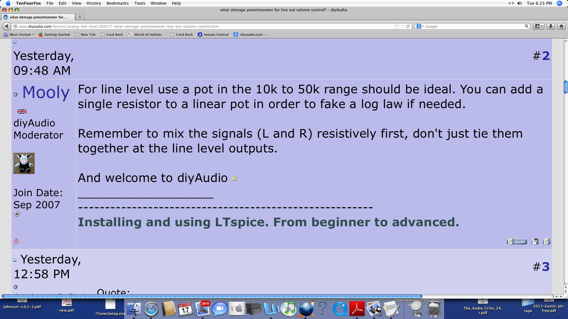

Mooly just showed how to do it 'wrong'. Sorry Mooly, but when you load a linear pot you can have real problems with distorton. The original Levinson JC-2 preamp used that technique, and we HAD to change it to log-hi Z loading. Some pots may be OK, but cost will not tell you which.
