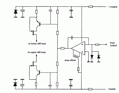

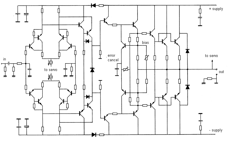

Global NFB closed around as linear stages as possible improves all of the technical and sonic characteristics. The wrong reputation of global NFB results from poor designs that try to cure hard non-linearities like class B crossover distortion and turn-on-off spikes only by means of global NFB, instead of sophisticated solution of individual stages before application of global NFB.
Together with a friend I designed and built in 1983 a class AB amplifier that is overall feedback free and non-switching. Below is the circuit of the amplifier and in the next post the servo that is used.
I removed the values and transistor types as I still have other plans with it. It will give you an idea.
It sounds very good with a very well controlled bass. In listening tests it was at par with a Stax DA-50M an definitely better than a Hafler DH220 and Bryston 2B.
The output impedance is adjusted to zero (DF is infinity) with the error cancellation adjustment, based on the Hawksford error feedback circuit. This circuit linearizes the output stage. Input stage and VAS stage use local feedback only. This topology was chosen for no interface intermodulation distortion and no transient intermodulation distortion.
Output power is 70W in 8 Ohm. Measured distortion at -20dB below clipping is 0.05% both at 1kHz and 10kHz. Measured distortion at 1dB below clipping is 0.1% at 1kHz and 0.13% at 10kHz. Low order harmonics only. Bandwidth 200kHz with input filter, 700kHz without input filter. SNR is 100dBA.

Steven,
This is a clever circuit, brimming over with interesting ideas. Your performance figures look outstanding.
But it is complex, and a good pcb design would take quite some time to put together. Can you give it a single input diff pair? I suspect so......
If this gave you no perceived reduction in sonics, it would be much easier to build. In all my R&D I've never found any reason to favour two input diff pairs, at least from the sonic POV.
Thank you for sharing your ideas,
Hugh
Hugh
Thanks Hugh,
At that time complete symmetry was very popular and at least it allows for two times more local feedback for the same output. The input stage looks complex because of the input pairs using CFP's, but the difference in linearity is big compared to normal differential pairs. The input stage should deal with almost 2Vpp differential input voltage. Anyway, these are all small transistors, costing close to nothing. We made a single layer PCB, which is quite compact, has only one jumper wire and even contains the metal TO3 power transistors on an L-profile. Only at the moment I cannot find the PCB-film back. It's more than 20 years ago.
Steven
Steven
Steven, this is a very fine circuit able to give perfect results. CFP's in the input stages, the way how 2nd stage is coupled and crossover distortion compensation can lead to absolutely perfect sonic results. Borbely, Hawksford, Bruce Candy and Upupa Epops (Pavel Dudek) use similar topologies or parts of it. Yes, this is the way how to reach the top.
Hugh, I disagree. I know very well the limits of topologies like P3A or Project61 (you know what I speak about). They would never give the results and space for continuous improvement shown in Steven's circuit.
Interesting circuit, Steven. Yes, it is important to find novel ways to steer the output so that it has no DC offset. Personally, I believe in servos. BUT, it seems important to me that the servo is only significantly active at VERY LOW frequencies, and not as a low frequency roll-off. Years ago, I actually tried to make a servo also act as a high pass filter (ie 50Hz). This was not so good. It appears to be better to just use a quality cap to do the same thing.
Usually, it is best to minimize 'global' feedback. Probably, feedback pairs are better, but not perfect. In any case, the most linear circuit, (without feedback) is usually best.
Pavel,
No problem. I accept you and I disagree; it is the nature of technology. Neither did I mention my own designs; I am not self-serving, I believe you realise this.
I believe Steven has come up with something very impressive, and said so with sincerity. The circuit is inspired and I am studying it in detail right now. While I believe a fully complementary design is unnecessary, I would need to verify it in listening tests for this design. Hell, I could be wrong!! (It happened once before, in 1962, IIRC.)
Pavel, there is a huge difference between a commercial design and a full-on, academically inspired and researched conceptual design. I now realize the difference, and do not in any way denigrate this design, which uses the fully complementary philosophy of the Elektor Crescendo. However, I draw much of my inspiration from the conceptual circuits to be found in academia, and now from this one. Steven, Pavel, are you familiar with Peter Blomley's non-switching Class AB of the early seventies? There's another to consider.
Pavel, you are a touchy fellow, aren't you?
But we still love you....... A man who designs good power followers can't be all bad!
Hugh
Hugh
