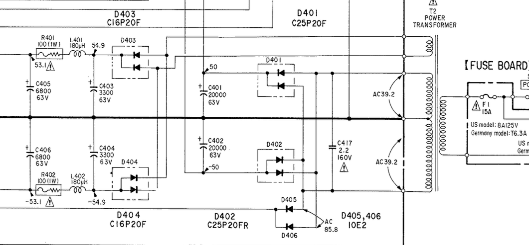

thanks for your answers, well the amp was just some few parts that have in my hands because was a donor unit to fix other amps so one of the parts that missing was the transformer so I don’t have physical access so I can find any ratings or something and I was thinking to find an aftermarket one with the same ratings to replace it

Well it’s a class a power amp (I guess “signature” line or something) from Sony model number ta-nr1 I don’t even had the chassis for this amp I only have a few boards like power amplification board and and some others like temp. Meter board which as I see there as a temp meter in the front of the amp that connects to it, so I guess that would be a good idea to find the missing parts or alternatives and put them into a chassis just for getting start and learn about electronics from this “mini project” 🙂
2 x 35...38V 750 VA weighing a whopping 14 kg as is clearly stated in the link by crisng. Too bad but it has 1 extra winding for the VAS power supply. Technically a fine choice, challenge for you. Can be solved with an extra small 80VA 2 x 35V (in series) transformer. Surprisingly it has no middle point connection.
