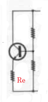

The circuit of the "Vbe" multiplier also works as an impedance multiplier of re,
or re+Re, or re+Ze, where Ze will be a complex combination of R, L, C. -whatever
is connected between Em. lead and the lower resistor in the base divider.
The multiplier is the same as for the voltage.

The first attach depicts inclusion of Re for (re+Re) multiplication.
Or any other combination of R, C, L to be amplified (as will be seen between output leads).

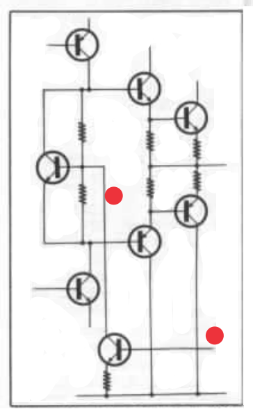

The second attach shows one of the methods to allow for the manipulation of the bias to
achieve Sliding bias cl.A, or Non-switching cl.AB...

It looks like a 'Vbe multiplier' is used as a non-linear load here to lower the distortion of the stage.Another example is Clarion patent:
https://worldwide.espacenet.com/patent/search/family/014844031/publication/JPS5912604A?q=pn=JPS5912604A
Does anyone know whether that works?
Jan
I haven't read the patent, I only looked at the schematic. It looks like a variant of the voltage mirror, where you would use a stack of n diode-connected transistors (and a resistor with value nRE if the common-emitter stage has an emitter degeneration resistor with value RE) if you want a gain of -n.
A voltage mirror works well as long as the load impedance is much higher than the impedance of the stack of diode-connected transistors (and resistor, if applicable). Too low load impedances disturb the distortion compensation.
In this variant, the voltage divider of the VBE multiplier will already disturb the distortion compensation. Maybe you can correct for it to some extent by using unequal voltages across the emitter resistors.

That second circuit is a form of positive feedback.The first attach depicts inclusion of Re for (re+Re) multiplication.
I would be very wary to use that; if it isn't exactly right it either doesn't work or, worse, will runaway and release the magic smoke.
