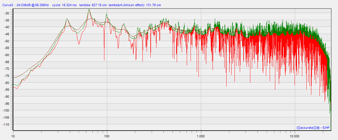

Self-quoting:
I think we can all agree that most (if not all) of the non-EQ-tractionnable nulls appears in the first 4 octaves, but more precisely, from my experience, between 45hz and 130hz. Woofer territory. That's all room & position dependant.
If you boost like crazy a null at, let's say, 65hz... For a given room, speaker's position and listening spot.. you'll end up with some nasty, boomy, peak if you change your listening spot. Most likely at his worst near the walls/corners. So, it was there, just not at the exact spot you want it...
Signal correction (EQ) is very tricky in the 2nd and 3rd octave. More often you don't correct the driver's or enclosure's response but the room/positions, which is, IMO, not the good way.
As a matter of facts, nulls do not exist, as they show up in measurements in a different way depending of the treatment applied to the raw data ( smoothing, frequency dependant windows, etc...) and depending also if measurments are at one point only or averaging of various positions.
Measurements need interpretation before applying any Eq.
Room modes are generally narrow and position dependant, whereas boundary effect are much smoother and not so position dependant ( it's a quasi power response as according to Allison works).
In a practical sense, audiophile/listener's position, humanoïd earing specs: We don't care about averaging in various positions.
End result is: ''there is no bass, mate!''
...and the best way to adress this issue is to either move yourself (listener's position) and/or change the speakers/room config and/or add acoustical treatment. The so-called room-correction DSP magic wand comes last. Which, bytheway, would be effective as a tweak tool IF the first steps are taken care of.
