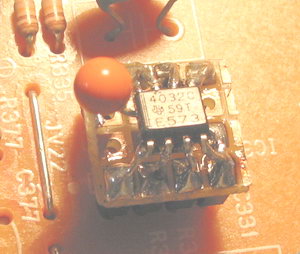

I have done a brief (couple of hours) direct comparison of: NE5534, BE4558, TL072, OPA2228, OPA2134, OPA2604, OP275, module with 2x AD825 and THS4032 with pins to DIP8+tantal 1uF from pins 8 to 4. I was swapping them in analog part of modified Denon DCD-735.
If I would give 1 to 10 points regarding overall soud quality, the results would be like here:
- each of them less than 5 points 😱
AD825 - 6 points
... and the unsurpassable winner is: THS4032 - 9 or 10 points :smash:
It might be my own personal preference (but an other pair of ears said that it is surpassingly clear and wonderful sound as well) with 4032. It completely removes any harshness, violence, technically sounding higher middle tones, and giving perfectly clean sound.
You might be shocked by finding certain instruments and sounds you did not hear before from your discs, being unsure whether that is some kind of distortion, or a real sound that you weren't able to hear due to imperfect opamps before.
4032 brings so much natural sound that be prepared for immediate addiction !!!
P.S. author is with no relationship with TI.
P.S.2 if you are considering similar test, be aware that OPA2604 does not survive reversing for more than 3 seconds on +/- 5 Volts

Hi Celestian,
so you only have one 2604 left then!
Is there any chance that the circuit you have inserted the opamps into has been optimised for the 4032?
Could the other opamps require different compensation and/or different decoupling and/or different pin connections and/or rail to rail incompatibility and/or different something else that your circuit is not providing.
I am VERY surprised that all others seem to perform so badly in comparison to 4032, suggesting that the comparison is not a true comparison at all.
AndrewT: exactly, no more tests with 2604 for both channels simultaneously. I was also surprised with my results, believe me.
One thing i can think of as and "unfair" against others is that THS had the capacitor soldered directly on rail voltage pins.
I do not have schematic of Denon DCD-735, but output of the first opamp in the socket (they are all double opamps) is going directly (through some elyts though) to output cinch connectors while output of second opamp in the package is going to pins of DA converter (some kind of feedback ?).
Banana: supply voltage is +/- 5 Volts, I did not change anything else in analog circuits.

Hi Celestian,
Good to see that others come to the conclusion that the THS4032 is an outstanding OpAmp.
But I would give it a more optimized circuit. You have to put 0,1 uf film cap very close from both supply pins to ground and also 100 - 200uf high quality lytics (Panasonic FC or better Rubycon ZL) also as close as possible from every supply pin to ground. Best is to do all this on a seperate little board, then you have the space to fit the extra resistors to give it the riquired gain. I have not tried to force the 4032 into class A, but it would be worth trying.
As a guide you can download the PDF of the evaluation board for the 4032.
With the proper implemantation it walks all over the OPA627.

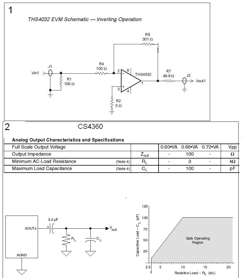

I am really fascinated by the sound of the THS4032 but my knowledge in electronics is not sufficient enough to implement it right in my DVD player. At the moment I have build exactly what you see in pic 1 for the DAC in pic 2 and it sounds already more detailed and clear than anything I had in my room, but I think that it is not ideal. Could you point me in the right direction or make a quick drawing on how to use it as I/V and buffer in my case?

Hi Radian,
the Vin1 is from ? Could it be the CS4360 is your source?
Why, then load the CS4360 with 50r to ground and 50r to virtual ground resulting in a combined loading of 25r when the datasheet says min load is 3k0?
The output impedance of the CS4360 is 100ohm. You would normally load that with about ten times this impedance say 1k0 but the datasheet over-rules this and says3k0 min.
What you have shown for load impedances is more akin to terminated transmission lines, with high current line drivers feeding them.
With the series resistor shown feeding into the virtual earth I do not think you also need the resistor to ground. Increase the feedback loop resistors to 10k and 3k3 to get your gain of -3.
If you do go with my lowest resistor values you will be limited to a maximum of 10pF stray capacitance. This may be difficult to achieve. Try higher value resistors to get you further of the capacitance scale.
Thanks Andrew for your reply,
Yes CS4360.
I do not have the 100Ohm R1 resistor in place. I just replaced the 3,3 uf coupling cap with Black Gate N and taped the signal at the solder point of the cap, took out the original opamp and left the remainig circuitry in place. The original Rload resistor of the player should still be connected to ground.
Do I understand you right that you would make R6 10k and R4 3,3k?
Is this the only stage you would use or do you think that an additional buffer is beneficial.

The CS4360 is voltage out, not current out. This means that you do not need an I/V converter, just a voltage follower with maybe a little gain to reach the desired output voltage. You better not use the THS4032 for that because this opamp is not stable at low gain settings. Better use AD797, but be sure to compensate it properly for parasitic capacitances, as suggested in the AD797 datasheet.

Hi Andrew,
I use the circuit as posted except for R1 that I left out since the player has a the 10k Rload resistor at that place.

Hi Klaus,
The THS4032 EVM circuit has 2 big problems:
1. it is inverting phase,
2. it has only 100 Ohms input impedance defined by R4, this loads the outputs of the CS way too much.
It is NOT suitable for voltage output DACs.
Solutions:
1. Use a normal non-inverting voltage amplifier circuit;
2. use higher value feedback resistors, like 22k and 10k for a voltage gain of 3. (in non-inverting opamp schemes the gain factor is 1+ the ratio of the 'series' R from output pin1 to inverting input pin2 and the 'parallel' R from pin 2 to ground).
Put a normal 10k resistor from non-inverting input pin1 to ground to define the ground reference for this input.
3 To increase stability at low gains check datasheets of NUGS opamps (NUGS = not-unity-gain-stable) for proper compensation techniques.
You will have even better sound from your work, because what you are doing now is certainly not OK.
Basic circuitry can be found anywhere on the net and in datasheets, like THS4032 page 24.
