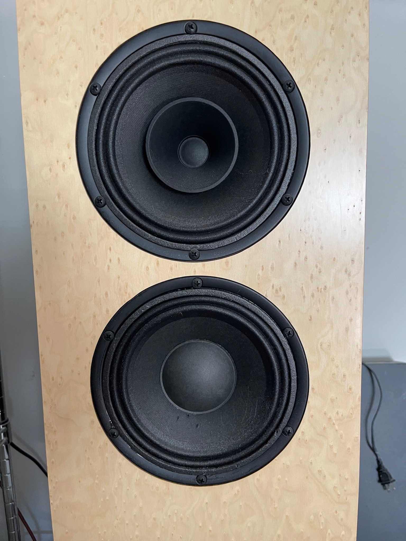

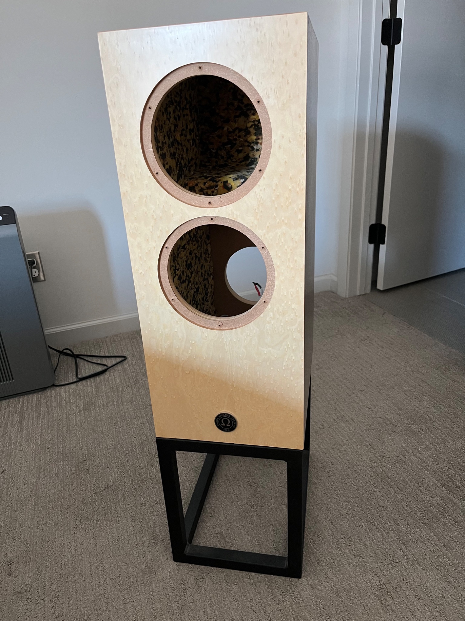

Is there an Alpair driver that might work well with Omega boxes?
I managed to fry the expensive AlNiCo drivers in one of my Omega "Super High Output Monitors." Eventually I'll probably order a set of drivers ($$$) to replace them, but meanwhile I have a question about whether any of the Mark Audio Alpair drivers might work in the cabinet. I would close the second opening occupied by the low frequency "helper" driver and run it full range, unless the blown helper driver turns out to be a good passive radiator (not likely, I know). I'm looking at the 11MS right now.
I think the volume of the cabinet is about 40 liters. The cabinet is treated internally with R compound.
Fool's errand? Fun and exciting adventure?

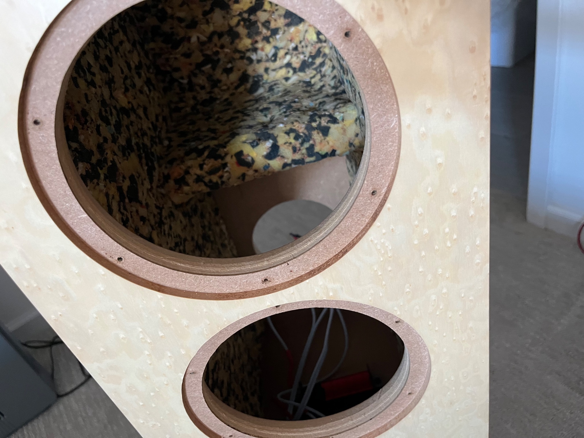

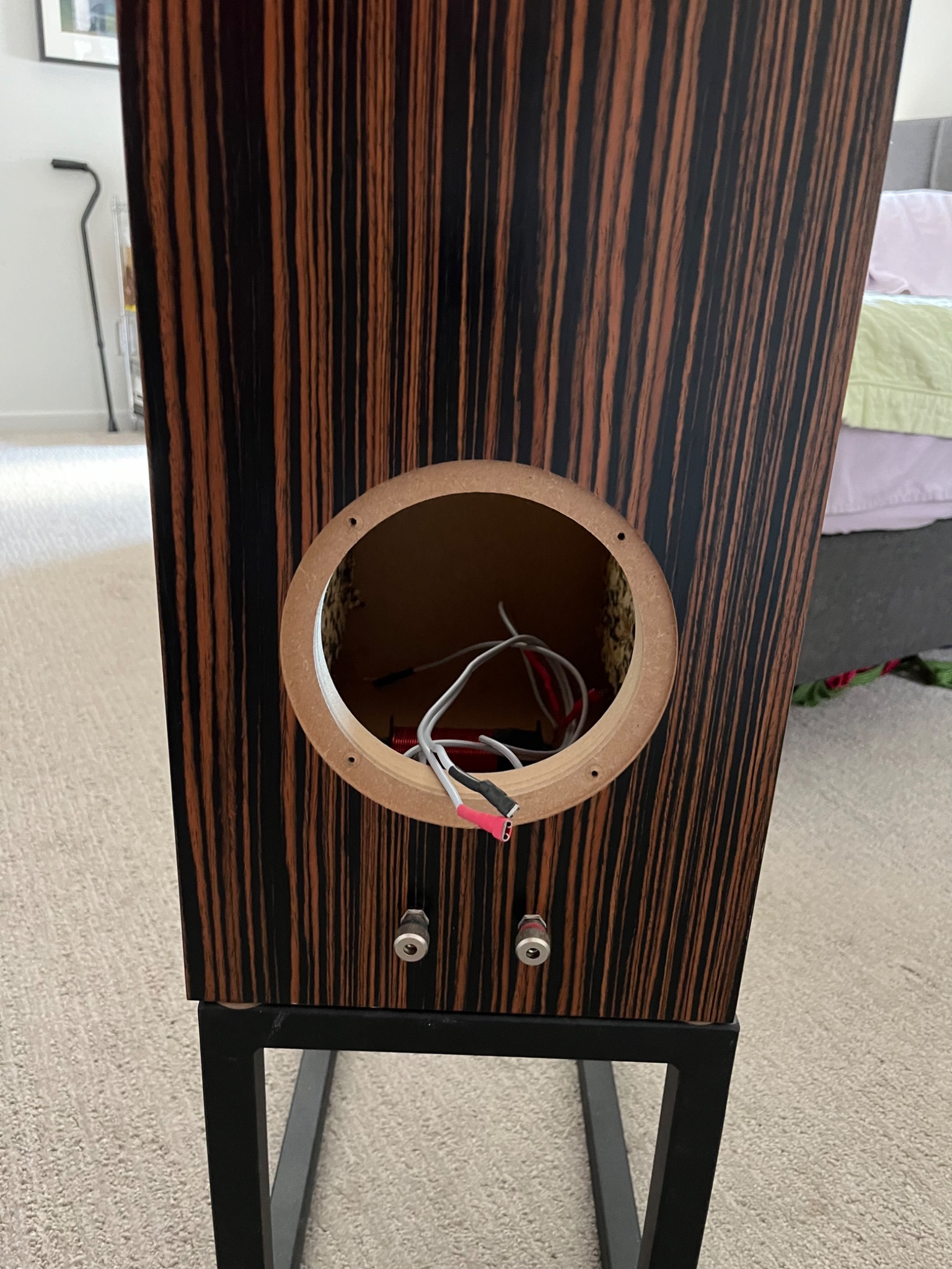

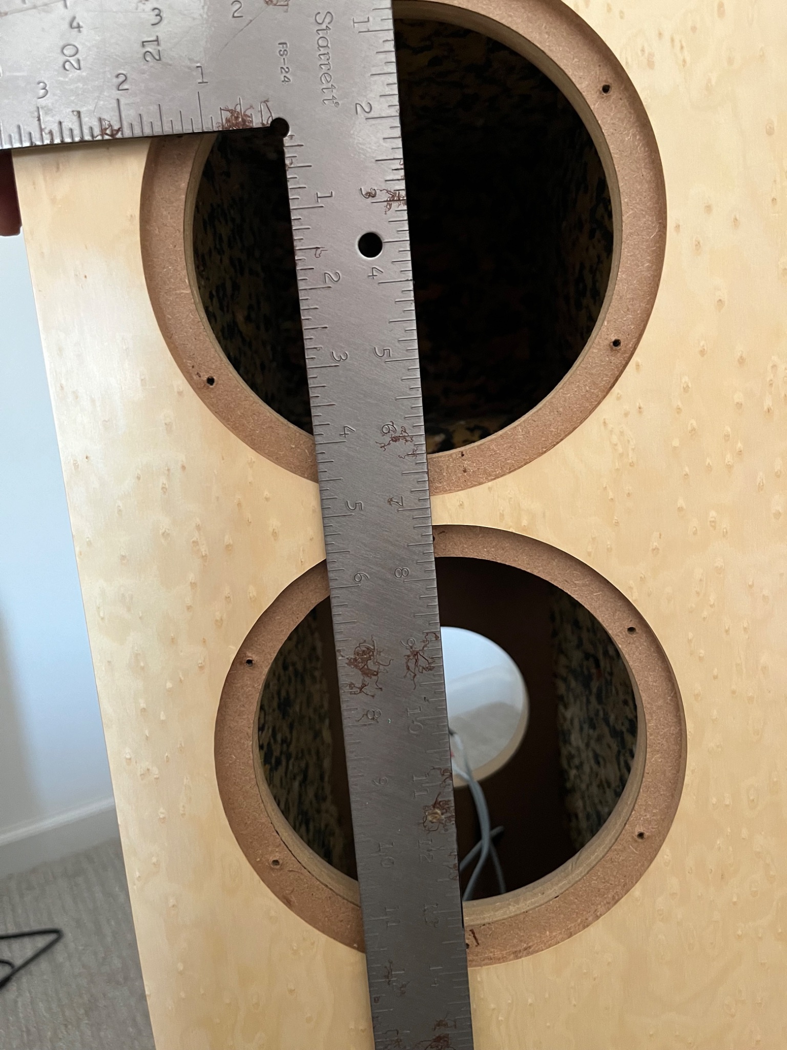

24"x10"x14" (61cmx25cmx36cm) external dimension. Rear port is flared from 3 to 6 inches. The cutouts for the drivers are about 6 inches. My putative plan is to block the lower driver opening and to use a full range driver on the top cutout. I will reinstall the ports.

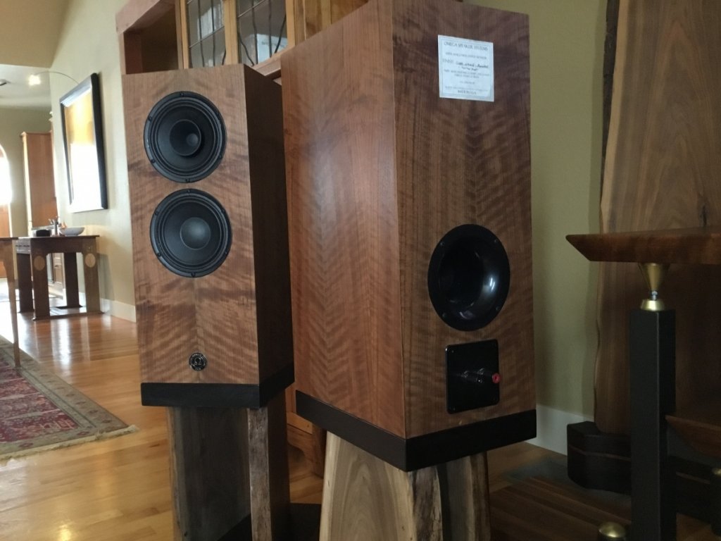

Dave,
Looks like 1 wideband, 1 helper woofer and a port at the back - pic that I found through Google search attached for your reference.

After a few days with the CHN-110's, I'm satisfied, as the drivers have exceeded my expectations. I thought they sounded a bit threadbare in the midrange, but after a few days, I guess they've either broken in enough or my ears have subconsciously compensated for their sound. I'll probably be happy with what I've got and just play music. I relegated the "helper" driver to function as an unconnected passive radiator.
I was surprised that my micro-powered LTA MZ2 preamp/headphone amp could drive them to decent levels in my room with a subwoofer. That's 1 watt per channel. About 75dB with the volume control at 2 o'clock, with Air's Moon Safari playing.
Now I have a single perfectly fine alnico full-range driver sitting on my shelf. Maybe I'll use it for a mono full-range open baffle.
