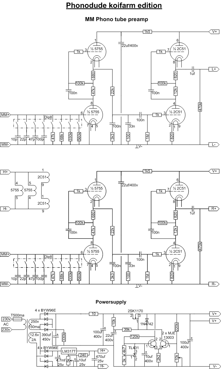

I also have phonodude, mini-me, just opamps, discrete fet phono preamps and project tube box se phono preamp.

MM tube amps with srpp first and second stages i have build before. For all tubes designs i like the phonodude.

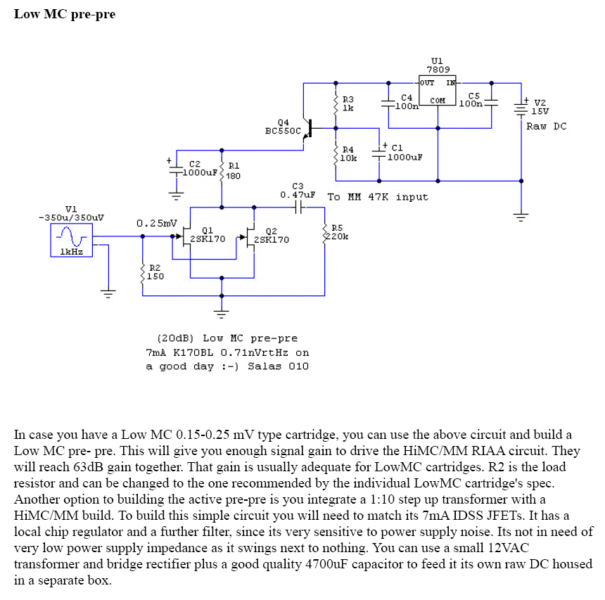

What about this with a MM tube Riaa after https://boozhoundlabs.com/products/bhl-audio-jfet-moving-coil-pre-preamp-phono-kit-2sk170
not tubes,but it´s simple anyway..

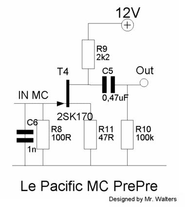

The pacific pre pre is also a good MC preamp. A lot of people have switched the SUT for a pacific pre pre.

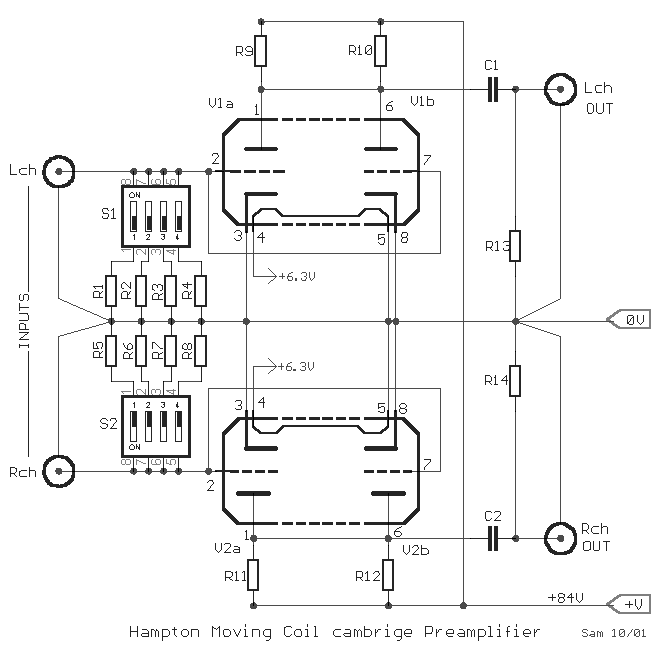

Interresting..If someone wants to try a tube mc pre, see schematic below.
I build that with ecc86(6gm8) tubes. double parallel 1k2 resistors at anode and 12v batterysupply. Had a good noise floor( -67db).
I still want to test the 6n28b-v for mc pre. Tube has very low microphonics. With the schematic i posted before and 48v of anode supply.Then there´s the 6N27P just a little cheaper.
