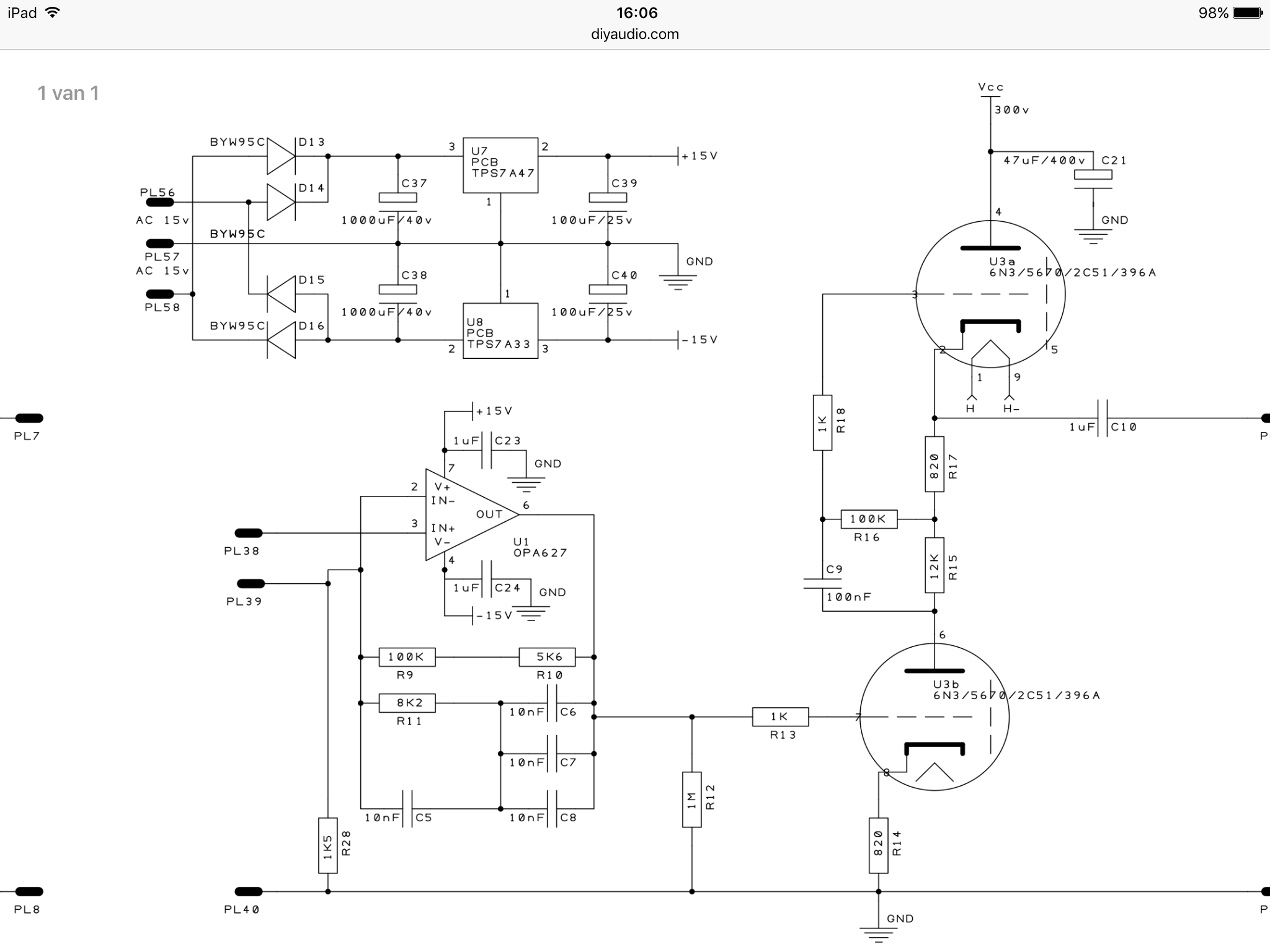

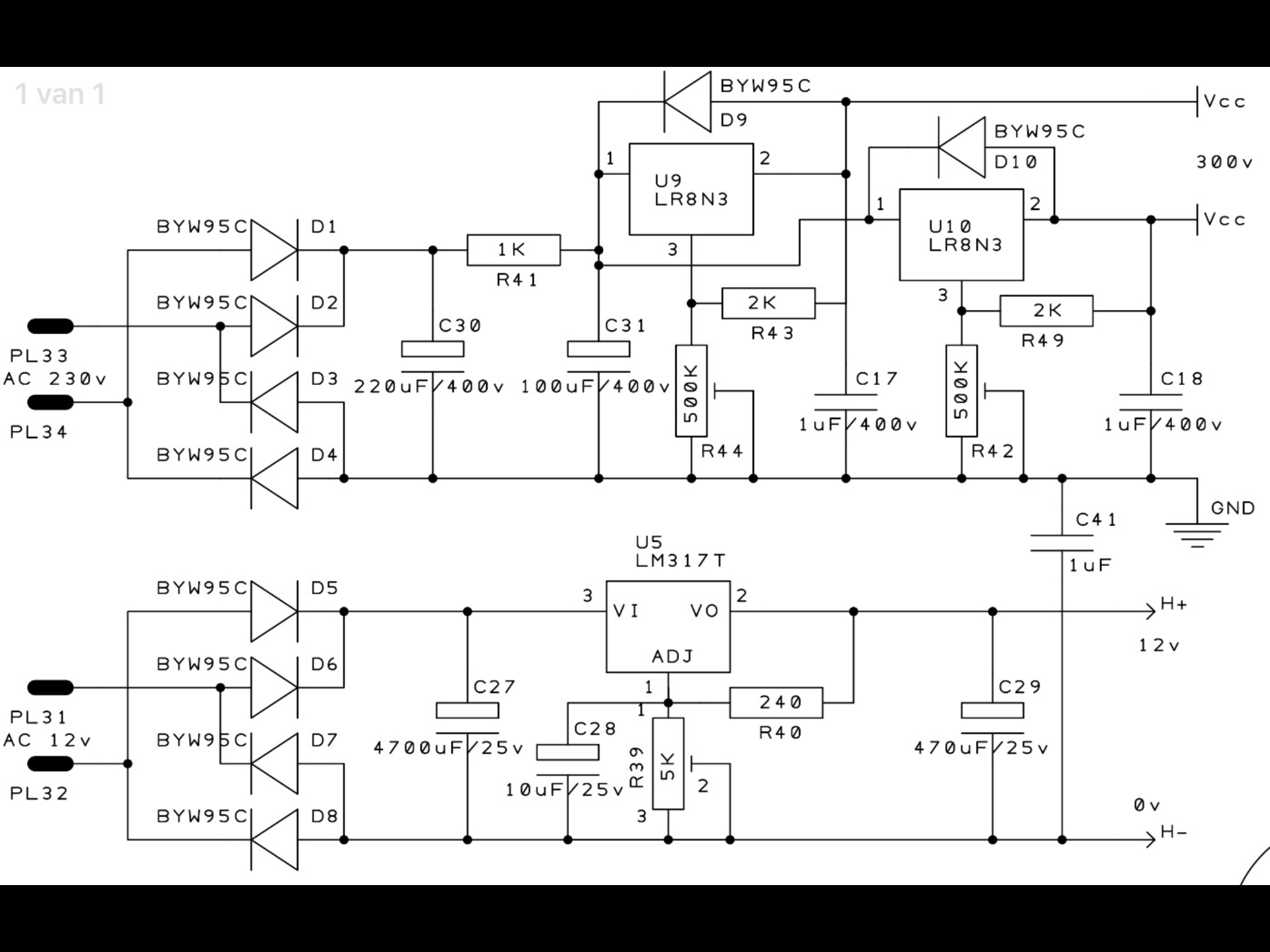

I use schematic below for mc phono amp.
Best of both worlds, low noise firststage and high headroom secondstage.
PL39 is for gain adjust with resistor to ground.
PL38 is input. you need to ad impedance circuit suitable for your cartridge.
Ronny
Ronny
