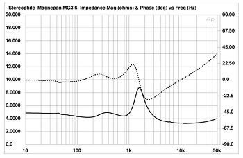

The Maggie true-ribbon is specced to 40khz. It is supposed to be a constant resistive load (of 2 ohms, for my version - 3 ohms for the later version) ... with perhaps some capacitance as well. No I've never seen an impedance plot for one.
Andy
Measurements from Stereophile
Sent from my iPhone using Tapatalk
Measurements from View attachment 600142 :
Marc, I'm afraid that is a resistance plot of a complete 3.6 speaker (including its passive XO). Not just the ribbon itself (with no other drivers and no passive XO components connected).
Andy
Andy
Aahh, I see what you're after now. Sorry.
