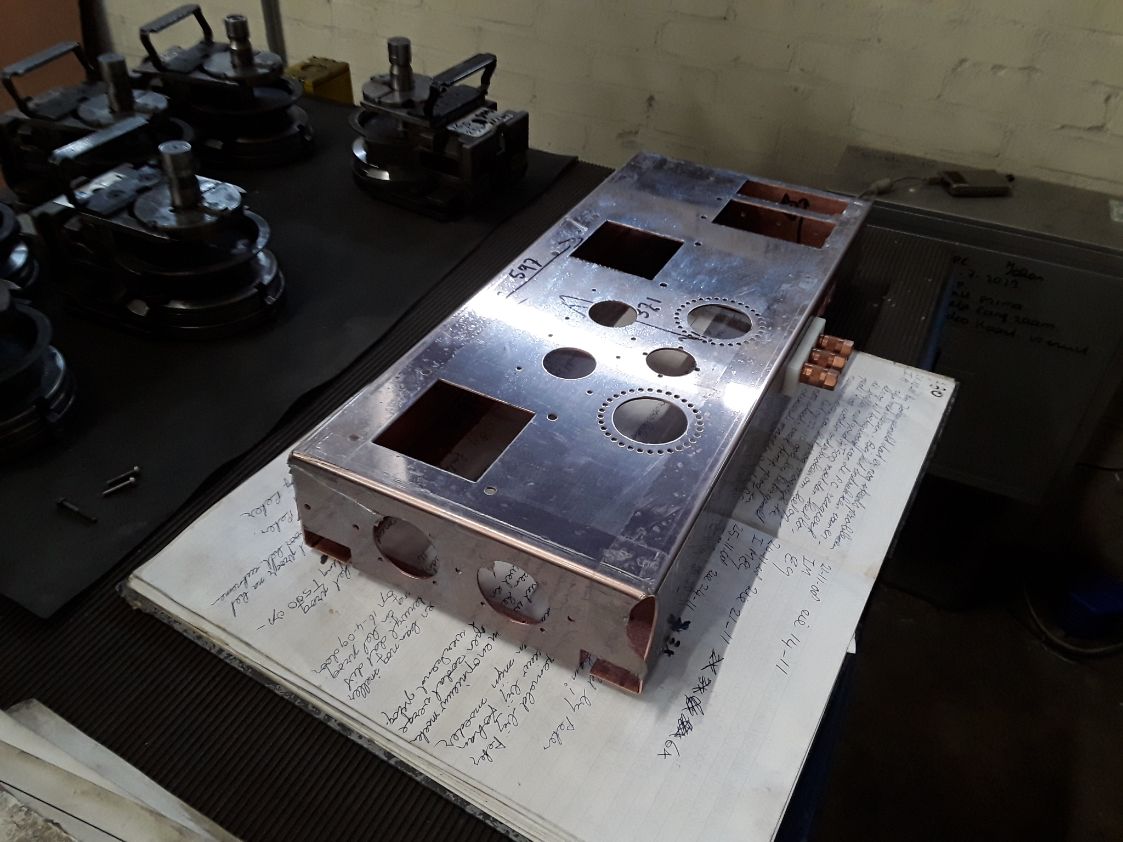

Hello,
I made some chassis from mirror like copper which i polish once a year or so with the product used for brass instruments. When i need to handle the chassis ( which very rarely happens) i use a kind of cotton mittens.
I added all the holes with CNC punching machine at work.
Greetings, eduard
P.s material comes with a plastic coating that is removed after machining.
