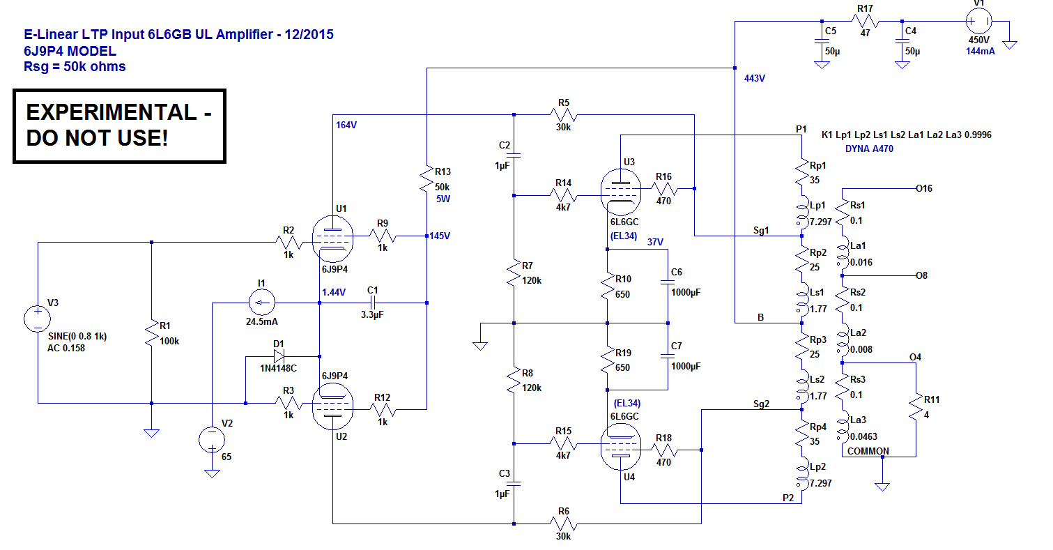

This evening, I've put in some time modeling E-Linear 6L6 amps instead of continuing to wire my other amp. It's been interesting.
Both models I ran use a Dyna A470 OPT model with two 6L6GC in UL config with B+ of 450V. The output stage has a 650 ohm cathode resistor for each 6L6, bypassed with 330uF. I haven't tried it with a shared cathode resistor yet.
Candidate Number One has an LTP made of two 6J9P pentodes.
Candidate Number Two has an LTP made of two 6P15P (or EL84) pentodes.
Interesting thing #1 is that if I give the screens a separate 150V supply without a resistive load in series, distortion goes way up. It seems the screens like a large value resistor there (different for each tube, but all are >50k). Even a 150V supply with a 2.2k load resistor before the screens doesn't work well. Why is that? And how would I implement a regulated screen supply? Regulated voltage straight to the two 1k screen stoppers and then to the screens (bypassed to cathode with 3uF or so)? Or does there need to be a large load resistor going to the screens?
Because of that weird finding with the 150V supply, all sims were done with a large value Rsg -- 50k for the 6J9P, 75k for the 6P15P. With those in place, simulated THD at 1W out is 0.02% or less (which is damn good!).
The 6P15P doesn't do very well with only 10mA plate current, so I raised it to 13mA, with about 2mA drawn by the screen grid. That helped quite a bit. Unfortunately, it means the total draw for two channels will be 290mA.
Interesting thing #2 is that the high power output waveform looks better with the 6P15P as the driver. The simulated maximum output power is 40W RMS at <= 0.5% THD(!!). The max power out is the same with the 6J9P as the driver, but the output waveform looks more jagged.
I wish it was possible to include four 6P15P or EL84 as the driver pairs, but I think the power transformer just won't support it. It's looking like it will have to be 6J9P for the LTP.
Does anyone know of a good 6J11P spice model? I don't know of one, and googling didn't find one.

- If C2 and C3 are 1uF or less, there's a peak in the bass response right about 10Hz. Increasing those to 2.2uF flattens out the peak and the circuit is -1dB at 4.5Hz. I think I'd put an input blocking cap to make the response -1dB at 20Hz. It's a tube amp, it can't make really low bass, so why stress the OPTs and cause extra IM distortion?

Pentode question -- What values are acceptable for the 6J9P screen stopper resistor? In the schematic from the previous post, those are R9 and R12. Is 10k way too large a value?
I'm finding that there's a lot of variance between these pentode models. So far I have two 6J9P models, an E180F model (Ayumi N.) and a 6688 (also Ayumi N.). The E180F and 6688 models aren't too far off from each other, but the two 6J9P models are a bit off the charts. In the same circuit, if I use 60k for R13 (Rsg in Doug's schematic), the 6688 and E180F models get me 135V to 145V on the screen. But the 6J9P models are way off. The 6J9P4 model (in the schematic from my last post) gives me 100V at the screen, the 6J9P5 model gives me 200V.
However, if I put in 10k screen stoppers (R9, R12), the 6J9P5 model gives me 165V there. That's still too high, but at least it's in the ballpark.
What will putting in 10k grid stoppers do, besides reducing gain?
Have you considered sacrificing a tiny bit of output power in order to use the EL83 as drivers ?
Gary Pimm explained to me once that g2 acts as a feedback element so adding a series resistor should reduce distortion at the price of a little gain. Also the 50K resistor is shared between the LTP which means that as pentode goes up in screen current the other goes down. This means that the current through the resistor should be virtually constant. I have applied similar values in some of my designs.

Have you considered sacrificing a tiny bit of output power in order to use EL83?
Actually, output power is slightly increased if i use EL83, I assume due to better drive at high levels than is possible from 6J9P. I'll need to decrease idle current through the 6L6's to make room for EL83's. That will increase distortion in the output stage, but that is where the feedback is, so maybe that will be OK. I'll have to run that through spice...
Yes, I have noticed that too, screen resistors introduce negative feedback. The problem with that in this design is that we do not want this effect, we need to have the high output impedance of a pentode.
In the LTspice sim, feeding 150V straight to the screens increases distortion by 10x as compared to a 430V supply with series resistor. Gain wasn't reduced by very much. I don't know why.
I run 6P15P in drivers with 4 mA current (triode mode). The best ever linear swing. SPICE models differ from the life.
Thanks for that insight. 4mA plate+screen current in triode mode? That's amazing that it works at all. I guess that's a hefty recommendation to go ahead and use the 6P15P with something like 9 or 10mA plate current. It looks like the votes are in and that's what I should try.
