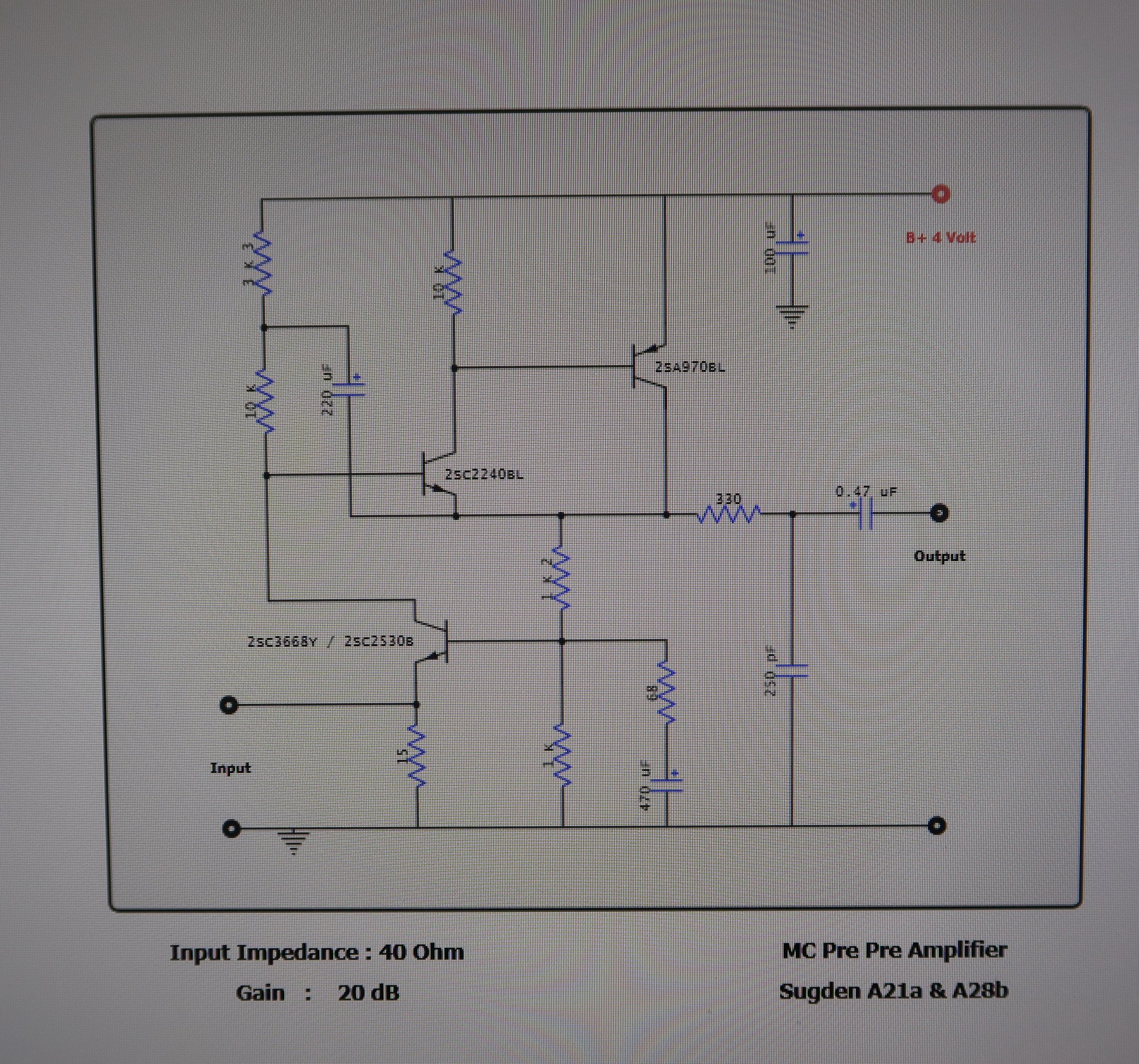

355F1 Member Joined 2008 2024-07-15 7:35 pm #1 2024-07-15 7:35 pm #1 I am trying to find out if the Sugden A28II has the same MC Preamp section as the A28B. HiFi Engine only has the A28B circuit diagram. Attachments IMG_5856.JPG 1.2 MB · Views: 76
