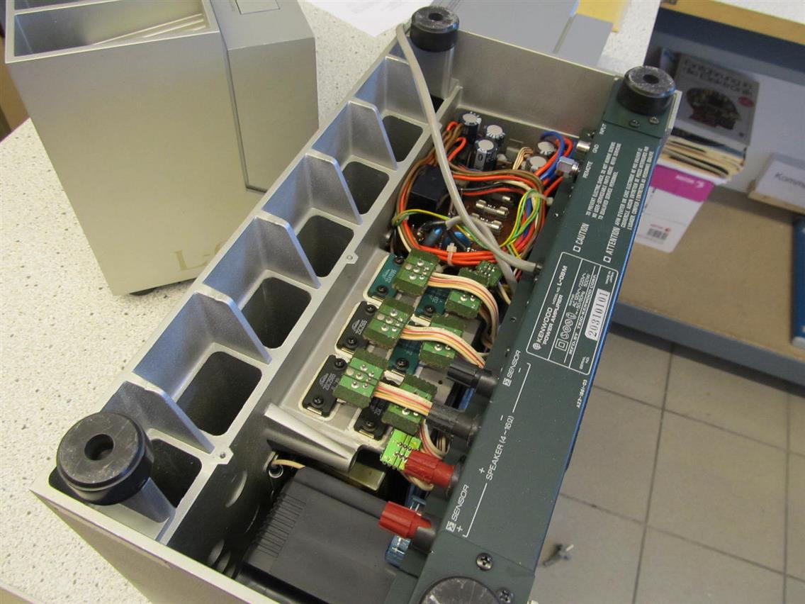

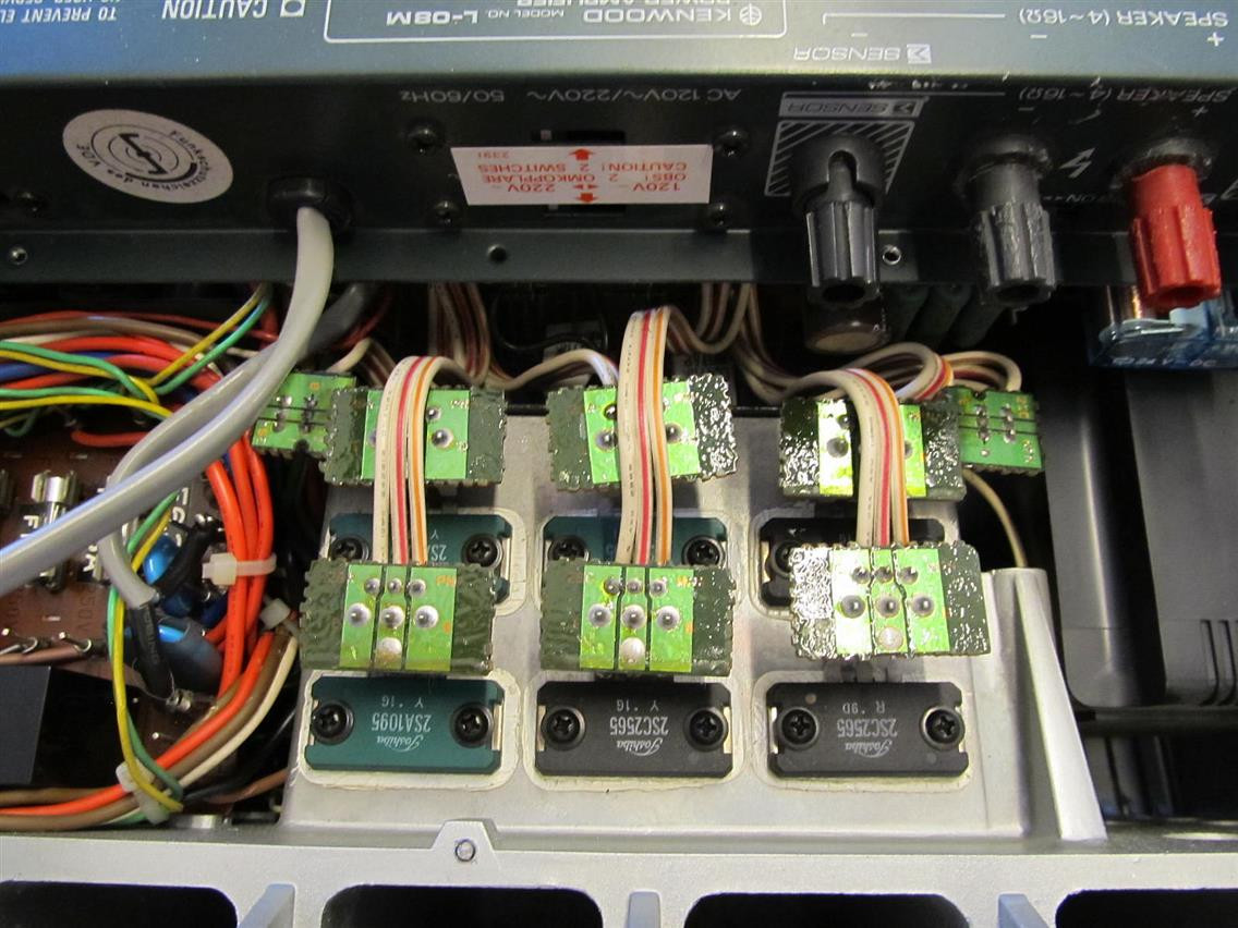

Here's one of three identically wired fastest audio amplifiers(200v/us) with 15 cm of wiring to the final transistors: 60 mhz FT(PNP) and 80 Mhz FT(npn ) final transistors...As someone said...what works for some, never work for others...
Kenwood L-08M on thevintageknob.org
