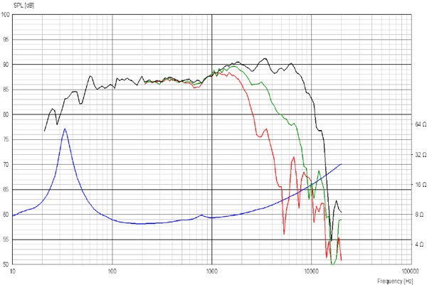

just my very humble intepretation of the datasheet: the cone starts severely breaking up below 500 Hz, also visible in impedance plot. that seems too close to your proposed crossover frequency.I’m all ears.
Not at all……only random musings presented so far…..I’m waiting for rational and evidence based responses as to pros or cons.So you want validation, not information.
A 4db blip at 450hz is ’severe’ cone breakup?…….some of the most revered 180mm midwoofers have this from the surround diffraction. Impedance plot shows a resonance at 550hz……i‘m not sure you folks are looking at the scale of the graph?just my very humble intepretation of the datasheet: the cone starts severely breaking up below 500 Hz, also visible in impedance plot. that seems too close to your proposed crossover frequency.
So, you don't know what does and doesn't represent a meaningful problem. A 4 dB "Blip" is an artifact driven by some issue in the driver, right in the midrange. You don't understand how this works, that much is obvious, but you're arguing with the answers that don't' validate your premise. "What do you mean about the surround?" "What's so different about those other drivers?" "What is Le(x) distortion?" would all be good questions if you were seeking knowledge, but instead you're arguing with the feedback you're getting, and you don't seem to have a good grasp of the basic TSP derived behaviours, much less how they interact in a practical sense.
Yes that's the start of much more severe breakup, just as I wrote. I remember the recommendation to stay at least one octave away from any breakup.A 4db blip at 450hz is ’severe’ cone breakup?
I don’t think your debating your points based on some woofer structureSo, you don't know what does and doesn't represent a meaningful problem. A 4 dB "Blip" is an artifact driven by some issue in the driver, right in the midrange. You don't understand how this works, that much is obvious, but you're arguing with the answers that don't' validate your premise. "What do you mean about the surround?" "What's so different about those other drivers?" "What is Le(x) distortion?" would all be good questions if you were seeking knowledge, but instead you're arguing with the feedback you're getting, and you don't seem to have a good grasp of the basic TSP derived behaviours, much less how they interact in a practical sense.
here’s a $300 Scanspeak highly regarded midwoofer with a 3/4db resonance blip SMACK at 1khz…..FAR more audible an egregious that would be down 24db from the fundamental at 400hz ( remember a 2nd order LP filter was mentioned)
there’s an accompanying resonance in the impedance plot.….but i suspect some of this is simple diffraction from the edge surround……and I suspect the UM15 is the same

What exactly is the point you're trying to make about resonances? Your resonances aren't going to be 24dB down they're right next to the gd XO. It's more likely to be spider resonances, IMO, but it doesn't really matter because you can't really do much to fix either apart from trial and error modding.I don’t think your debating your points based on some woofer structure

It’s you who make the assumption that somehow I’m less experienced……..bad call.What exactly is the point you're trying to make about resonances? Your resonances aren't going to be 24dB down they're right next to the gd XO. It's more likely to be spider resonances, IMO, but it doesn't really matter because you can't really do much to fix either apart from trial and error modding.
If the harmonics from the midtweeters are everything why even bother with woofers? Stop trying to be "right" and start trying to hear what more experienced people are saying. Those who have used them in this thread hated them. Those who have made a kajillion speakers think the resonances are an issue. Like I said, you came for validation not information. You thought you found some outlier that would overperform in an application it's not well suited for. Never mind the AE speakers as vastly better options, made for the application....
So acoustic rolloff from 100hz is roughly 3db/Oct…..considering a desired xo point of 400hz or so, we’d need to start an 2nd order electric at or near 100hz give or take. By 400hz we’ll be down 24db or so in the summed response……that 4db blip is now ‘maybe 2db’ with a passband of a quarter an octave….if that’s a deal breaker for experienced speaker designers, who’s kidding who here?
Maybe it was all just a typo?running 400hz on down
Not sure about 400 Hz crossover and being 24 dB down at the same time
If it's now a 100hz down thing, we're in a completely different conversation. That wasn't at all what was under discussion.
