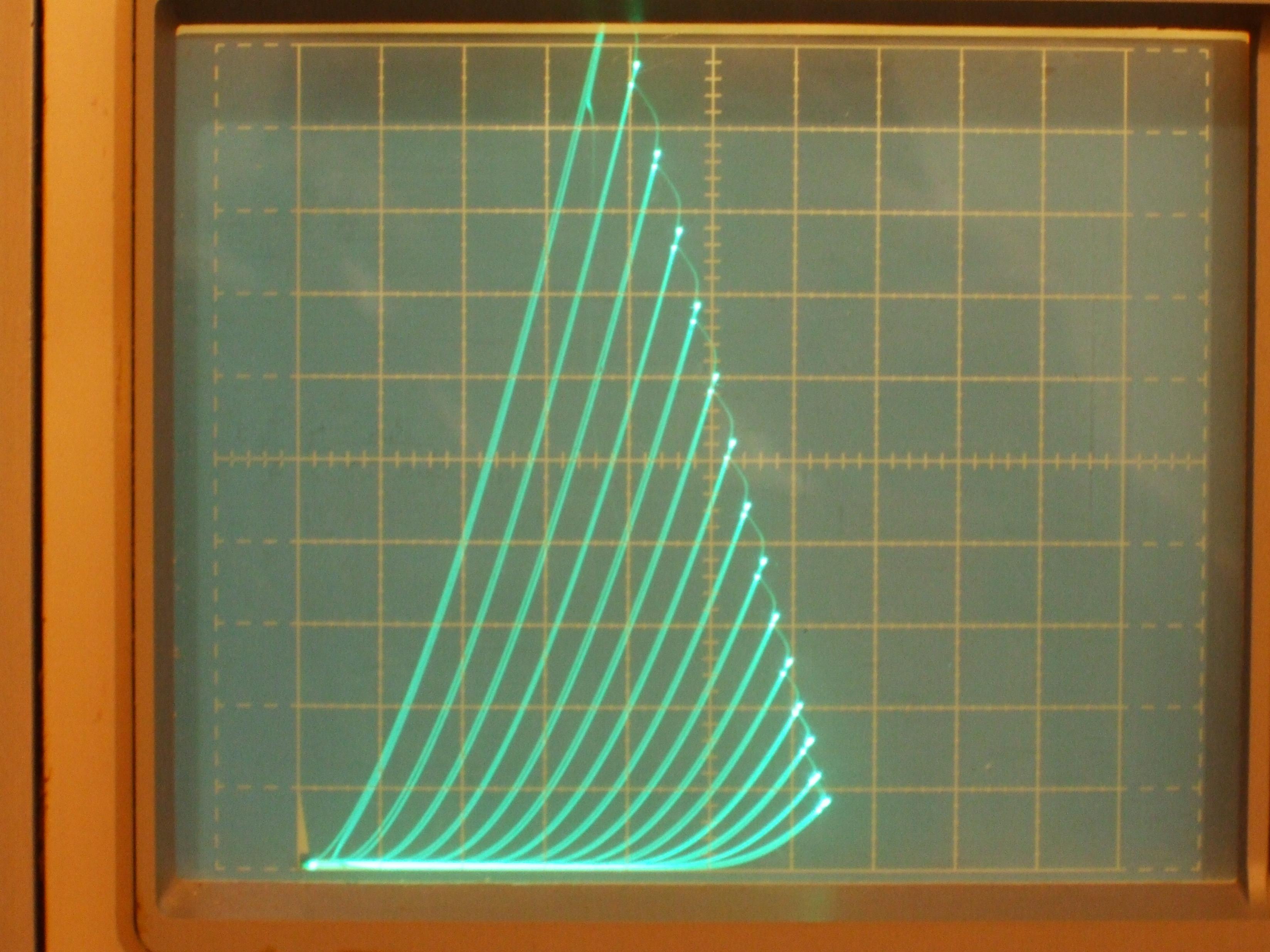

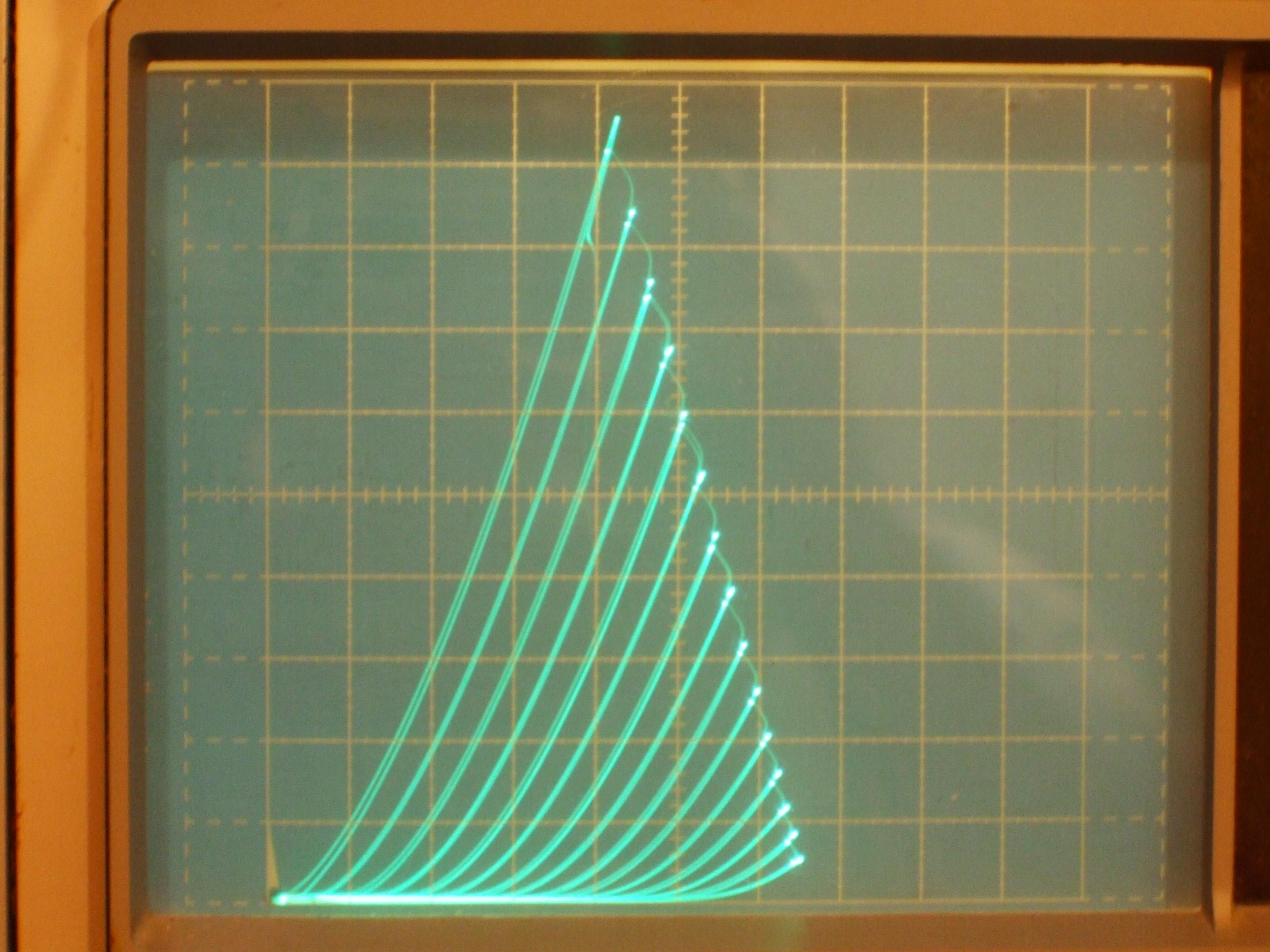

Got the curve tracer fixed today, so I did some curves for the 6888 tube.
All are at 20mA/div Vert. and 50V/div Horiz.
1) pentode mode, +150V on grid2, +24V on grid3 (to square up knees), -1V steps on grid1
2) pentode mode, +150V on grid2, +8V on grid3 (sorta constant gm on a load line), -1V steps on grid1
3) triode mode, +24V on grid3, -2.5V steps on grid1, grid 2 conn. to plate
4) triode mode, 0V on grid3, -2.5V steps on grid1, grid 2 conn. to plate
5) triode mode, -2.5V steps on grid 1, grid 2 and grid 3 conn. to plate
With +24V on grid 3 in pentode mode, the g2 screen current drops from 12mA to 6mA (over full scan), lowering g2 dissipation by 0.9 Watt (at 150V). Using the 4 to 1 rule for Sweep tubes, every Watt reduced on grid 2 allows 4 more Watts on the plate. So the tube could now be rated at 11.6 Watt plate diss.
These were all run with a 50 Watt load limit resistor in the tracer, 25 Watt average scan. I didn't see any red plating, but the tube sure smelled HOT.
The +8V on grid 3 (2nd pic) is interesting for keeping the curve spacing (gm) near constant over a large range except at the low current end where it would be over-lapped in P-P. Could be quite useful for class AB P-P linearity. Some investigation is in order here I think.
There are some 9 pin tubes with similar characteristics as the 6888, the 6LE8 and 9KC6.
9KC6 has a frame grid, and it hits around 36000 gm when the knees are squared up using +V (+10V to +13V) on grid 3. It appears to be a 12GN7/12HG7 with a dense grid 3 instead of the usual beam plate.

Minor correction to the above tube heat figure while on tracer.
A 50 Watt load R limiter would be averaging more like 1/3 that, or 16 Watts over a full scan, rather than the 25 Watt figure I gave above, when I mentioned the tube smelling hot.
(crudely integrating X^2 over 0 to 1 along the 45 degree diagonal, giving 1/3 X^3 or just 1/3 )
A similar integral occurring along any orthoganol line to the constant Watt hyperbolas.
But then there would be a factor of more area in the low power areas near the coordinate axis (due to orthogonals spreading out there), and then the sine wave 60Hz plate V would cause the tube to spend more time near the max power hyperbola (at sine wave peaks). Hopefully, roughly cancelling those effects.
A more complex double integral would be needed to get the fully accurate answer, with even more complication from the pentode knees avoiding the vertical axis, or the triode curves even more, and the extent of grid 1 stepping altering the approach to the 0 current axis. Not worth the effort, would vary for every curve trace setup. Then there is the offset adjustment on the stepping V too.
No, no, not going there......, approx. answer is 1/3 of limiter Watts. My nose says the hot tube was doing 16 Watts (but up-rated for 12 Watts and originally rated for 8 Watts)

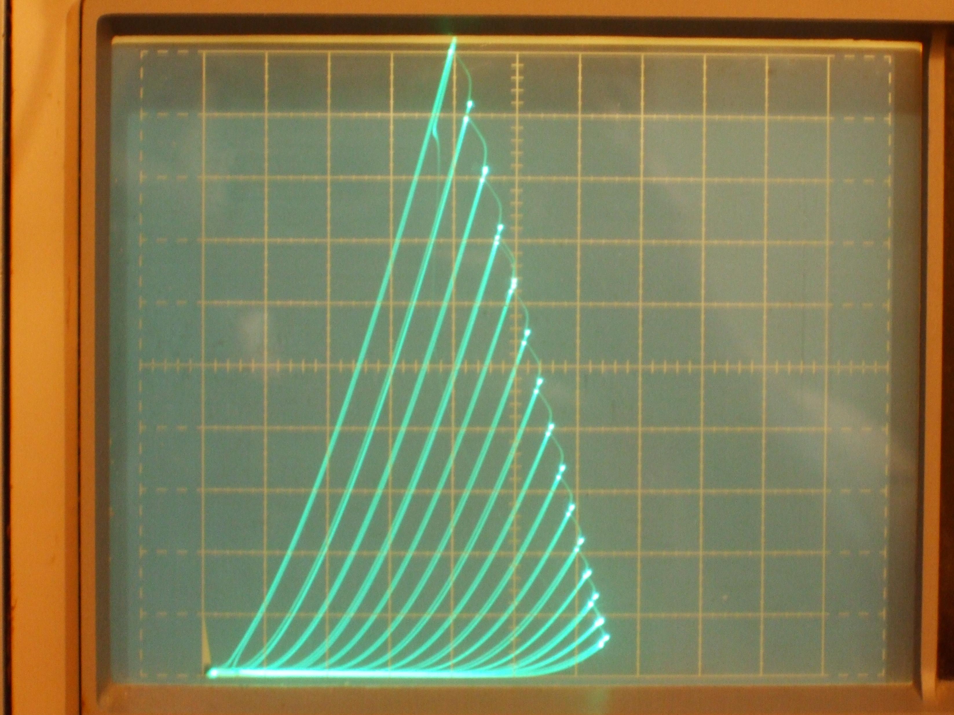

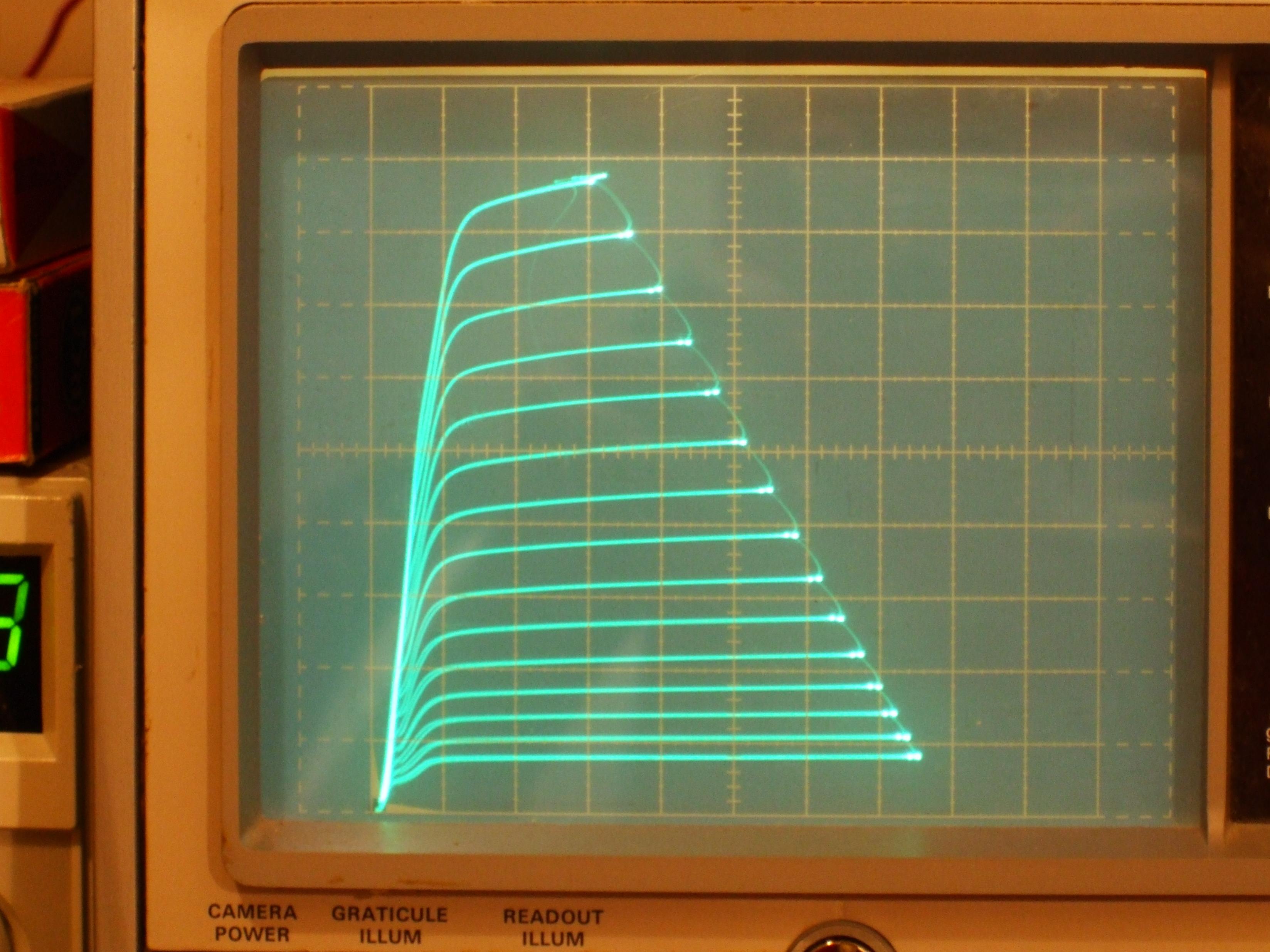

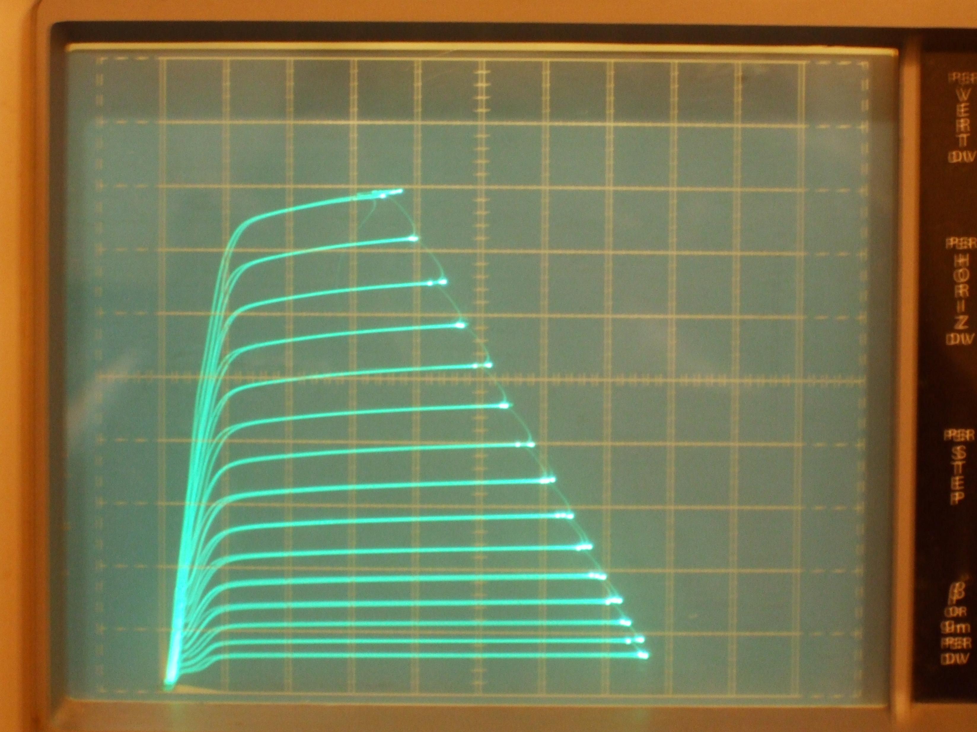

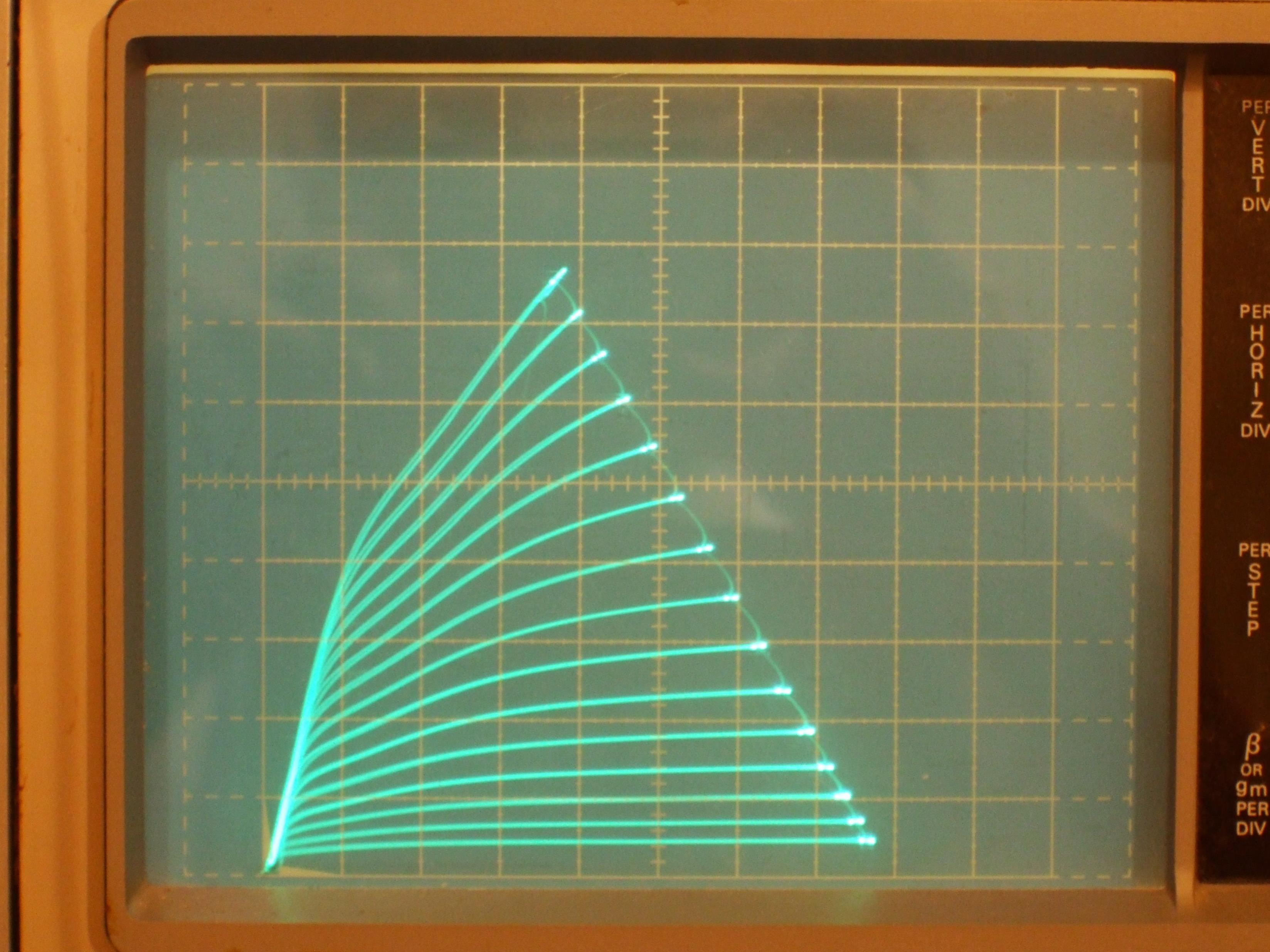

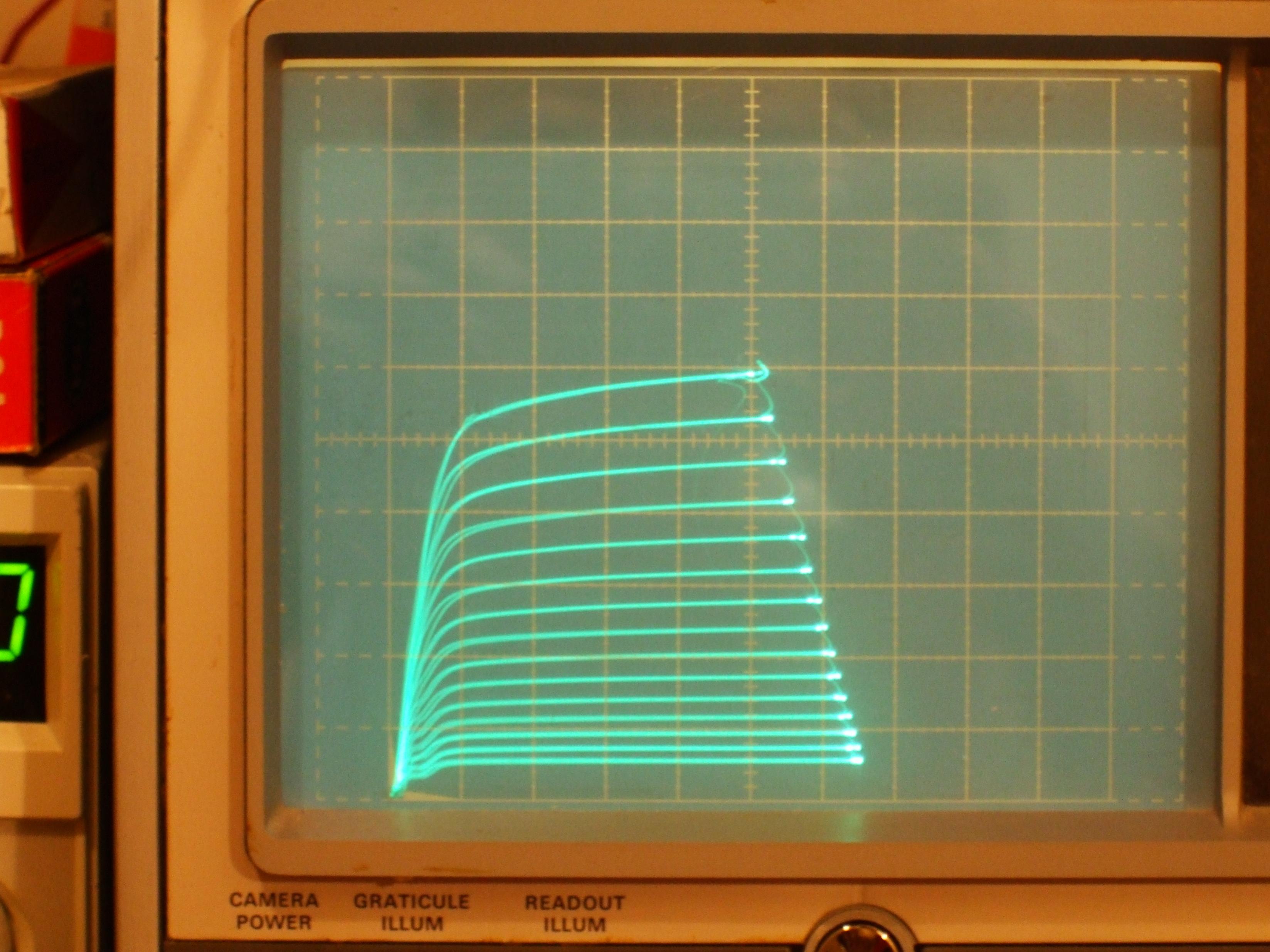

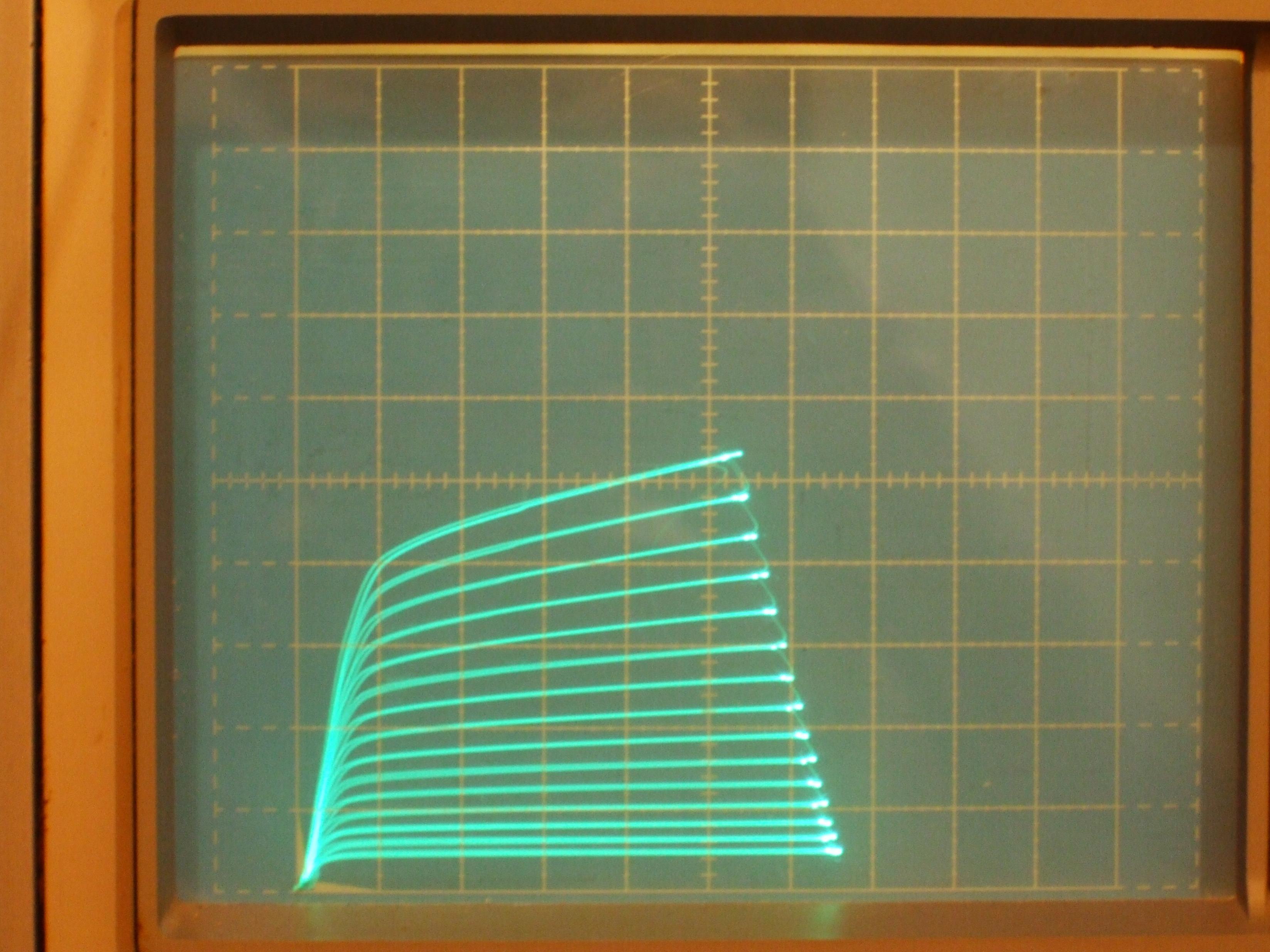

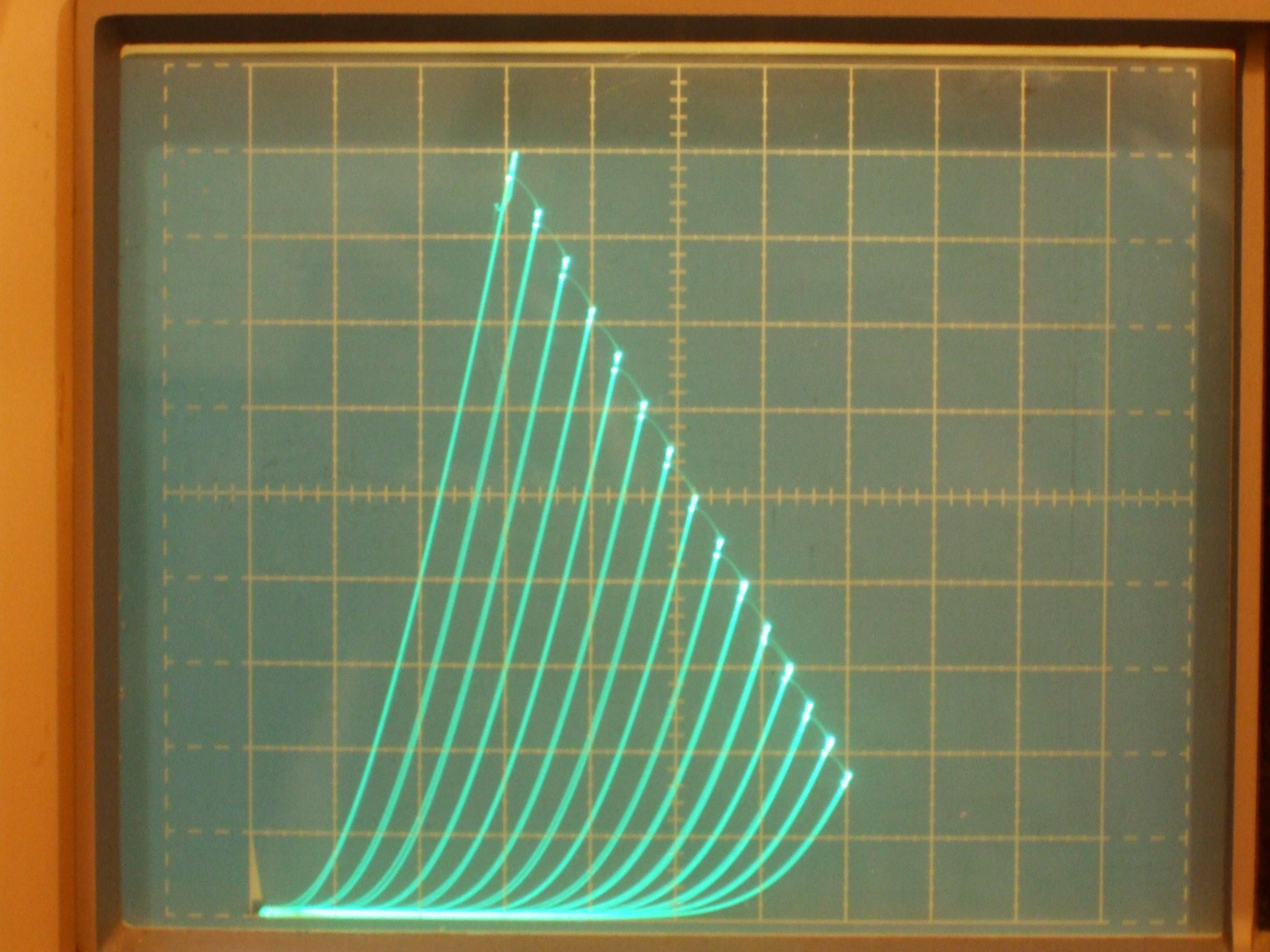

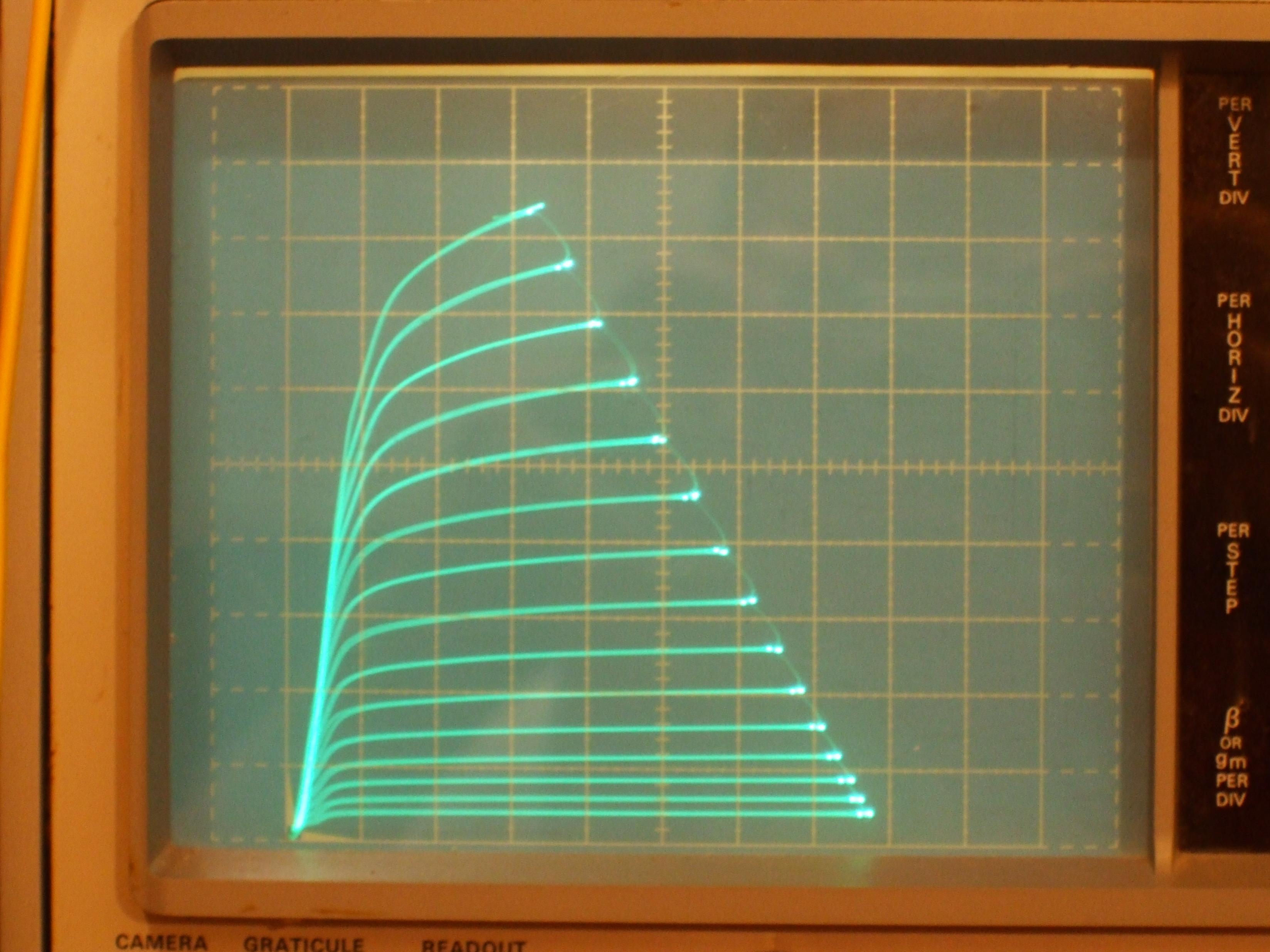

Here is a curve set for the 6888 with 0V on grid3. Then some curves for 9KC6 which is similar except high gm with a frame grid 1.
All are 10 mA/div Vert. and 50V/div Horiz.
1) 6888 with 0V on grid 3, -1.1V steps on grid 1, 150V on grid 2
2) 9KC6 with 0V on grid 3, -0.15V steps on grid 1, 150V on grid 2
3) 9KC6 with +24V on grid 3, -0.15V steps on grid 1, 150V on grid 2
4) 9KC6 in triode mode, 0V on grid 3, -0.4V steps on grid 1, grid 2 conn. to plate
5) 9KC6 pentode again, with +12V on grid 3, 0.17V steps on grid 1, 150V on grid 2
6) curve set 3) fixed
Around +12V on grid 3 for the 9KC6 in pentode gave something like the constant gm case with the 6888, but not as good.
These were all run with a 10 Watt load limiting resistor.
Oops. I just noticed that the grid 1 offset was not set at zero for the 3rd curve set. Top of curves should be about 1.25 div higher for 0 V at grid 1.
Fixed curve set 3) offset in 6)
