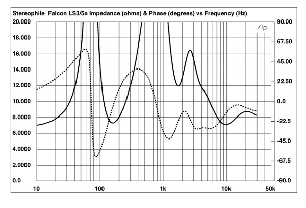

Think about the BBCs LS3 mini monitors where there were 15R and 16R versions; that I know about, there may have been others
15ohm for the early, 11ohm for the later. But as you say, as usual with nominal ratings, you can take that for what it's worth. This is the system impedance of the Falcon Gold Badge LS3/5a, which is essentially a brand new mid '70s 15ohm nominal LS3/5a:

I don't quite understand this. By definition, the DC resistance is the impedance at 0 Hz, and it will be quite close to the impedance at, for example, 1 Hz or 2 Hz. Does the IEC standard specify a limited frequency range?
Frequency range is where the music is - from 16 Hz to 20 kHz, i.e. where loudspeaker can work. Why would we need impedance at 2 Hz?
Minimum impedance is occurring above driver resonance (Fs) and, if vented, at the port tuning frequency (Fb).
