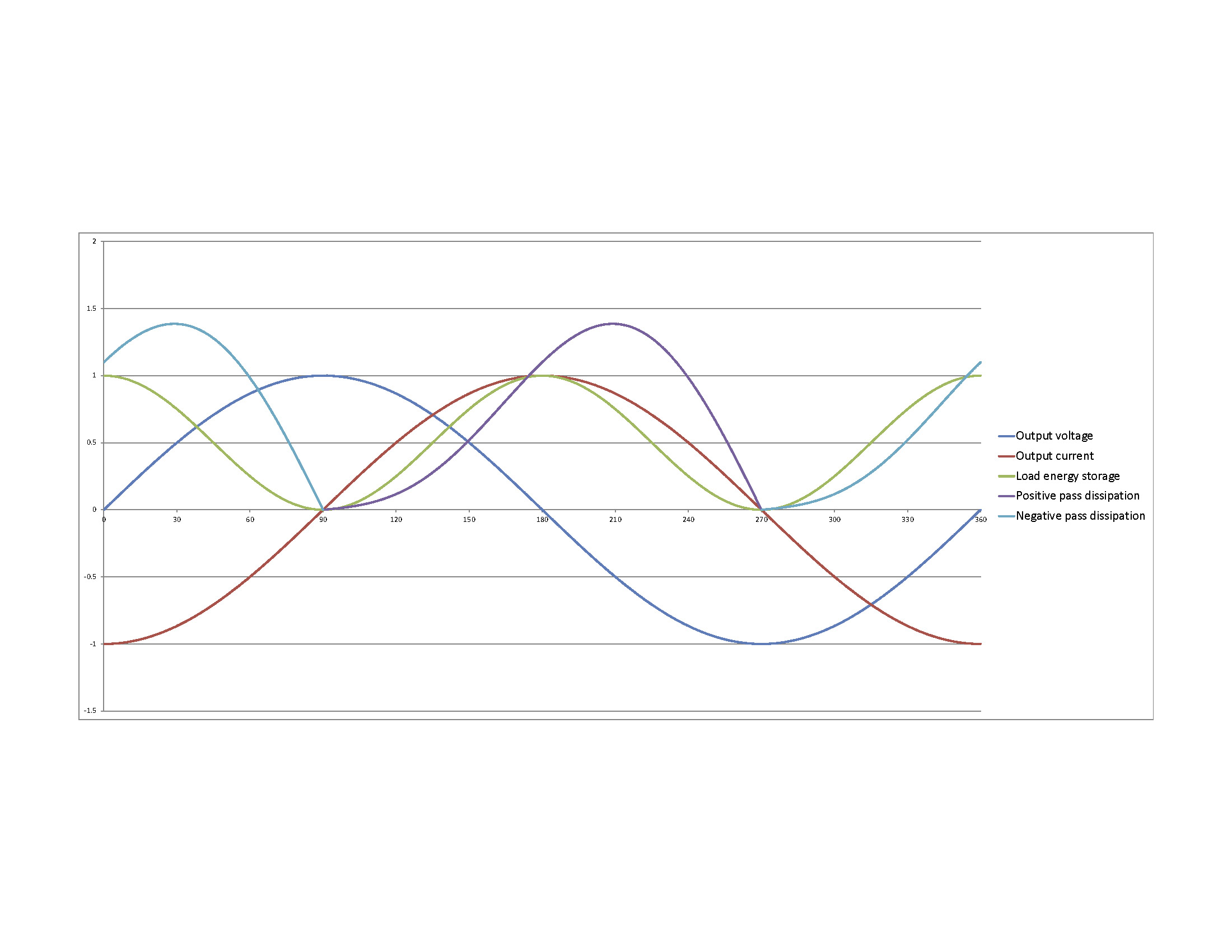

This is output stage dissipation when the load is a pure inductance. it's all normalized to 1 for simplicity of explanation.
Dark blue output voltage. Red is load current, 90 degrees lagging.
Major notes:
1. the peak pass dissipation is not during peak voltage nor peak current, but at 30 degrees in this example.
2. it is not zero when the output voltage is zero.
jn
Major notes:
jn
