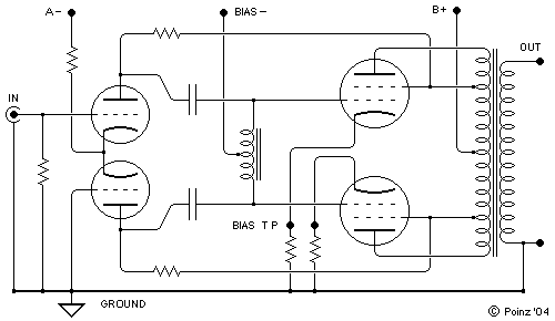

Hey-Hey!!!,
I will jump in with SY in a lot of ways. I have built a few PP amps, all with multigrid finals, all class A. I even discovered what I believe to be a new circuit. I named it E-Linear. It is a means of doing plate-to-grid feedback around the finals by attaching the diff amp driver plate loads to the U-L taps.
The PP amps have always sounded quite different from the SE amps I have compared them to. Power is small compared to AB1/high voltage designs, but power is not the goal. Power is a side effect.
regards,
Douglas
