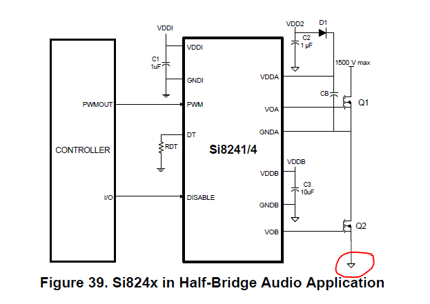

Im trying to build the eval board of si8244 which is basically a half bridge design. I want to drive subwoofers with it. Is there any issue with bus pumping which is usually observed in Half bridge design?

why not use single ended OPS with single supply in half bridge configuration?

We used 8244 in one of the products and eventually replaced this chip with 8234. Since precision deadtime does not bring any advantages, and we
faced the problem of the initial start of generation. 8244 charges bootstrap capacitor extremely poorly. Another feature is a fairly low output current. At 12V it will be about 1A. Gates 70nC are already a lot.
In general - using this driver for the subwoofer channel is quite strange. You will have to add quite specific current protection and, possibly, a discrete gate driver. Why not use IRS20957?
As you understand, the output stage and the driver do not really need the ground. If you need to tie input PWM to the negative bus, you can use the IRS20965S or add level shifter. And there is no difference in relation to the feedback circuit.
We have a project of an amplifier with a single-polar power supply and feedback after the ind., I posted the block diagram here, there is even a schematic diagram on other forums.
To operate the modulator, we used the simplest virtual ground circuit and a level shifter circuit on one transistor to control the output stage relative to Vcom.
