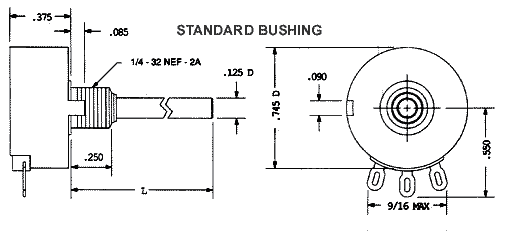

Incidentally, you don't have to make a professional engineering standard shaft extension to get good results. I've even used 1/4" dowel for the extension and an old pot. for the front panel brass shaft bushing. You can't pick it other than in a slight delay when switching. You will need to fit a plain hole knob with a set screw to any plain shaft though.

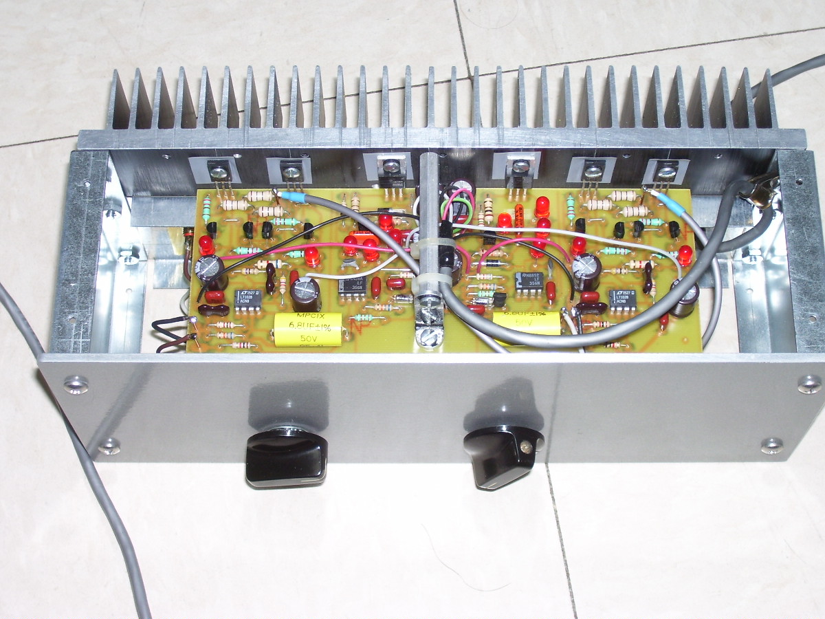

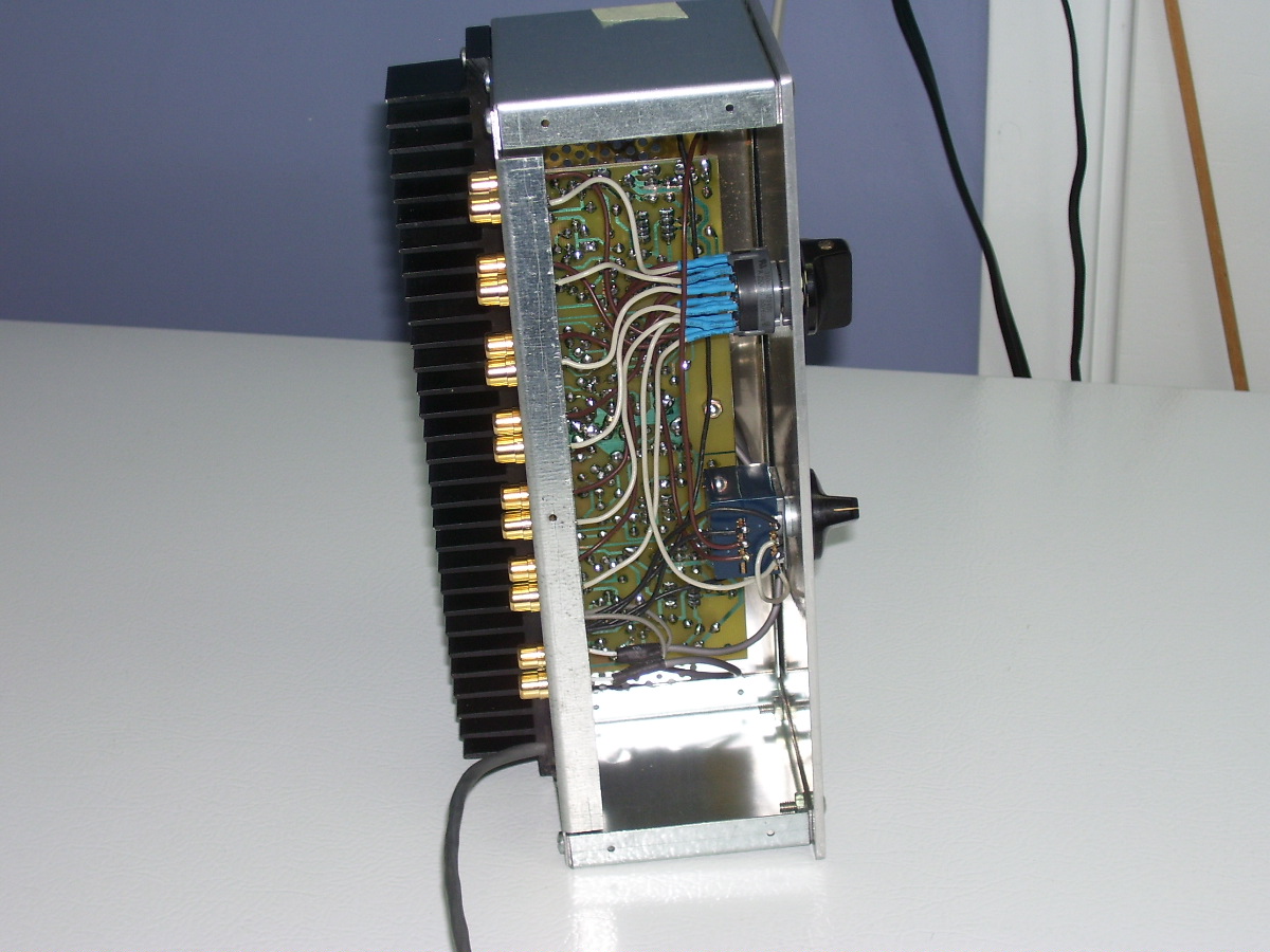

According to me it easier to put the switch close to the input ( one shaft extention and a few small parts ) .. otherwise you will have to use shielded wire from the back to the front panel and this need a lot more work .
An other option is shown below
