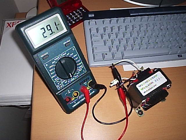

I am not sure how to measure this inductance and what all this really mean. I measure the secondary between V and center tap and it display 29.1mH when the multimeter set to measure L. See pic...The primary measured 1.22H if this mean anything?
Short the two primary leads together, then measure the secondary inductance. Then measure the capacitance between the primary and secondary windings.
The manufacturer's datasheet for the diodes will specify a capacity at a specific voltage. for the MUR860 it should be 100pF at 30V.

I shorted the primary and measured L between the secondary I read 2.91mH
I also shorted the primary as +ve and shorted teh secondary
as -ve and measured 68.2pf

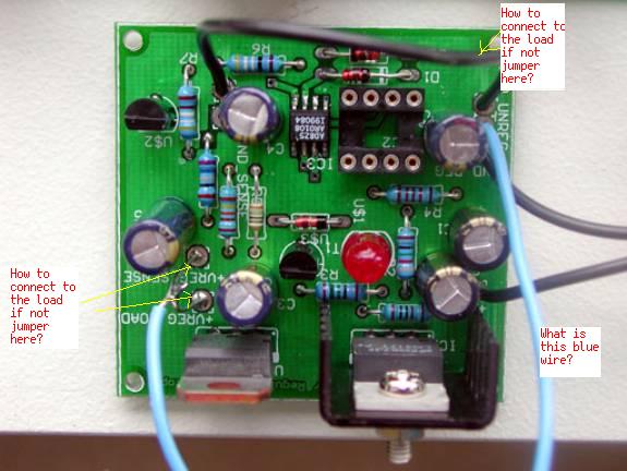

Onvinyl said:chris ma,
if you encounter problems how to stuff the regulator boards i could help you out with the circuit for that specific boards.
and the AD825: is there any dip8 replacement that provides similar performance?
Rüdiger

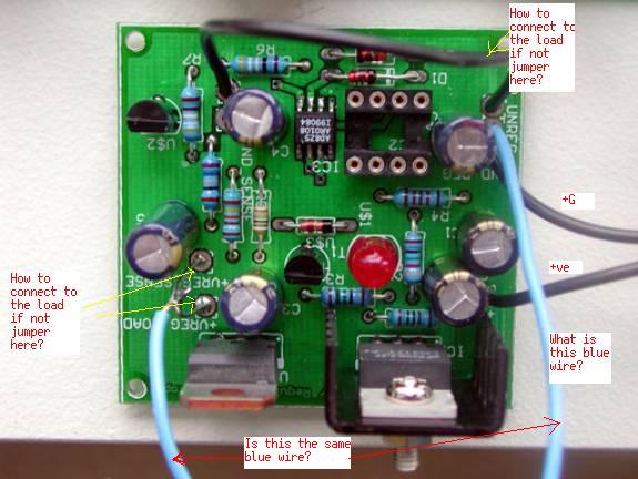

Do you mind sharing how do you connect to the regulators. I am yet to make those two jumper wires that I can see from picture on the AOS site. These jumper wires are not mentioned in the schematic. Is the +ve load means the output +ve to the phono stage?
Its best to connect the ve load and the vreg_sense direclty at the load. if you for what reasons ever choose not to do so, jumperwire it on the board.
hth,
Rüdiger
hth,
Rüdiger
Please post a picture of a positive board that you have. Post both sides so I can follow the traces.
BTW, have you read the description of the original article from AudioXpress/Audio Amateur as yet? It will provide much insight to what is going on.

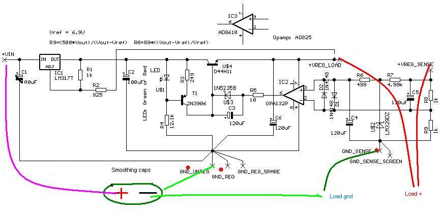

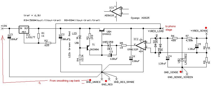

OK, it is confusing to someone who has not really understood what the heck the super reg is trying to do as yet since this regulator is unlike others you might have done before.
http://www.alw.audio.dsl.pipex.com/Manuals/ALWSR_rev2.9_Iss005s.pdf
Take some time tonite and read the assembly manual on connections.
When you connect everything up in a "local" sense fashion, you are turning the super reg configuration into a more conventional power regulator. The voltage is maintained and regulated UP TO the output of the board itself.
When you connect everything up in the REMOTE sense configuration, you are regulating UP TO WHERE the remote sense is connected. This way, any impedances along the connections to the powered circuit is compensated for by the feedback. In essence you are EXTENDING the actual regulator power circuit RIGHT UP TO WHERE the IC actually is.
Since you are going dual mono P2P on the phono, this will likely be right up to the IC power connection. (Don't forget decoupling caps for the IC)
If you read the link supplied you'll get a better understanding of this down around page 24 or so. Due to the high bandwidth, the remote sense is best done using shielded wire.
I can't be specific on the tracking connection since I don't know exactly how AOS has done this on the board. In other words I don't know if the tracking feedback is connected remotely of from the return on the regulator itself.
Figure 4 should shed some light

Good, you're on the right track. Keep leads as short as possible and remember the gnd sense screen is there for a reason. Hope it turns out well.
