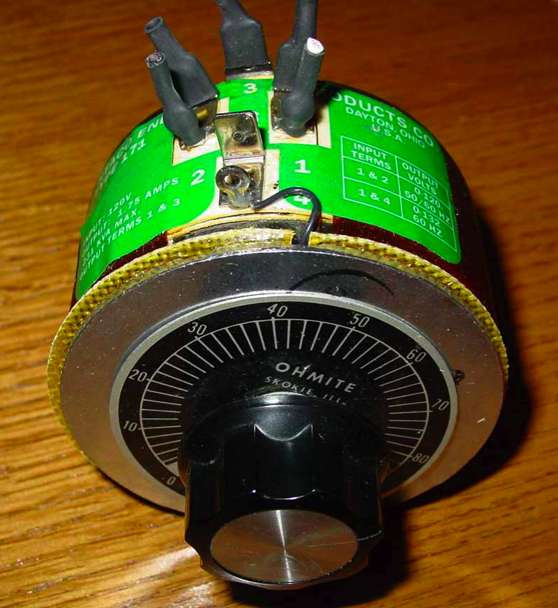

Hi Chris,
So what would the circuit look like to generate 500 volts? (Give or take because all of the instructions I read say the voltage accuracy is not critical, as long as it is less rather than more).
Can you draw (or describe) a block diagram? A schematic is going to mess with me. (Sorry). However, I'll take it anyway you can offer it. I bought a book on reading schematics, but haven't gotten it yet. What I really need is a constant reminder of what the symbols are. If I had that for reference at all times I'd be somewhat more competent to understand schematics.
I just bought a 0-130 volt variac for $5 bucks on ebay. This was *significantly* cheaper than everyone else, and it was a "Buy It Now" sale. The only down side was a lower output amperage than some of the others. This one has an output amperage of 1.75. That seems like enough for what I'm doing, (yes, no?). If not, I can resell it or use it for some other project.
I've attached a photo of it.

If I were in your position, I'd fit the NOS capacitors, then isolate the PSU from the rest of the amp. Power up, with a 15W lamp in series with the mains supply. The lamp will glow brightly at first, then dim as the caps charge. Switch on and off a couple of times until the dimming is smooth and fairly fast, then repeat with a larger lamp. Same again with a bigger one, by which time the caps should be reformed (or the lamps would have refused to dim, indicating U/S caps).
Reconnect the PSU, and repeat the process, listening for hum on the output - if there's much noise, switch off straight away :xeye:
Much quicker in practice than it sounds🙂
Whichever way you do it, make sure that there's a solid guard of some sort between the caps and you, check their temperature after each test, and discharge before handling:att'n:

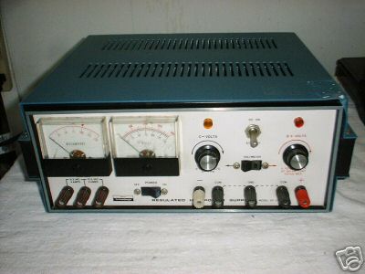

By the way, I won a Heathtkit SP-2717A Regulated HV Power Supply on ebay for $56 bucks (sold "as is" of course). I figure it is worth it for me to spend the extra cash on a DC regulated power supply, rather than messing with variacs and diodes and blowing stuff up because I really don't know what I'm doing with them. I've got the manual for it; (I found it posted online *prior* to bidding on it). So, just in case anything is wrong with it (or goes wrong with it), I will be able to repair it.
You guys have convinced me that "reforming" old stock high voltage capacitors is a must, so I might a well have the right equipment so I can feel confident that I am doing it competently. This is turning into a serious hobby for me. I am now on my fourth stereo repair and now it's in my blood again; (I used to mess with this stuff 25+ years ago). Like I said, I might as well have the equipment to do it right; (a tip I picked up from Chris).
Back to the main point: "Should I leave those last three caps (in that Twist Prong) alone, since everything is perfect? Or should I worry about them?"
(Ps... I've attached a photo of the Heathkit SP-2717A DC Power supply I just bought).

Hi Gregg,
Well, you pre-empted the post I was going to make.
Looks like a good supply, I use a Heathkit PS-3. I like rebuilding test gear too. I think it will serve you well.
Now to your question. Yes, I would reform those caps. If they reform well, just use them. If not, they need replacing. Look at Antique in Texas for replacements too. You can also hollow out the originals and put newer types inside. I guess you've reformed them by running the amps. Just check they aren't getting too warm (sign of leakage). Another sign is excessive voltage drop across the supply resistors.
