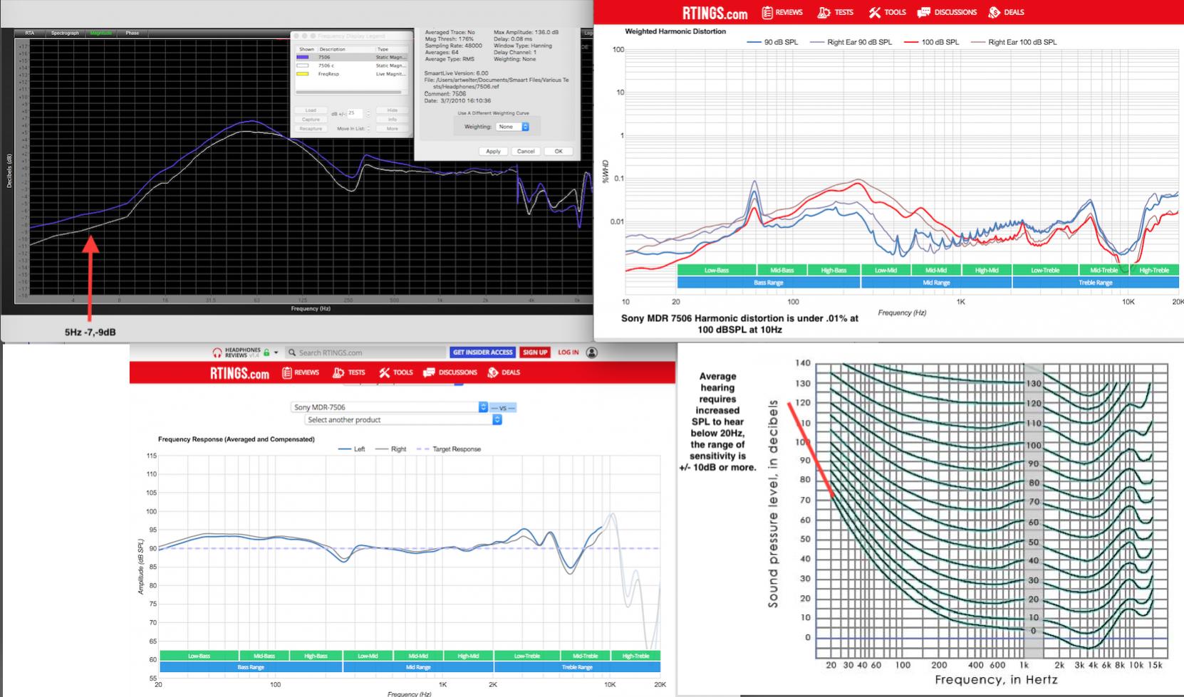

Having heard and measured harmonic distortion for over 30 years, I'm well aware of what harmonics sound like, and could easily hear the 10 and 15Hz harmonics when increasing level past detection of the 5Hz sine wave tone.
Attached are some current MDR-7506 frequency response and distortion measurements from RTINGS.com:
Headphones - 1.4 - Graph - RTINGS.com
and some of my own that extend below 20Hz from 11 years ago, using a Brüel & Kjær 4004 mic with a headphone coupling flange.
Response was -7 to -9dB at 5 Hz. The RTINGS.com distortion chart actually shows a downward trend in distortion below the 60Hz peak, distortion less than 0.01% at 100dB SPL.
The MDR-7506 are by no means the loudest low frequency phones around, but if you are looking for "feel" without neighbor complaints, still think bass shakers are the answer to the "quality" you seek.

The SMAART measurement posted used a microphone that is flat to 10Hz, the chart was included in the post.
The Sony MDF-7506 are capable of reproducing sound with very low distortion below 10Hz, as can be seen in the measurements you choose to dismiss.
I believe you and many others that may not be able to hear 5 Hz at "only" around 100dB SPL, but that does not change the fact that I can. Who knows, maybe I have elephant hearing genes ;^).
