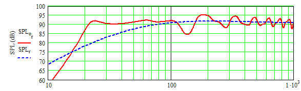

For instance, using the published specs, an 80 Hz XO, and a minimal amount of stuffing/voltage drop, a corner loaded ~13" i.d. square 136" long TL with the driver down ~41" from the closed end should suffice, though I seriously doubt there will be enough room gain to allow movies like WOTW to be experienced at DD/DTS reference levels.
I'm not familiar with what drivers you have easy access/$$ for, but if this cab is too large and/or doesn't meet your performance goals, then you will need to look for a true sub driver that has a <20 Hz Fs and extreme Xmax. That, or use multiple drivers to reach the desired SPL. For instance, multiple Peerless XLS12 (830500).

I did a simulation.
You can get 106db @ 20 Hz with 350w input
Vented box 80L tuned to 20 Hz
Rumble filter needed to protect driver for HT but above 20 Hz xmax won't be exceeded.
Some care would be needed in flaring the vents to avoid turbulence.
I would say this is adequate in a small to medium sized room to go with most hifi speakers, as they will struggle to go past 100db
You could always add on a second sub and then you could exceed 110db.
