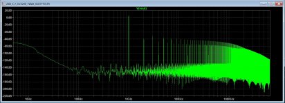

Not sure if it is entirely correct (I'm no spice guru), but I have run 2 spice sims on an existing design that runs off a single sided supply. One is run at 24v rails, the other at 48v. The output is 2.8vpk for both and well within spec output (i.e no clipping for either).
The 48v sims at 0.027% thd.
The 24v sims at 0.17% thd.
The only way to get the distortion under control on the lower voltage version is to change the design component values to achieve performance and stability. But then you have a different design, a different amp.

See picture to explain one side of Class D...
Unclear what decibel volume is in chart on the right. I assume THD is volume dependent.
So a 30W and 200W class D of same topology, at same volume, will have identical SQ?
=Yes
Amplifiers don't have any sound quality. The THD of an amplifier is not meaningful for perceived SQ.
Decibels is a ratio of two numbers in logarithmic scale, Dbv is not decibel volume.
Dbv = decibel-volts.
THD has nothing to do with volume knob turned up and down, or volume which means nothing, it has no unit in electricity. Volume of milk OK volume of sound? no.
The volume is a variable divider of the INPUT signal to the amplifier. It has no relationship with the output power.
In a THD chart you won't find any decibel volume.
The chart is made by Internal Rectifier to explain THD vs output power of a single signal in a defined load by a class D amplifier.
