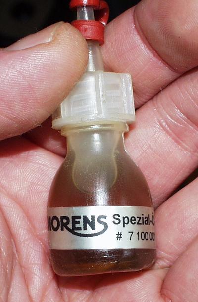

I've read many posts on various forums regarding oil for Thorens bearings.
Majority of posters recommended Mobil 1 car engine oil.
After some more searching, I discovered that Thorens recommended Caltex Regal Oil B is still produced and that it is now named Texaco Regal R&O 46. Alas, I can't find it my country.
Regal Oil is a turbine oil. Mobil has a very similar product called Mobil DTE but the smallest package you can buy is a 20-liter barrel and I guess that the same goes for Regal Oil...
So I listened to the advices here and bought the least viscous Mobil 1 that I could find. In my case, it is 0W-30.
The Mobil 1 I got:
0W-30's viscosity of 56 cst @ 40°C is close enough to Regal Oil's 43,7 cst. 10W-30 has 62 cst, 0W-40 has 80 cst...
0W-20 is ideal with 43 cst @ 40°C, but I saw on Mobil's web site that it is discontinued now...
Before I pour Mobil 1 in, I would like to hear some first hand experiences, good or bad.
My TT is TD126 MkI. It is in my possession for twenty years and I never changed its bearing oil.
My guess is that the bearing is doing just fine for now.
It makes no noises.
Without the belt and with the outer platter back in place, I spin it vigorously and it keeps spinning for full five minutes.
If you need a procedure that you can repeat yourself (your hand spinning can be different to mine), I measured that after the point that it slows down to 33.33 rpm, the platter needs around one minute and thirty seconds to completely stop.
I guess that it's not such a bad result.
So, what is the final verdict on Mobil 1?
Is there a consensus that it is 100% safe?
My main fear comes from the additives - can they damage the TD126's bearing?
Thanks,
Aleksandar

There is a product called LaVezzi HPO Oil that is available from many Cinema Equipment Dealers(like me... shameless plug, I know!). This oil is excellent and is used in lubricating the high precision intermittent mechanisms found in todays cinema projectors(some "intermittents" have tolerances of 1 micron!). LaVezzi also manufactures most of the parts used in these high precision mechanisms so they ought to know the oil end of the buisness too. My experinece with it has only been positive over the years, This is a synthetic oil with special additive which I highly favor. Yes, I have used it in my VPI HW-19 for may years!!
I would not use Mobil 1 for this purpose as it is a detergent type automotive synthetic. LaVezzi is available in 4 oz bottles for less than 10 bucks.

I use a 40 weight oil with no additives. This is for slow moving parts. The original oil in the Thorens bearings was reasonably heavy. Clean the old oil out first but don't use solvents.

When i used to have a TD125 (?) i used a product called "phil woods tenacious oil" from a bicycle shop it was diluted with another much thinner synthetic oil but i can not remember who made it(also came from bike store though). it worked very well.
Linn 'black' oil is available from Linn dealers in 'one shot' capsules (about 1ml) for a surprisingly small sum.
As Linn are originally precision engineers, I guess they have a fair knowledge of oils specs!
Is Mobil 1 oil 100% safe to use in my Thorens bearing?
Sorry that I can`t comment on Mobil oil or any other potentially replacement but why don`t You just order a small bottle of original Thorens bearing oil (#7100001)?
In 1997 I ordered a bottle (among a few other replacement parts) at Thorens directly.
Costs were DM 9,75 (Euro 5) and 10ml probably lasts a life time.
I know, Thorens meanwhile has closed it`s doors but I think it should be possible to order through the successor distribution company.
