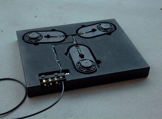

If it is true that the environmental vibration affects the amp sound, I would consider that an isolation of the chassis from the environment vibration (instead of isolation of the chips from the chassis) is the most probable treatment, applying pneumatic damping supports—e.g. http://www.newport.com/Support/Tutorials/Vibration_Control/v15.asp
Steve Eddy said:
... the stiffness increases as something on the order of the square of thickness.
No! Not on the order of t^2, but t^3.
jh6you said:If it is true that the environmental vibration affects the amp sound, I would consider that an isolation of the chassis from the environment vibration (instead of isolation of the chips from the chassis) is the most probable treatment, applying pneumatic damping supports—e.g. http://www.newport.com/Support/Tutorials/Vibration_Control/v15.asp
I'm using this pneumatic table top from Newport. Although it isolates the chassis from the stand, the construction details of chassis are important anyway. By that I mean if you use different material for spikes between chassis and the table, you will hear it😉

Steve Eddy said:
That could work with big flexible panels. But don't see it working too well with the tiny chassis that are more typical of Gainclones. Because the panels will be much smaller, they'll also be much stiffer which means their resonant frequency will be higher which means it will require adding quite a lot more mass to get the resonant frequency well below 20Hz.

So, is it better to get the resonant frequency below 20 Hz or go as high as you can, above 20K Hz? Or just don't worry about it and damp it?
Ideally getting resonance below 20Hz would be the best seeing as above resonance, you actually begin to isolate. But I don't see that it would be practical to get the chassis resonance down that low. Which is why I suggested previously coupling the chip/heatsink to the chassis via something which does have a resonant frequency below 20Hz. This would be easily doable with something as simple as some coil springs.
I have to say that the two GC chassis I built were quite different. The aluminum was a massive one with 3/4" bars and 1/8" tubing. It is still dependant on the placement, and spikes and double acrylic platforms improve the sound somewhat.
If you want to deal with structure-borne vibration, try the same thing here. Try some simple coil springs. Get the resonance as far below 20Hz as you can and make sure it's as resonant as possible (i.e. as little damping as possible).
