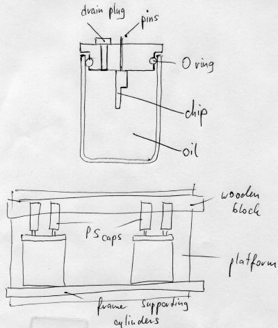

Peter Daniel said:There are possible advantages to this approach of heat dissipation, mainly better damping and avoiding vibration pick up from the chassis.
How would it avoid picking up vibration from the chassis?

The coupling between chip module and the cylinder containing the fluid would have to be soft (rubber, foam or something similar).

So you mean the chip amp in fluid in some soft container in some cylinder?

Here's some rough idea. The cylinder can be done out of copper tubing used for plumbing (maybe 2" dia). The bottom can be soldered, as there are copper caps available. The lid on top could be machined out of acrylic, with a groove for O-ring. The O-ring both seals the cylinder and isolates the acrylic lid from cylinder, as most vibrations will be picked up here. All I have to figure out, is how to keep the lid attached to the cylinder. The drain plug is there to assure that the cylinder is filled in full. In case better heat transfer from the chip is required, I can always attach to it additional copper plate.
The chip goes from the bottom through the lid, so I could even use a small PCB on top to hold few parts and 2 filter capacitors. The size of a cylinder has to be large enough to dissipate enough heat from the oil.
Actually, if I use wooden block to hold 2 pairs of caps (like my polycarbonate block in Amp-1) on one side and something to hold the cylinders on the other side and common platform for everything, I have a self supporting assembly, which also takes care of the lids attachment to the cylinders.
If I put all this together in a nice package, it may be the L'AMP😉

Mmmm. Still don't see a whole lot of isolation there. At least not any more than if you'd mounted the chip to a heatsink and simply isolated the heatsink from the chassis.

If you want to do something a little wilder (OK, a lot wilder), consider bonding a piezo film to the chip and using it actively to cancel out vibration. This can be combined with the fluid immersion idea, since piezo film couples very, very well to fluids with specific gravity near one.

The heatsink actually is a chassis in my amp. I can only isolate it from the supporting platform, and I hear a difference when I'm using spikes or rubber pucks. The platform itself affects the sound. So with this design I'm aiming at something that is not placement dependant.
I'm not sure myself how this would work out, but in my proposal the heatsink is actually in a liquid state (oil). The regular heatsing is a piece of metal. I imagine that the sound from a chip might be different in both instances. I'm only afraid, if the oil version wouldn't be sounding too slow and damped, without enough top end extension. OTOH, I shouldn't worry about "liquidity" of the sound😉
