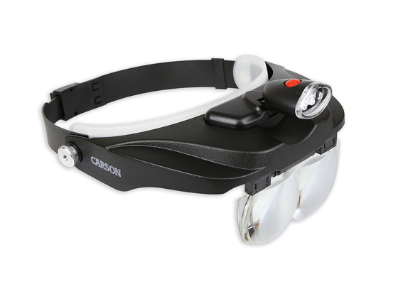

For delicate jobs I am using this:
Thanks for the recommendation, a piece is already on the way 🙂
