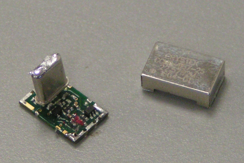

Next we have some nice, low jitter masterclocks, the audio clocks. These are going to be used for our DAC timing signal …. somehow. But these will also receive EMI and the datasheet phase noise specs go down the drain.
This audio clock is either a multiple of 44.1 KHz or 48 KHz. So we basically require two audio clocks.
We could go for 22.5792 MHz and 24.576 MHz for example. The XMOS determines the incoming sample rate and selects the correct audio clock by means of a SEL signal. The XMOS produces interference too and the I/O pin enabling the masterclock output dumps this noise on the sensitive oscillator circuits through the clock buffer. The audio clock is not so clean annymore ….

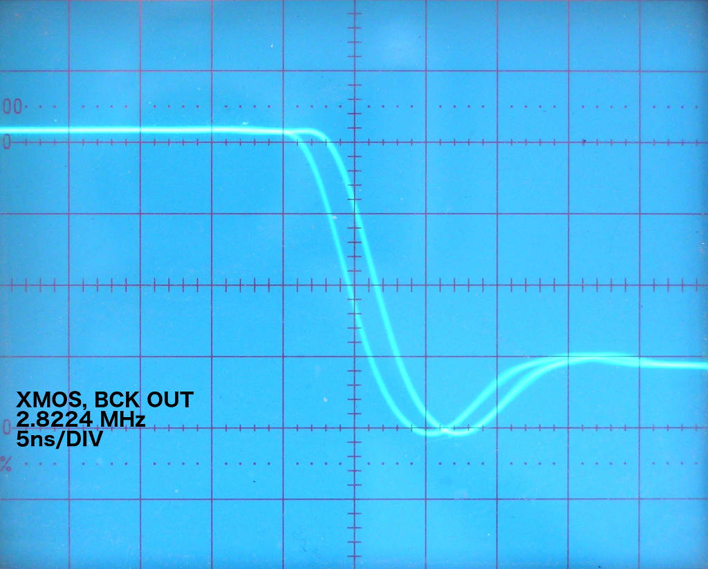

When we use these XMOS I2S output signals directly, we are rewarded by a truckload of jitter. Similar happens when using I2S outputs of a RaspBerrie pie for driving a DAC. If you want to have truckloads of jitter (timing) and interference (ripple) on the I2S signals, plus a nice ground loop, this is the way to do it.
This jitter is so severe that when generating a S/PDIF signal with the XMOS USB audio receiver, the connected S/PDIF receiver won’t even lock. So we are not talking about neglible jitter here as it causes data corruption with S/PDIF.

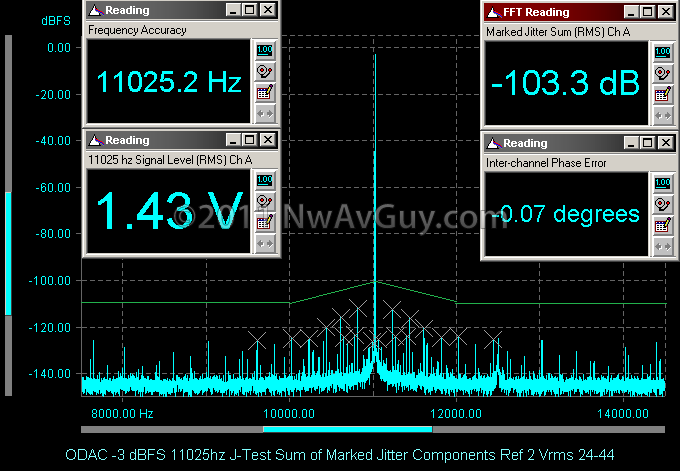

Lots of words and no data. Care to back up all that conjecture with a graph or two?
Attached is the jitter performance of the Original ODAC from NwAvGuy. Care to point out where all the audible horrors are?

I attached an oscillogram. It shows the BCK signal at the XMOS asynchronous USB receiver I2S output pin. Time division setting 5ns/div. Everyone who has an XMOS USB receiver can verify this, measure directly on the XMOS output pin.
Like I said the difference between multiples of the 13 MHz system clock and the 22.5792 MHz audio clock results in heavy jitter. Here it is approx. 2 sub divisions or 2ns or 2000ps peak to peak. I would call this very high jitter as I stated in my post and here is an oscillogram to back this up.
I recently bought these CCHD-597 ultra low phase noise masterclocks based on datasheet specs.
http://www.crystek.com/crystal/spec-sheets/clock/cchd-957.pdf
After several failed attempts with two of these clocks to achieve low jitter and related high sound quality with it, I decided to find out why this clock performed so badly and opened it.
Inside is a plain crystal oscillator based on this NAND gate:
https://www.fairchildsemi.com/datasheets/NC/NC7S00.pdf
With this output buffer:
https://www.fairchildsemi.com/datasheets/NC/NC7SP126.pdf
There isn’t even a ferrite bead or some kind of power supply filter inside, just a dirt cheap oscillator that probably doesn’t cost more than a dollar on parts.
So much for graphs.

Good. Please prove it. We await with interest. I posted the jitter spectrum of the non async, USB powered ODAC for your comments as well.
