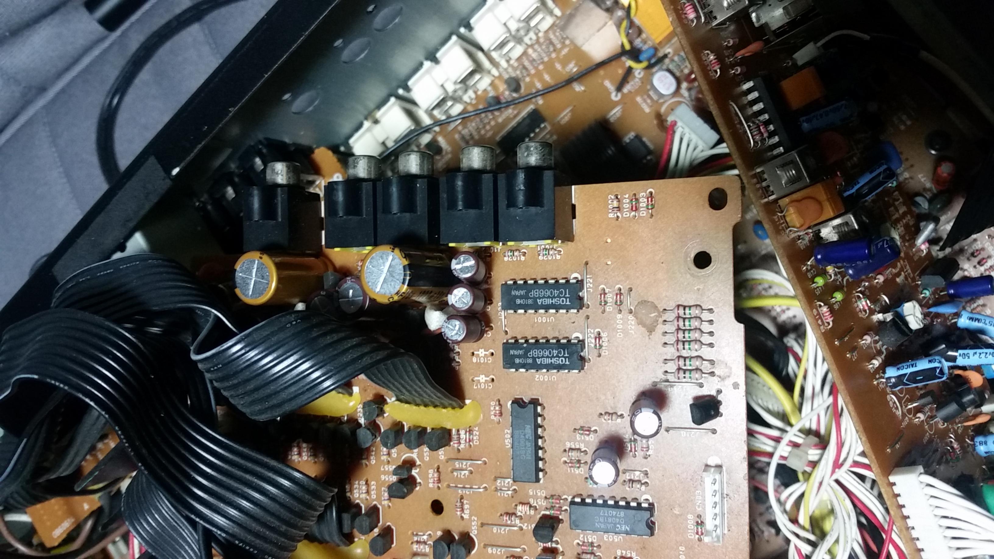

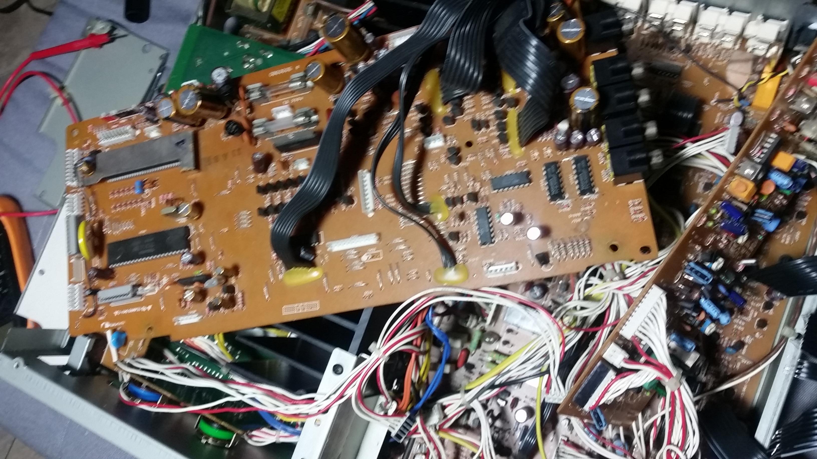

I bought panasonic general purpose from digikey.
So recaped everything it works.
But the initial problem is still there.
If amp is left unplugged or turned off for at least 15 min then when I turn it on there is a moderate click or pop.
This only happens when speaker set A is used. Also while waiting for relay to click you can hear very low volume music. And then after relay clicks it's normal sound.
Also when speskers are in A. When I switch front knob to select speakers B. Speakers in A are still playing. They should turn off.
Basically speakers A play all the time. Regardless of speaker selector position.
When speakers are in speakers B. Everything is normal. No low volume music before repay clicks. When u switch to A speakers B turn off like u would expect

Sounds odd at face value. We would have to see the circuit and how the relays are configured but it sounds unusual. Speaker relays usually place a direct disconnect in the speaker feed.

sounds like leakage, clean the speaker selector switches well with de-oxit....

I cleaned speaker selectors. They are twist type selectors.. also speakers A are on even before DC relay clicks.. I tend to think it's man made . Ebay purchase..I may be wrong of course.
I'll work on getting circuits.
It seems like it's a power amp section problem.
I tried testing speaker selector connection. Looks like relay works. When it's off there are no connections between pins.

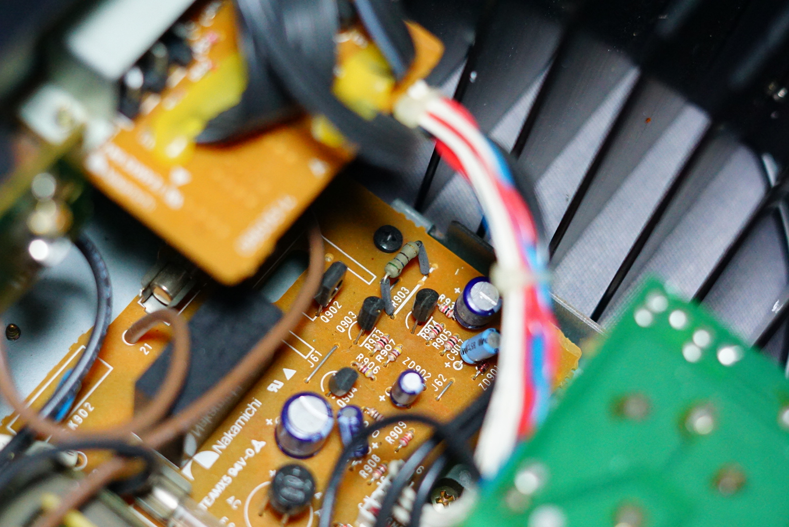

So relay looks like this. I did connection test using multimeter connection test "beep" option.
Last 2 vertical dots is DC feed To actuate.
First 2 vertical dots are speakers B I guess. These two are connected when b or a+b are selected.
The middle vertical pair is speaker A I think. It's always on. As soon as u hit power relay connects speakers A. And when u turn off the amp connection is still there for 2-3 seconds or till capacitors discharge.
Speakers b pins actually wait till relay in power supply section clicks.. and then u get a connection between speaker B pins.
Just quick picks of speaker relay with screw driver showing the pins.
