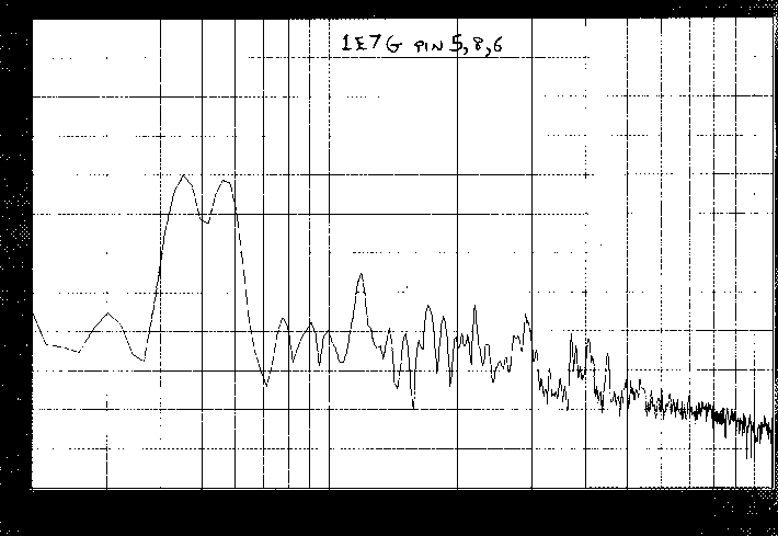

1E7G side two

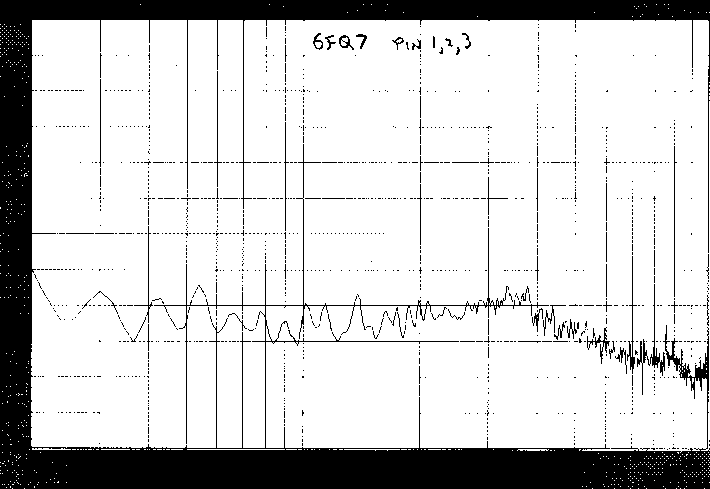

Seeing as the DHTs are 100s of times more sensitive to microphonics than indirectly heated tubes (40+ dB), it will be interesting to see if the more microphonic tubes have better DHT sound or not.
When I get my Hammond 124B xfmr, I will test the different tubes for sound "quality". Then I am thinking that if there is a correlation with the microphony, then I could try one of the lesser microphonic ones and tumble it in a rubber lined rock tumbler bucket for a few days to loosen up the mica supports. Then check the sound. Maybe I can even "manufacture" the magic gong tubes that way. (I should make a .wav recording of that tube, its an incredible sounding bong yeonnng wonnng onnng ....) 😀
The strong 588 Hz resonance on the 1J6G tube I initially measured had a very narrow resonance frequency (only about 10 Hz wide for exiting it from the computer sound card generator) and a very high Q. It would ring for several seconds after I removed the stimulus.
Don
Thanks Don,
Great work! What happens if one parallells the the two halves of a tube like 3A5? Are the resonances adding up to one giant peak or do they in some way compensate each other? The latter is just wishful thinking:clown:!
One option I will try with this little tube is to run it in parallell as shown in a previous post and also pot it in silicone rubber to see what happens. It is not running very hot with heaters ca 1,5V/230mA and triodes 90V/2*4mA so I reckon it will stand

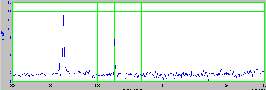

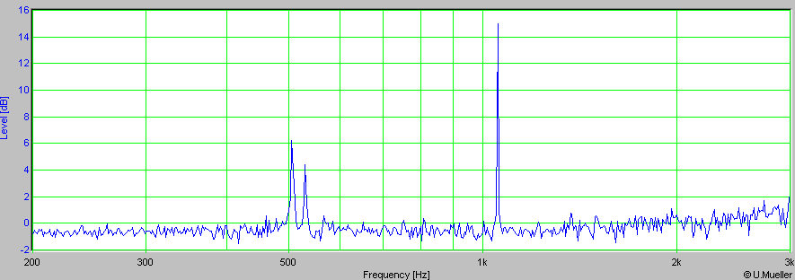

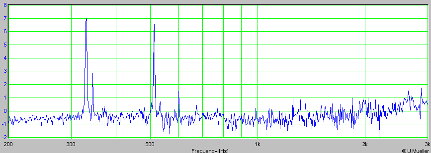

Here is a scan of the type 19 tube with both sides in parallel. This was done using a swept function generator on the PC driving a speaker next to the tube and a tracking level plot of the tube output signal (no input on the grids)
and here is a scan of just one triode section of the 19 tube.
Oh, I forgot to reduce the plate CCS current down from running both sections, so this is still at 4 mA. The resonances have bigger peaks now, but I think this is mainly due to the other (non resonating at the same freq.) plate not shunting it out as in the dual paralleled scan.
and the other half of the 19: (still at 4 mA)
Its odd that the dual plot does not seem to be quite the sum of the two (although plate to plate shunting would be expected to swamp the non-aligned resonances some). Since both tube sections were connected in parallel for the dual plot, it could be that the equal grid biasing was more optimal for one section, so that side dominated the response.
For the case with the tube sections split between P-P sides, as originally posted, I would expect both sections to contribute equally.
Don

Well, I'm no expert on acoustics or damping. But the earlier plots above were from tapping the tube and measuring internal resonances, while the later plots were from conducted external feedthru airborne from a speaker.
The speaker/airborne responses appear to lack the higher freq. peaks seen in the self resonance plots. So maybe the glass tube inertia shields HF thru air already. The rubber ring dampers around the tube would mainly be stopping HF.
When I had the amplifier/speaker connected to the tube output earlier, I could hear the fan running in the computer when I set the tube down on the table. Made a good microphone. So looks like conducted noise thru the chassis is the major threat to me. Humming power transformers on the chassis would be a big concern I would think.
Some sort of pliant socket suspension would seem essential.
It still needs to be tested whether a headphone (instead of a speaker) affects the sound of the DHT or not. If it does, then maybe sound damping will just kill the magic DHT effect too.
It could be that the DHT tube acts as a microphone, and by picking up a delayed acoustic signal, it provides a reverberation like affect. If so, then one might be able to emulate DHT sound by connecting an attenuated microphone to an amplifier input (so summing with the input signal). Or maybe use a spring reverberation unit pickup, without sound shielding, for an acoustic pickup.
