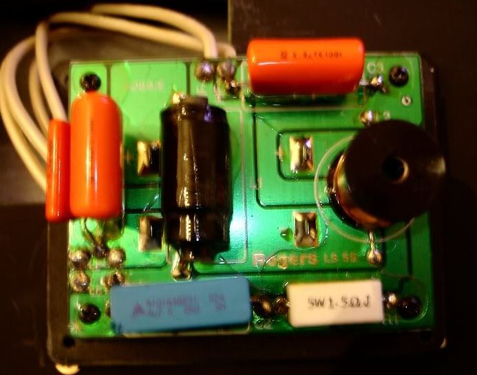

Ah, yes. Cheap ALCAP blue non-polars fitted on what looks like 2nd order filters! They could be replaced for sure, especially since this is an 15-y-o speaker.
The photo shows a Rogers LS55 crossover after polyesters are fitted, though I'd prefer the polyproylenes. Can't be very big values. Probably around 4uF.

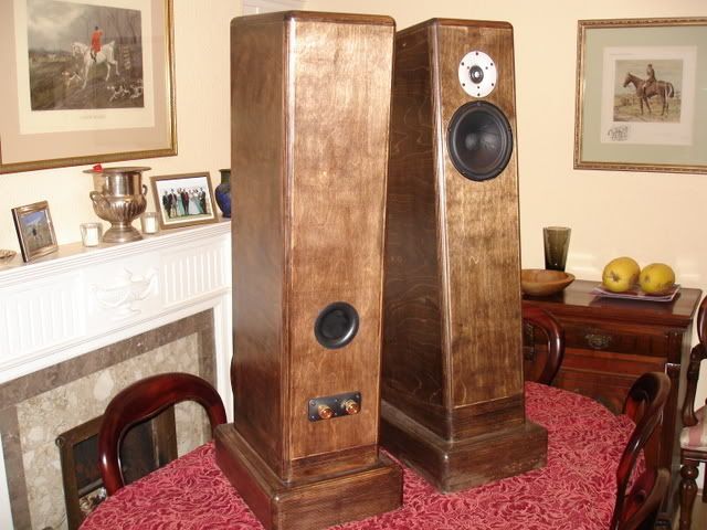

Why don't you build some lovely new wooden cabinets for them? Well braced, and to the same dimensions as existing. Possibly upgrade the capacitors as well. You obviously like the sound of these, so these suggestions would only improve them (not change the character). This may be difficult if you don't have access to reasonable woodworking gear. DIY cabs can be beautiful. This was my first effort:
