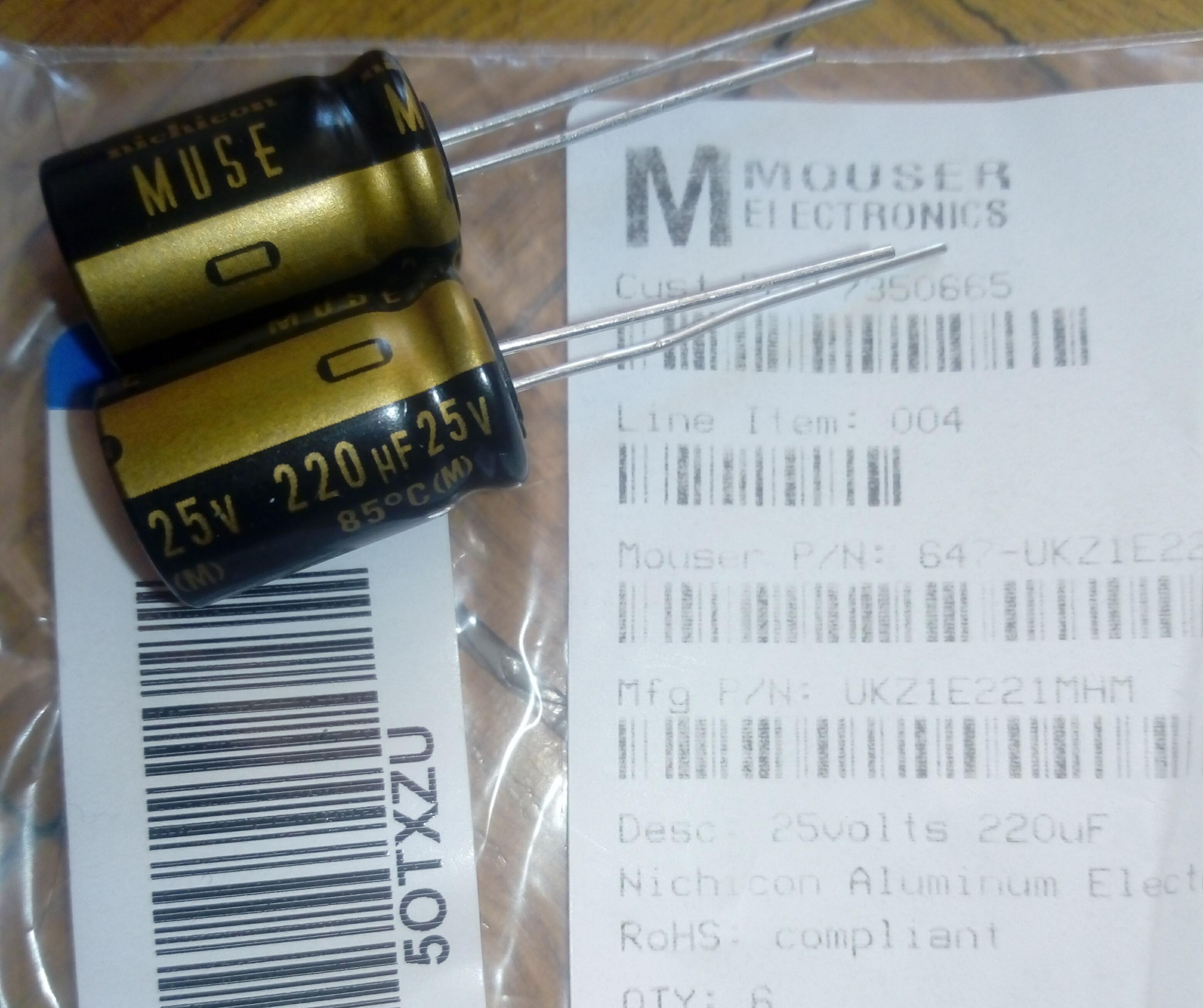

Johnmath, after fiddling with the trimpot i left it just as it was before just in case! Won't do it again 😱. The preamp sounds good without the input loading ceramics but I will change them in case they're needed at some point... About the film caps I was also thinking about getting red Wimas or similar and see what happens
About the non polar caps, I actually have a couple of unused BIpolar Nichicons KZ Muse 220uf 25v lying around... is it ok to use 'em then? Isn't there a reason why they used non-polars in the first place...?
Edit: I've just realised the unit on this web pic I'm attachin comes with bipolar caps 😕
Polarised caps are cheaper and smaller. Some people think that a bipolar, being more or less two back to back polar caps, will have a greater deleterious effect on sound, but actually the opposite is true; bipolars have lower distortion. I guess the non-linear behaviours of the two sections back to back cancel out.
A polar cap needs a polarising charge, so will slowly degrade if there is no DC bias across it. Some designers ensure the rails come up unequally at turn-on so that the coupling caps get a pulse of bias to maintain the capacitor's performance over time; I suspect many more designer are oblivious to the issue.
Thanks for the explanation,
I've just noticed I confused things, when I said bipolar I meant polarised, the Nichicon Muse caps I have lying around are polarised.
All the photos of units i've seen online come with polarised caps... it seems mine is the odd one with non-polar caps
