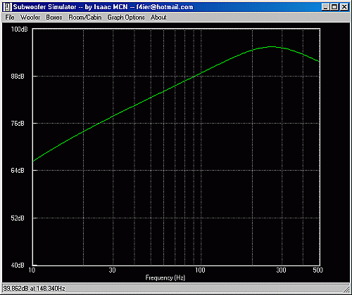

Here is a Peerless 850146 with no modifications. It is in a 56 liter box, sealed. The BL, (or Tm) is 10.0. Note the curve.
This simulation program is Subwoofer Simulator by our own F4ier. Unfortunately,this version of the program does not allow several size boxes of the same type to be modelled all at once, (or at least I don't know how to do it). But boy, this gives you all the curves, (impedance, impedance phase, cone excursion, port output, etc) that you can want, if you choose to select them.
http://www.geocities.com/f4ier/speaker.htm
The high frequency rolloff on this simulation assumes that inductance alone accounts for mid frquency behavior. As such, it is somewhat inaccurate. But you can ignore the mid frequency rolloff for our purposes.

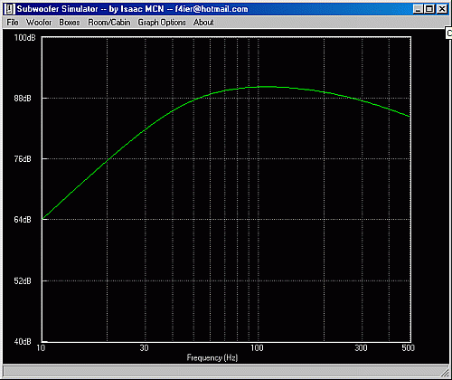

Now here is the same speaker in the same 56 liter sealed box. Only this time, the BL, (Tm) rating is twice as high. From 10 to 20.
Note the midband sensitivity is increased, but the rolloff is quicker.
That is another way of saying that Qes, (and thereby Qts) is lowered dramatically.
