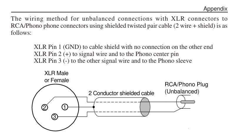

Hi... Thought I'd ask first. My Lynx PCIe card outputs a stereo balanced signal of +20 dbu (pretty hot). I want to run this to a Topping headphone amp with RCA inputs. I bought these adapter cables from Amazon and I included its wiring diagram (see pics)
Is it safe to connect this or do I risk damaging something?

There are several types of balanced outputs. Some do not work well with Pin 3 grounded, others are ok with it, and still others require Pin 3 grounded. What does Lynx say about connecting their card to an unbalanced input?
It should work fine if you just don't connect Pin 3.
Hi... Here's what Lynx sent me. Pin 1 is left floating. It worked perfectly.
The cables I bought were incorrect. I'm glad a waited 3 days to get their input. I could've done some damage!

There's something wrong. IF there is a common ground between the Lynx and the headphone amp, you're shorting Pin 3 to ground that way. I don't know your setup, but that's a possibility, more likely than not. Perhaps Lynx is ok with that short.
Not enough information here. You'll just have to take your chances. Just because it "worked perfectly" doesn't mean it's ok. I would have suggested Pin 2 > RCA center, Pin 1 > RCA outer, leave Pin 3 floating. That's more universally ok.
Well, this is direct from the company. Remember I'm dealing with XLR fully balanced breakout cables (from a Lynx E22 PCIe computer card). It could be their own topology.. not sure?

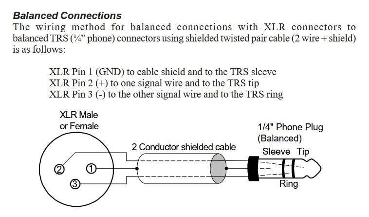

Here's the balanced connection diagram. I'm not sure if it's universal?

The issue is there are several types of balanced outputs, and when interfacing correctly to an unbalanced input it is important to know which output style it is.
There are at least 3 most common balanced output types:
1. Transformer
2. Active differential
3. Cross-coupled active differential
Each connects to an unbalanced input differently.
1. Transformer output - Audio on Pin 2, but requires Pin 1 and 3 to be connected together.
2. Active differential - Audio on Pin 2, requires Pin 3 to float (not connected to anything)
3. Cross-coupled active differential - Audio on Pin 2, Pin 3 can float, but output on Pin 2 will increase 6dB if Pin 3 is tied to Pin 1.
So...which is it? Based on Lynx's reply, probably #3. But it could be #2 if the Lynx and headphone amp don't share the same ground.
See what I mean?
I'm sorry not really. My knowledge is pretty much contained to simple electronic wiring. I did decide however to get a fully balanced headphone amp instead. Not because the connection didn't work, but because I'll have the option of connecting two sets of headphones simultaneously... one for mixing and the other for tracking. I'll be using the second diagram I posted.

If you use #2 above, it will work, and #3 might work. If you're happy with what you have, don't change.
