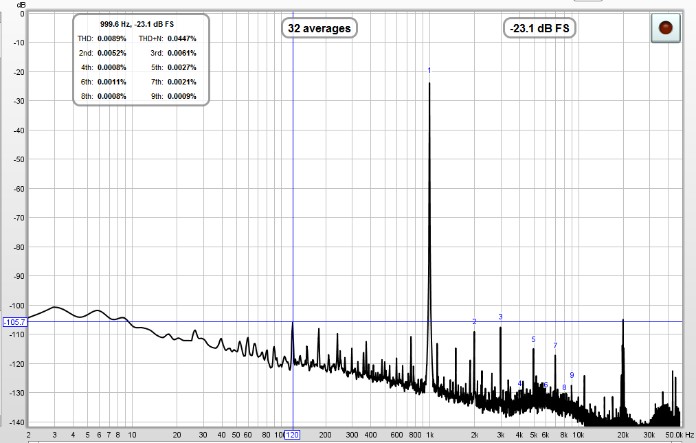

I have attached a 1kHz spectrum for the A64 based NanoPi SBC from FriendlyElec. This was taken with the SBCs output at mac. S/N is worse than 70dB!
But we are talking about i2s output, right? The codec shouldn't matter in that case.
Correct. I think Charlie might be referring to the 3.5 jack?

Yes I was. Sorry about that! Analog output is just pretty bad, but that is not what you are interested in...
